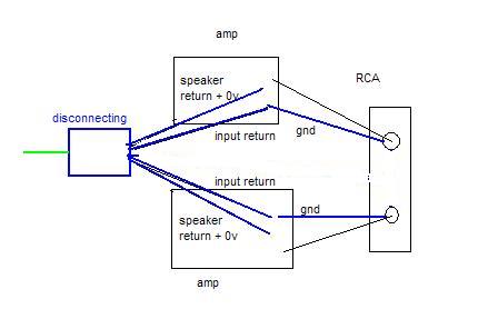

I wonder if my grounding mess might also be the reason why one regulator board was getting so much hotter than the other... hmm... probably not, but time shall tell!
Ok. I have separated the input and speaker return / 0v so both boards are identical again. I also removed the connection joining the RCA grounds at the RCA sockets, so this should be as you asked.
The humming is reduced from when I originally posted, but there's still something there. It's very quiet though, and I can't hear it unless my ears right up against the woofer. It's a sort of buzzing clicking noise actually, rather than a hum.
It now looks like this as another rough diagram...

Further thinking, this could just be the lack of a wire from the PSU boards to the disconnecting network / split up the 0v and speaker return on the amp board? The clicking / buzzing noise might be what people refer to as "charging pulses" perhaps!?
I didn't do this before as I was getting no humming even without those. I will do this, probably tomorrow now, and let you know if it makes the noise completely disappear. I have a feeling it will...
Ok, I cut the 0v and speaker return trace on one amp board and ran a wire to the disconnecting network for 0v. It's even quieter, and I think it's changed it's sound again 🙂 It seems less clicking and more humming.
I think I might rejoin the trace and move the wire to the PSU board to see if that makes any difference...
Move the transformer around to make sure its not magnetic interference, also check where AC cables are running, you want to keep them away from input lines...
Nordic said:Move the transformer around to make sure its not magnetic interference, also check where AC cables are running, you want to keep them away from input lines...
Good call Nordic. It seems even quieter now that I moved the RCA lead (from preamp to GC) away from running over not one but TWO mains power cables
I think I can still detect the very very slightest noise with my ear basically glued to the woofer. It really is so barely audible I dont think it's worth worrying about at all. Heck, it's so quiet I might even be just imagining it...
Seems like it's just a case of getting some shielded cables now, hopefully!
Thanks ever so much to everyone 😀

AndrewT said:I see a ground half ring going from disconnecting network to amp PCB to RCA barrel.
I see a second half ring doing the same to the other RCA barrel.
Now connect ONE source to ONE RCA. There is no ground loop so far.
Connect the second RCA to a second source (L & R in the same unit). I bet there is an common connection between the two RCAs in the source equipment. Now you will likely have a ground loop. Any electromagnetic field will cause a different voltage on the two halves of the loop. That voltage difference is what gets amplified and fed to the speakers.
Can you test the single interconnect and single shorting link to try and isolate the problem?

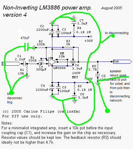

I am using my Cambridge Audio A5 as a pre-amp. I have a hiss coming from the tweeter, which I think comes from it and not the GC. I have just checked this morning and if I turn the pre-amp all the way up I get some barely audible (ear right up close) buzzing / humming coming from the speakers connected to the Cambridge Audio, I can also hear what I think is the same noise, but actually quieter, coming from the GC. For now I might assume that the remaining hum is coming from the pre-amp (if that's possible?), or maybe it is just something to do with my board layout. I tried adding another ground wire, but on the PSU, going to the disconnecting and it didn't make any difference what-so-ever.
I'm not familiar with the boards you have (I made my own), but I have virtually got rid of my humming by separating, on the amp board:
The signal return and feedback ground
Speaker return, chip pin 7 ( I think) ground and mute ground
Power 0v
(see attached diagram / schematic)
So I have three ground wires coming off of the amp board, and I am running them all to the same point at the disconnecting network. I assume that I could have left the power 0v connected to the speaker return and then instead run this wire from the PSU boards and it would have done the same thing, but it was just easier for me to remove the amp boards from the case now, so I did it there instead.
I'm not actually sure if this is actually a 'true' or 'proper' star ground. I don't know if in a true star ground the grounds are supposed to be totally separate from each other, no trace joining them on the PCB? It seems to have worked well for me though.
Given that it's a kit, I imagine you shouldn't really have to do any modifying of the PCB's to remove hum though, so it might be best to wait for someone with experience using the PCB's you have. Maybe even e-mail the people who make the PCB you have and ask about it?
You might also want to check that your signal cables (both internal amp and the interconnect from pre to GC) aren't running near any power supply or mains cabling, especially if they are unshielded like mine. I had my interconnect laying over the mains cable going to the GC and quite close to my pre-amp mains cable. Moving it out of the way of this removed my last bit of audible hum.
you have got it right.
I would tidy up a few ends.
1. move the speaker return straight to your off board central star ground (audio ground).
2. move the audio ground to nearer a central point between PCB and PSU.
3. make a longer connection from disconnecting network to the re-located audio ground.
4. all the transformer pairs and rectifier pairs could be twisted together, as pairs, to minimise the externally radiated electromagnetic field (it's that small loop area thing) and it helps if each pair can be kept short.
You have designed your PCB with separated signal ground and power ground.
Most chipamp board designers don't do that and then the problems start because they cannot keep the dirty decoupling returns from contaminating the signal ground.
Carlos' schematic shows all the grounds with the same symbol and most builders do not recognise that all the grounds should be kept separate until they meet at the audio ground. It would be far better if all designers would show differnt symbols for the different types of ground (clean, dirty, very dirty (PSU) and mains safety earth, that's 4. There is an exception or two.
the decoupling should connect to each other by the shortest possible route and the PCB should be designed to allow this very short ground to ground route, particularly for the tiny high frequency caps that should be almost touching each other to allow proper high frequency bypass action. The common point is then connected to the audio ground.
The other exception is the RCA input ground. The barrel connection can go direct to audio ground or to the PCB signal ground. Whichever is quieter with the sources used is the correct one. An ideal situation for a bolted connection that can be swapped over and a pin to pin shorting plug.

AndrewT said:Hi,
Excellent!
Ok.
I have read about and done this as much as I could 🙂
Ah! I actually designed it so they were all connected in a straight ground line at the bottom of the PCB, so it was really easy to just cut the trace and separate them up if I needed to. Turned out to be a reasonably smart move on my part obviously!
