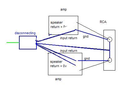

Dunno why you're sorry!
When you say I have two ground connections do you mean the two RCA sockets? Or the two amp boards going to the one place separately?
Quite frankly I am lost again (still having a stupidly hard time getting my head around the star ground thing).
Here's a crude diagram of how I have it grounded if it helps at all...
It's probably all wrong, but it's the best I could understand how to do it 🙁 Try not to cringe too much!
I have no right to cringe, your drawing is better than mine!.
I see a ground half ring going from disconnecting network to amp PCB to RCA barrel.
I see a second half ring doing the same to the other RCA barrel.
Now connect ONE source to ONE RCA. There is no ground loop so far.
Connect the second RCA to a second source (L & R in the same unit). I bet there is an common connection between the two RCAs in the source equipment. Now you will likely have a ground loop. Any electromagnetic field will cause a different voltage on the two halves of the loop. That voltage difference is what gets amplified and fed to the speakers.
Can you test the single interconnect and single shorting link to try and isolate the problem?

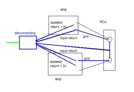

To further complicate matters, it turns out I had cut the trace between the input ground and speaker return / 0v on one amp board, but hadn't cut it on the other one! Whoops!
When I bolted the boards down, on the board with the trace cut there was a bit of excess wire which had actually bent just enough (between the board and metal plate is a lump of wood to stand it off and insulate it) to re-join the two previously split traces. I trimmed it off so it won't join them again, and it's back to quietness again, with both RCA, or just one RCA and one shorted. It's obviously still wrongly done though.
With the traces on both boards joined (i'm not sure if this is the correct way to do it?), having both RCA's = hum. Having just one RCA connected and the other shorted or just disconnected = no hum.
Should I cut the traces connecting the input return to the speaker return / 0v on both boards and try one RCA shorted, the other connected to the source, so it actually REALLY is like the first diagram I drew?
Sorry if that's hard to follow! In diagram form basically I now have this instead...
Thanks for sticking with me on this one!

it's not all sunk in yet but I see three solutions, some or all or none may work.
1. disconnect both RCA barrels from the screens on their respective coax. Connect both RCA barrels together and run a single connection to either the disconnecting network or to a new central ground star (your chipamps may make this central star ground unworkable).
2. disconnect the ground link from ONE amp PCB to the disconnecting network. Create a second disconnecting network and use this to link safety earth to the unconnected amp PCB.
3. modify the source to separate the commoned RCA barrels (least likely since all your sources probably mimic this type of grounding).
Just noticed three loops! Your have RCA barrels connected to disconnecting network AND to amp PCBs. Do the amp PCBs have the input ground connected to the power ground?
Should I remove the connection from the RCA barrels to the disconnecting network and just have them run, separately, to the amp PCBs?
Well, right now on one board yes and on the other no (this was what all my incomprehensible ramble about splitting traces was about), and at this very moment it's hum free, but it seems wrong / a bit of a bodge. It's an accident that one board has the input connected to the power. Should I separate them on the other board aswell and see what happens?
Let me see if i understand you:
Are your RCA-gnds connected 'through' the pcb to the disconnecting-network ?
Yeah they are, aswell as joined at the barrels / sockets and a wire run from there straight to the disconnecting network. The feedback ground (after 100R + 470uF cap) is connected to the input ground (probably not the best of ideas?), so that goes to the disconnecting network via the same wire, if that makes any sense?
Edit: now i sound like a parrot, Andrew

AndrewT said:Hi,
the RCAs need ONE connection to ground.
Ok. Just to make sure: I should split the trace on the other board, thus separating the input return from the speaker / power return and then just totally remove the connection which is connecting the two RCA grounds at the RCA sockets?
we're all too impatient to get a solution.
Keep ONE connection from each RCA barrel to ground.
Keep ONE connection from each PCB signal input to ground.
Keep the NFB connected to the PCB signal input ground.
AndrewT said:Hi,
Ok, thanks very much Andrew!
Unfortunately I will have to get back to you a little later on to tell you if this gets rid of the hum (though I am sure it will, you seem to know your stuff!). My brother is playing his music at the minute, so it's quite hard to listen out for such a quiet humming 🙂
