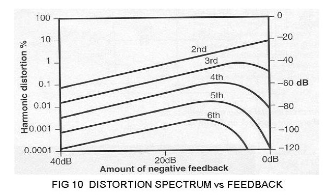

Hello mr. Pass
Again about your document: Audio, distortion and feedback.
There is this graphic, I include an image of it.
In this graphic and theoretically the best sound are at both end of it, so; an amp with no feedback or with 40 db feedback will have a very low distortions in the higher thd harmonics, and so a better sound.
After tests and listening tests on various amps circuits, I found out that if I use a high level of global negative feedback the amp sound much less good than if I use a low level of global negative feedback.
From your experiences and knowledges, do you have any explanations of why, even if according to the graph, a 40 db feedback will give very low distortions in the higher thd harmonics, in reality it sound much less good than if I use a low level of global negative feedback ?
Thank
Bye
Gaetan

a low feedback amp with largish low order distortion does have substantial IMD – IMD products are a consequence of multiple frequency signal mixing in a nonlinearity
lower order nonlinearities do produce fewer IMD product frequencies for the same input but they still produce IMD
the article's implication is by Nelson's own admission "exaggerated" for effect - real high gain feedback circuits early stages contribute very little distortion as a consequence of the high loop gain - the signals in the input stages are very small because of the high gain, so the stages are operating "deep Class A" using a small portion of their load curve which generates low levels of low order distortion
this is “in addition” to the feedback distortion reduction – which is larger with higher loop gain
I would still recommend "stealing" every one of Nelson's low distortion device selection, bias tricks to make the stages of a high feedback amp as linear as possible open loop
but well implemented high feedback audio amplifier circuits are not displeasing to the ear because of something they add to the audio signal like the hypothesized 7th order distortion or complex IMD products - it is perfectly feasible to design high feedback audio amplifiers with all measurable audio frequency distortions below the noise floor, with complex multitone signals, "complex" speaker loads, measuring THD, IMD, TIM, PIM...
this is the 2nd decade of the 21st century, medical ultrasound, telcom A/DSL demands have greatly upped the performance of op amps, ADC/DACs, improved circuit design, widely diffused the knowledge to analog design EEs – it is only “Audiophile” designers that get away with strawman arguments about 1970's amplifiers and the “evils” of feedback, ignoring broad advances in technology and nonlinear control theory in particular

you can build circuits with open loop distortion below the starting 10% 2nd order nolinearity in the graph
you can add 20-40 dB more loop gain in many audio amp circuits for 60-80 dB loop gain at all audio frequencies - at which point the harmonics above the 3rd are below -120 dB - ie in the noise - assuming you start with 10 % open loop distortion
Cherry shows the same math in his JAES paper with more insight into distortion contributions by individual devices in a audio amp
