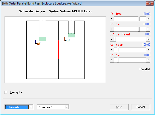

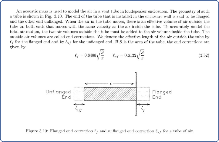

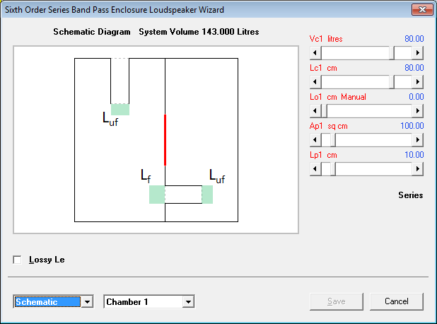

The end correction lengths are a function of the port area and whether that end of the port is in free air or flush with a box wall. Formulas can be found in most acoustic texts. I have attached an excerpt from Leach. Attached also are pictures of Hornresp Sixth order bandpass enclosures(both Parallel and Series) showing where the end corrections are being applied by Hornresp during calculation. Note that there is no length correction applied to the end of the ports that radiate sound. This is because Hornresp uses a more complex radiation impedance model as the external airload on the ports which includes the effect of air moving as a mass near the port opening that the end correction factors are trying to approximate.
