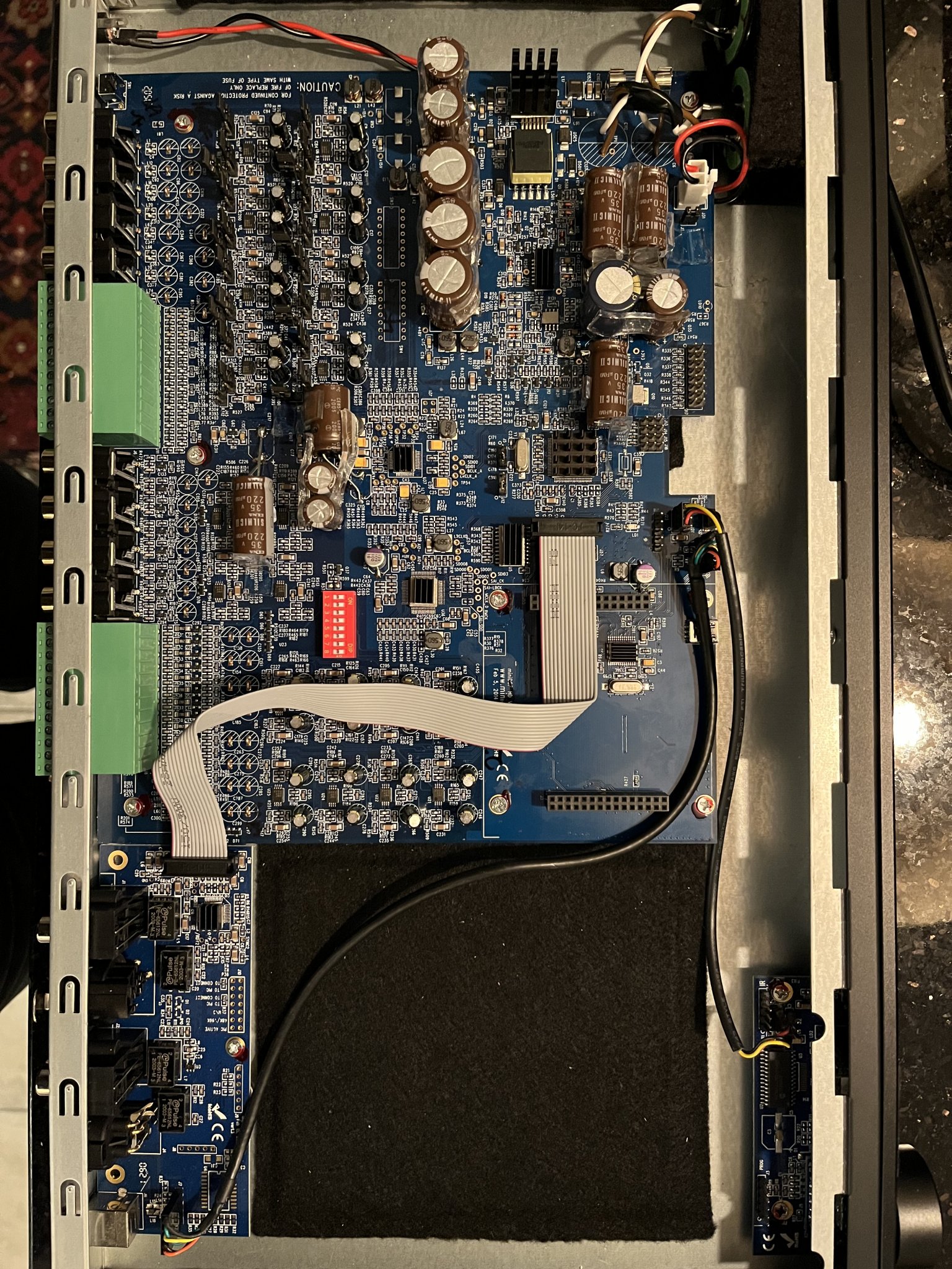

A question on Cap replacement mini DSP
Hi I am upgrading the caps in my mini DSP and wanted to confirm the positive is in the normal configuration, the centre has a + in the middle and I believe the cap removed was Polar given its markings. Also thinking of using a 35V cap, wasn't sure what value this cap is 1000Uf and looked like it might be 10V. Its fed with a 12V supply and has maximum of 15V internally, so thought adding a 35v was a safe option ?

I recommend using panasonic FM instead of larger silmics :
these caps are likely output filters for switching supplies, so high peak ripple and stable ESR at ultrasonic frequencies is critical here.
adding silmics horizontally with extended lead wires increases the series inductance feeding those caps -- could lead to more switching noise, regulator instability.
also recommend purchasing some standard series SMT caps as well, in the event the ultra-low ESR of the FM series creates switching regulator instability and you need to swap them out to get it running again. Most switching regulators are designed for output caps within a specific ESR range, too low or too high can get you into trouble.
Pay attention to tincanear.
What are you attempting to achieve by these changes? What circuit and what function? Caps have a lot of different parameters, not just value and voltage.
To some other comments, a cap that gets hot enough to need a heat sink has something terribly wrong with the design.

"Squeeze in a Panasonic". Panasonic makes dozens of electrolytic caps. They are a reputable company. Pick the correct series. There is no "this one is better than that one". Application matters.

Ive experimented a lot with pre amps and CD players over the years and have found changing caps in both Ps and signal can make big difference sonically, not always better. But for a few £s worth a try. The miniDSP is only used to control subs and I wanted to ensure the performance is as good as possible.
I buy caps from HiFi Collective and Farnell
The AC coupling caps in my Bluray player had a significant impact on the sound. I settled on Silmic II there (All 470uf)
AC coupling caps are often too small. 470 sounds a bit big, but not much cost difference.
What parameter does the Silmic cap have that others they make ( reputable company) that make it "audio? Is it their $1 cap sold for $2 because marketing said the "audio" label makes it more valuable? Lower inductance? Lower ESR? DF, TC? What is it in series with? A 1.2K resister and ESR is important? I am not claiming no difference. A place where there likely is, but why? Why that value. Why that series? Is a 10u electro better than a .5u film? What did it replace, a Z5U?
Power supply caps are often too small. Cost constraint. But just swapping caps may lead to other issues, like improper rectifier ratings due to inrush. Easy to calculate. You can monitor ripple. You can monitor for rail collapse. Though a CD player will have regulated supplies and a pretty steady state draw, so I doubt much improvement in actuality. Now, going to the boards, close to the components that draw power, improving bypass caps can make a measurable difference. Not only choice of cap, but isolation of parasitics in the power and ground layout.

I know Silmics sound better when comparing to stock, Nichicon FG and Silmics, they do have a different dielectric - silk and have copper leads not steel. All I know is they are physically large for the rating and sound better when I have changed the coupling caps
