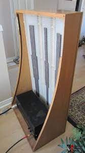

I believe there is a whole tread on this. I had a pair of the big 3-panel powered jobbies in my living space for awhile. They needed work. I believe they used transmitter tubes as you ar edealing with something like 5000 volts.

These the ones? I’m sure I remember running into a pair back in the day, maybe that was at the mountain, before the stacked model 2s

The original vacuum tube in Acoustat's Servocharge amplifier is 6HB5. During its years of production, I believe that was the only tube used by Acoustat. There may be others that work - I can't advise on that.
The original Model X was available ONLY with the Servocharge amplifer. Models Monitor 3 and Monitor 4 were available with either the Servocharge amplifier, or the original MK-121 (aka MK-121-1, or MK-121-1A) transformer interface. Note the original MK-121 and the Servocharge amplifier have the same mounting requirements, making the use of either method convenient. After the Monitor series, all speakers were available with transformer interfaces ONLY.
