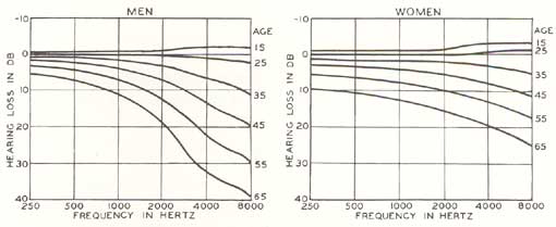

I doubt if you are middle aged and male you can do any better.
You are probably -20dB at 8khz, which means compared with a teenager you are deaf.

It suits anyone over 45, because they can't hear the artefacts anyway as shown above, in the hearing loss graphs.
As you see, women have much better hearing than men, especially as they age.
