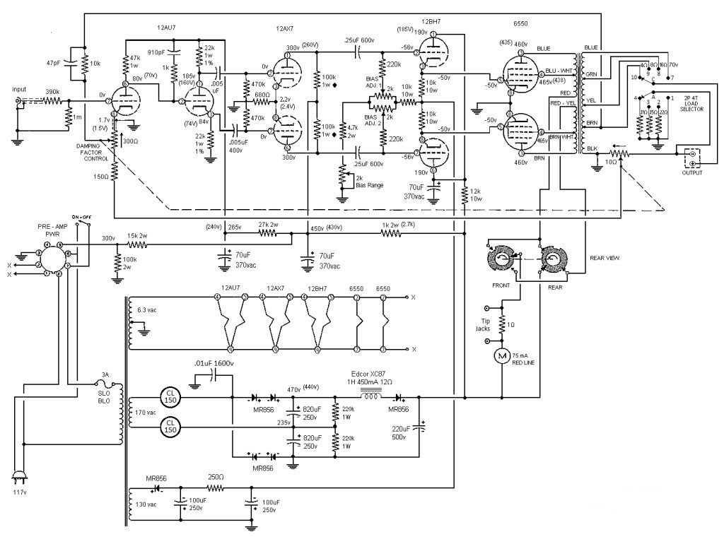

I believe this question is one of amplifier design, but I am not sure.
Let us say that I am listening to the same tracks of music on two different amplifiers of nearly equal power ratings.
Amp 1: presentation is "normal", volume level is easy to set to a comfortable level and instruments are pretty equally matched in volume levels. There is not a marked difference between quiet and loud passages.
Amp 2: volume level for same track seems more difficult to achieve comfortable listening level, seems too soft. But then when there is a passage with wide dynamics this amplifier surprises me with how suddenly loud it is. It is dramatic.
The same sort of thing applies to the separate instrument levels. Where with Amp 1 a guitar and percussion are pretty equally matched in volume, listening to the same track with Amp 2 the guitar and percussion are not at the same level. The guitar is much louder and the percussion is much quieter.
In other words, Amp 2 seems to have much greater dynamics.
How can this be?

Yes, different amp designs do in fact have different dynamics.
There's a lot of different things that go into this, but just to give my opinion (based on my own builds and design experiments) on the first things that come to mind:
1) The most noticeable dynamic effect, where the complete volume of the signal is compressed, most often is caused by high impedance PSUs. Switch to SS diodes, and regulate the B+, and you get a whole lot of dynamics in the overall volume of the output.
2) The inner dynamics, which are harder to describe accurately, can be improved with reducing distortion. The reason why some things sound louder (and it's not really that they're louder per se, they're more perceptible, more to the front) is that the harmonics that the amp produces (adds to signal, distortion), benefit some instruments more than others.
Best example: SE has a lot of 2H; this brings out voices, especially female voices, to a great degree.
Reduce distortion, and you bring the original balance back; this is fidelity (in best cases, high fidelity).
3) The third dynamics effect is closely related to the two described above, but still I feel separate. Even in amps that have low impedance PSUs, and very low distortion, you can still have one amp be 'slow', and one amp be 'fast'.
I found this when I started driving all output stages with CCS loaded source followers. It makes any amp 'faster', and some amps it makes a LOT faster. The sound has 'impact', and even at same sound pressure level, it's "more powerful". Reasons for this have been talked about on this forum.

No Cap between drivers and output stage.
Direct coupling between the driver stages and output put stage, Push pull & SE amps have excellent dynamics. Class A2 SE and class AB2PP. You can use Cathode followers or Mosfets. Of course you still need a good power supply, not necessary regulated.

On my first amplifier design I used a b+/b- of +30 and -30 volts.
I found it clipped very easily before I got any decent volume out of it.
I quickly learned about transient response.
Some peaks can be massive in music.
I now use much higher B+ lines in my amplifiers.

Agree with what has been said so far. From my own experience I would add the quality of resistors in the signal path- ones with low temperature coefficient (metal film, metal foil) sound more dynamic. The old carbon-stick resistors would change their value slightly with signal level and work to compress dynamics.
