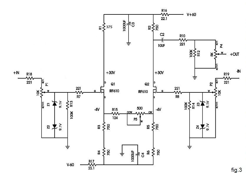

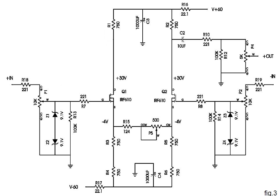

A question about the balanced bride of zen (bosoz)
Hello
About the balanced bride of zen (bosoz).
I need a unbalanced output.
I did modified the original schematic, do I've done it right ?
Thank
Bye
Gaetan
The BOSOZ is a wonderful balanced to unbalanced converter, and also a unbalanced to balanced converter, and can also do unbalanced to unbalanced. Leave the circuit as originally designed, and short the unused input and or output to ground.
