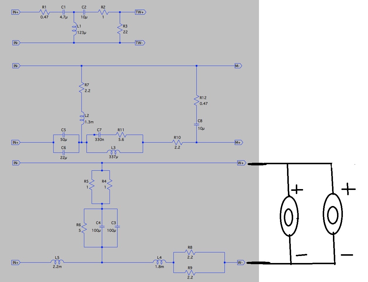

I own a pair of Sonus Faber Grand Piano Domus speakers and have a question: knowing that the two bass woofers in each speaker work in parallel, does the crossover send exactly the same frequency range for the two woofers or they work with different frequency ranges?
In the second case, what's the frequency range sent to the first/up woofer?

If the parallel connection is "clean", (there is no inductor or capacitor in any of them, see the attached diagram) they work at the same frequency. It applies round or elliptical coil speakers, I couldn't do it better.....
Yes, according to the thread below, the woofers of your Sonus speakers are in parallel, covering the same frequency range.
https://www.diyaudio.com/community/threads/sonus-faber-grand-piano-domus.285171/page-4
See post #67 and onwards.
