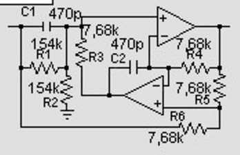

I did look at non-oversampling TDA1541A but it really need a sharp analog filtering at the output or there is lot of intermodulation from the 44.1khz and so doing noise down to audio frequencies.
Agree. You'd need a very linear I/V stage and even then the Nyquist violations are not pretty.
Hello

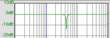

Maby a NOS dac with a 22khz low pass filter followed by a 44.1khz notch filter ?
I've put an image of the 44.1khz notch filter circuit alone with the frequency response graph.
