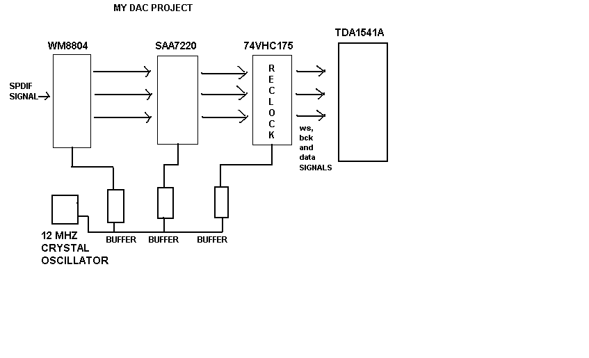

Hello
I'm not at my best with the english language, so I may have not explained correctly what I was want to do.
Here is it: it would be stand-alone dac, what I was asking is if the SAA7220 and the 74VHC175 would work ok with the 12mhz crystal oscillator ?
Like in the drawing I done and I include.
Only the 74VHC175 would do the reclock job, the SAA7220 are a bit noisy so the 74VHC175 would reclock the SAA7220 signals before going in the TDA1541A.

SAA7220 needs 11.2896MHz clock. The 8804 needs a 12MHz in hardware mode - I guess because of internal dividers.
In software mode you can use a 24MHz or a 27MHz xstall clock and get the 11.2896MHz MCLK needed for the 7220.
I doubt that 74VHC175 will "clean" or "reclock" the jitter comming from 7220. Jitter will just propagate through as such.
Most of the people use DIR9001 because doesn't require an external clock.

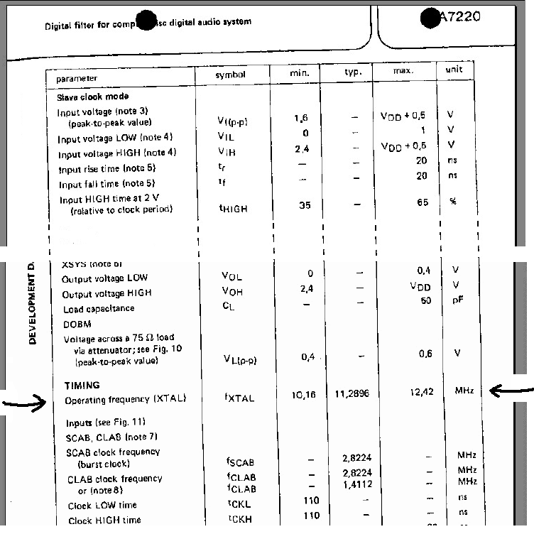

Hello
Looking at the data sheet, as you can see in my new image, I was under the impression that the SAA7220 could use a 12MHz crystal oscillator.
If a reclock with the 74VHC175 will not "clean" or "reclock" the jitter comming from the SAA7220, what can clean that jitter ?
You are correct, it can use 12MHz. But its the clock master (256fs) in the system - what audio do you have to play out at 46.875kHz?
Of course the 74VHC175 will help clean up the jitter. But jitter may well not be the only problem as regards sound quality from the 7220. There could be a high level of common-mode RF too, induced on to the power supply. The 7220 is rather a noisy chip and draws almost 1W of power.
Hello
Well, it seem that the SAA7220 really need a 11.2896MHz clock.
To clean the rf noise coming from it, I would do a separated and filtered power supply for the SAA7220.
I will have two stand-alone DAC using WM8804, SAA7220 and TDA1541A. One for a CD player and one for a DVD player, and since one of those dacs will receives a 48KHz sample rate input signal from a DVD player, the WM8804 MCLK pin may not give a 11.2896MHz clock for the SAA7220 and the 74VHC175.
Maby I should go back to the first ideas of using one 12MHz crystal for the WM8804 and one 11.2896MHz crystal oscillator for the SAA7220 and the 74VHC175.
If the reclock of the SAA7220 output do clean up the jitter just a bit, maby it more simple to not use a reclock.
