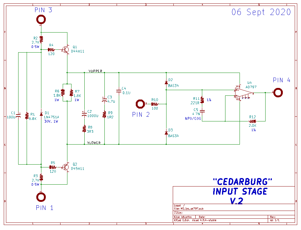

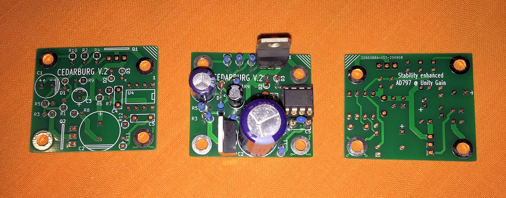

Operate "high bandwidth, suspicious phase margin" IC opamps at a gain greater than 1. Presto, MUCH better gain margin, MUCH better phase margin, MUCH better overshoot/undershoot. Nelson Pass has been recommending this for more than a decade.
Here's one way to skin the cat, applied to the notorious AD797 whose datasheet says it is stable at a noise gain of 2x (but NOT at unity gain).
