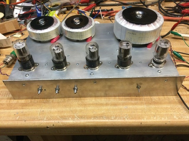

I will be watching this with great interest, making something out of cheap and used parts is a favorite pastime of mine. Hope all goes well with the surgery, I’m unlikely to get my amp done any sooner than you. Being a professional musician tends to keep one busy
It’s got to WORK. It’s designed for 1600 volts RMS to be impressed on the “primary”, and you’ll be running about half that. It should have enough inductance to work down to 25 Hz. The only question is how high does it go? With the high turns per volt, it may roll off sooner than one of their little ones running with only 240 volts RMS across their “primary”. But when their 50 VA units are used that way they sound fantastic. This is a nice little zero feedback PP class A I made. No measurements yet but pleasant to listen to. As long as there is some method of ensuring equal bias in the two sides for DC balance. With the TV sweeps I’d for sure be using fixed individual bias and set them carefully by hand. Experiments I’ve done even running a push pull pair open loop pentode getting the full 50 watts kept it in balance enough if it was balanced at quiescent.
Ive already bought a pair each of the 8T800 and 15T950. That expense is over for me. Just waiting on deck like George’s drool-over Plitron OPTs.
