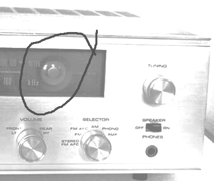

is there a signal strength meter / tuning indicator on the receiver? Does it change when you turn the tuning knob up/down?
Hello
It's a green glowing tube signal strength meter / tuning indicator.
And nothing move when I turn the tuning knob up/down.

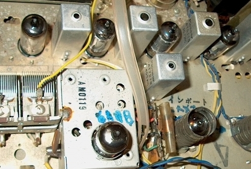

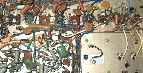

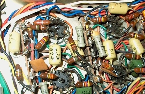

That metal case should have that VC301 inside: that variable capacitor to the left from it on the 1'st picture is for AM band. If the 1'st FM IF stage amplifies the signal well, something is wrong between it and that "soldered metal case". Please try to remove V301 tube to check if loudness of white noise changes without it. This thingy is FM preselector, radio frequency amplifier, heterodyne oscillator and mixer. The left part of the tube is RF amp stage, the right part is both oscillator and mixer. When you tune on different stations heterodyne tunes 10.7 MHz apart from selected station, so after the mixer you have always 10.7 MHz no matter which station you tune on. It is IF, Intermediate Frequency, so IF amplifier always amplifies and filters on the single IF. It is working: you tested it by screwdriver.
Hello
I have take out V301, and the loudness of white noise seem a bit higher.
Since you did said that VC301 are inside the metal box, I've take out the V301 tube, and I can see now VC301.
The rotors of the variable capacitor VC301 are moving wen I rotate the FM tuning knob, so the rotor shaft of VC301 are not broken.
Thank you
Bye
Gaetan
