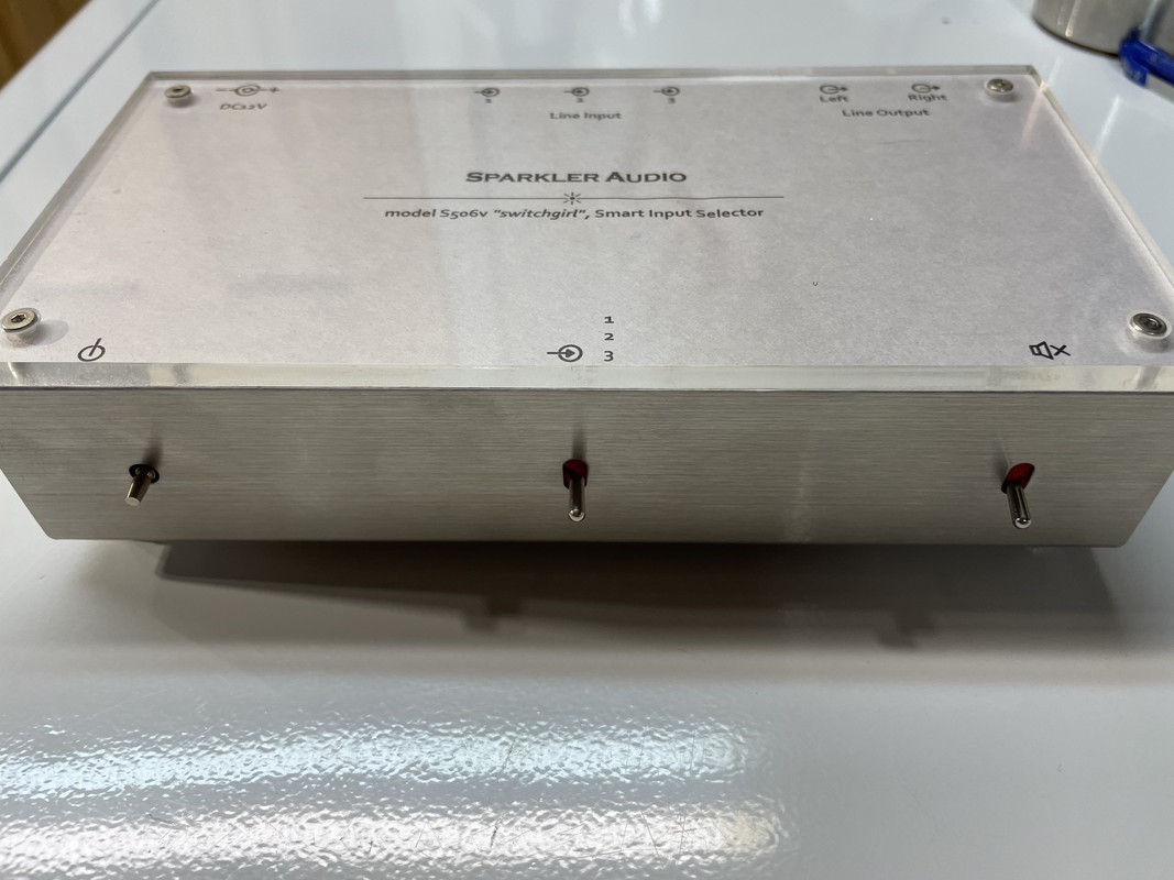

A Sparkler Audio model S506 “switchgirl” ― Input Selector will do the job... $275 ..

Also agree jean-paul. IF the 8600 were like the 8200 in that regard it would be perfect. I also use the sparkler audio switchgirl before the TU8600 to switch between my phono and DAC, although I would have much preferred the input select to be built into the TU8600 itself, particularly as the switchgirl is a powered device that requires another AC plug. I've heard that beresford and luxman have decent and transparent passive switch boxes that do not require external power. I haven't been game enough to mod the TU8600 PCB and case to add a second input and switch.

I also use the Sparkler switch. Solves the problem elegantly. You can get one through Victor at vkmusic.ca.
