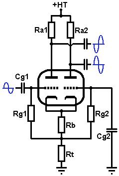

A PP power stage with no phase inversion stage?
Yes, line stage and amps are separate. The line stage has transformer output and it is floating. By connecting to input transformer secondary on the amp the center tap of that secondary becomes the ground reference. The input transformer in my application is wired 1:1. Both line stage and mono blocks are zero feedback designs.
