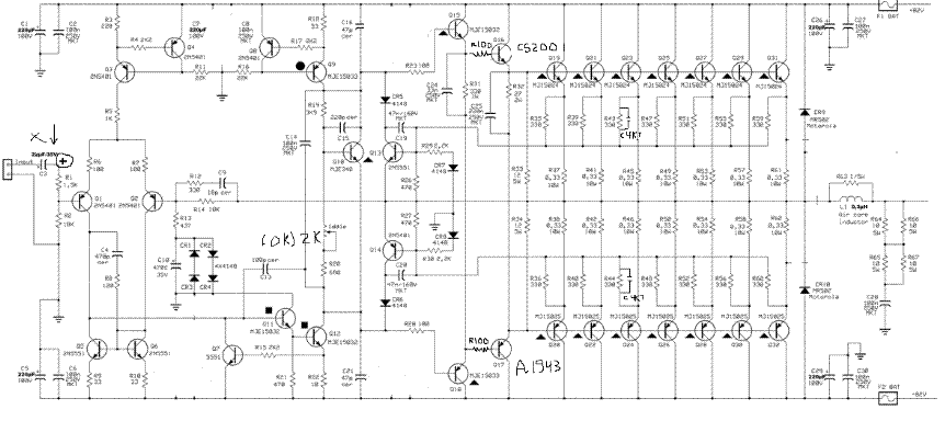

In the schematic that i posted, included the basic protections which used as well in many Hi-Fi power amplifiers. These are the clamping diodes in output, the zobel network and the output inductor and the VI limitter. For a high power amplifier for PA use, these protections are not enough. An extra protection circuit it is indispensable. This circuit, in modern PA amplifiers, does not includes only the standard DC and thermal protection of the past years. It is a quite sophisticated computer, which computes each moment the state in the output of amplifier and compares the input - output signal. If detects an abuse, then reacts by activating either an input limitter or deactivating the output relay.
Many well known brands have passed from my workbench for service. I had the luck to study a lot of different versions of protection computers. Each constructor uses its own scheme. After the long time of the study of these circuits, and when i had understand: "why is monitored this point?" and: "how reacts this device when is activated?" then i proceeded in the design of a circuit of mine invention. These circuits does not have any relation with audio schemes, these are servo-controllers and have relation with automation circuits. Because i had enough expertise in such type electronics, the design of a new was a relativelly easy work to me.

thank you for good amp .lm disign it like this and about 1 year its work so fine.its have,nt distortion:bigeyes: so so fine

@ zakzak: Your improvements and modifications on the current circuit are very good. Indeed, the lot of decoupling capacitors on the supply rails it is unnecessary. Your modification it is right. Congratulations for your success, because this project it is very difficult. 2SA1943 - 2SC5200 looks very good in output stage.

By some way, wahab remark it is right. There is of course, a significant difference between MJL21193-94 and MJE15024-25. You may see at the datasheet of these devices. The SOA curve of MJL21193-94 shows e.g. for Vce=80V a maximum Ic=2.5A instead this of MJ15024-25 shows for the same Vce=80V a maximum Ic=3.5A. In MJL21193-94 datasheet as well, you can see at the preliminary text the note: High SOA:2.25A, 80V, 1 Second. Instead in datasheet of MJ15024-25 is referred: High Safe Operating Area (100% Tested) - 2A @ 80V. This indicates that MJ15024-25 are more strong than MJL21193-94. And this is reasonable not only because the TO-3 metal case which is used in MJ15024-25, but as well the difference in fabrication between these devices. Each designer has its own philosophy. PA amplifiers suffers heavy abuse during operation. Using MJL21193-94 in output you have to visit the service, say, each 1 year for replacing destroyed output transistors. Using MJ15024-25 in output, the time of possible service is extended, say, at 5 years at least. So the choice is yours. If you wish to use MJLs in output, the only that i have to suggest you it is to add another one pair in the output. The issue it is to keep the Ic per each device lower than 1,5A (regardless of the load connected in output). Can you make some calculations? For 92V supply, the MJ15024-25 SOA shows a max Ic=1,3A approximately. For a load of 4 ohms, that means Ic = 92Vp/4Ohms = 23Ap which is theoretical only. Because 92Vp^2/4Ohms = 2116Wp = 1496Wrms. In practice, a power transformer of 1,5KW/2 X 92V under such load will drop down its output voltage at 80V approximately (i talk for low frequencies, bellow 150 Hz) and thus you will have Ic = 80Vp/4Ohms = 20Ap/device. To keep the Ic = 1,5Ap we need 20/1,5 = 13 transistors per rail, or 26 transistors total. That is unrealistic! For this reason we use the VI limiter circuit, which restricts instantly (during heavy loading of output transistors from music bass frequencies) the drive signal of output transistors, allowing thus the use of 9 to 10 pairs as much (i talk for MJ15024-25, for MJL you have to add two pairs more to feel safe).
As for MJL3281/1302 instead are far better in audio performance than MJ15024-25 and MJL21193-94, but their SOA indicates a Ic = 1,2A approx. at 80V. In the preliminary of their datasheet, it is referred clearly that are designed for 100W Audio Frequency. Consequently, their use in the output stage of a PA amplifier it is not suitable, unless you will include 20 to 25 pairs in output! Moreover their extended bandwidth up to 30MHz it makes them very delicate in any abuse (e.g. reactive loading) caused from PA speakers. For home use up to 100W are unsurpassed. For PA amplifiers, as i have mentioned already, the use of MJL3281/1302 as main drivers in triple Darlington output schemes (like this of Dirty Harry) it is a must.
Finally, i have a question to you zakzak: What have in your mind to build with so high supply rails of 92V each one? Maybe it is preferable to share this power in two units?

can i runned dirty harry with 5 pair mj15025/24 at 79v (under load-real84v)(voltage share for 2 units)? i am runned it but i am not shure
Yes, you can do this because the VI limiter it helps in such instances. Because it senses the output current via the resistors summing network, if you remove 2 devices from each rail, then you will remove and the emitter resistors and the sensing resistors. Thus, the trip point of VI limiter will be changed to keep the max allowable current per output transistor again at 1.5Ap. In such way it works the VI limiter. I made some PA amplifiers with only 3 pairs in output working under +/-68V supply rails and i had no problem with loads down to 4Ω.
