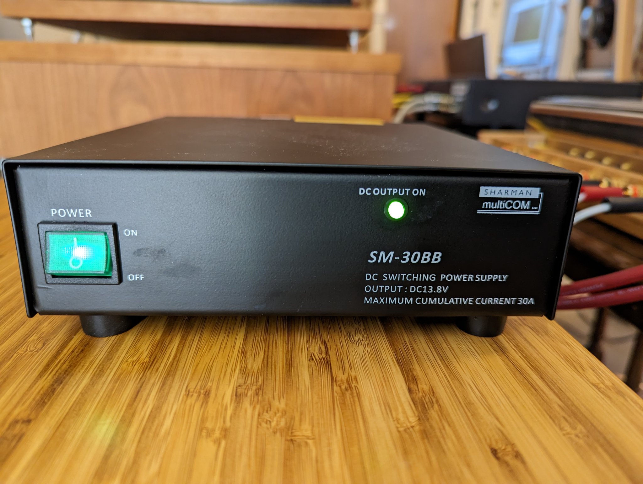

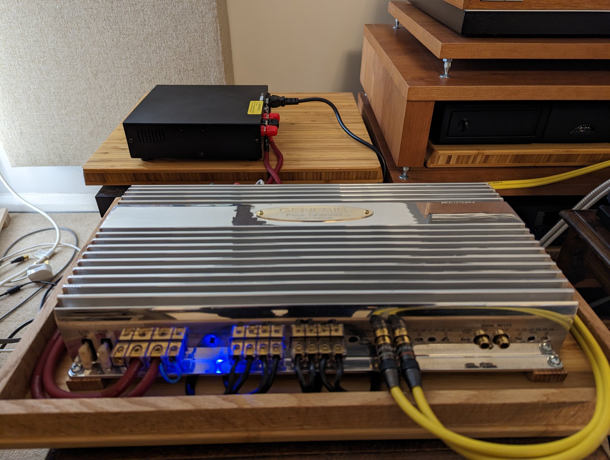

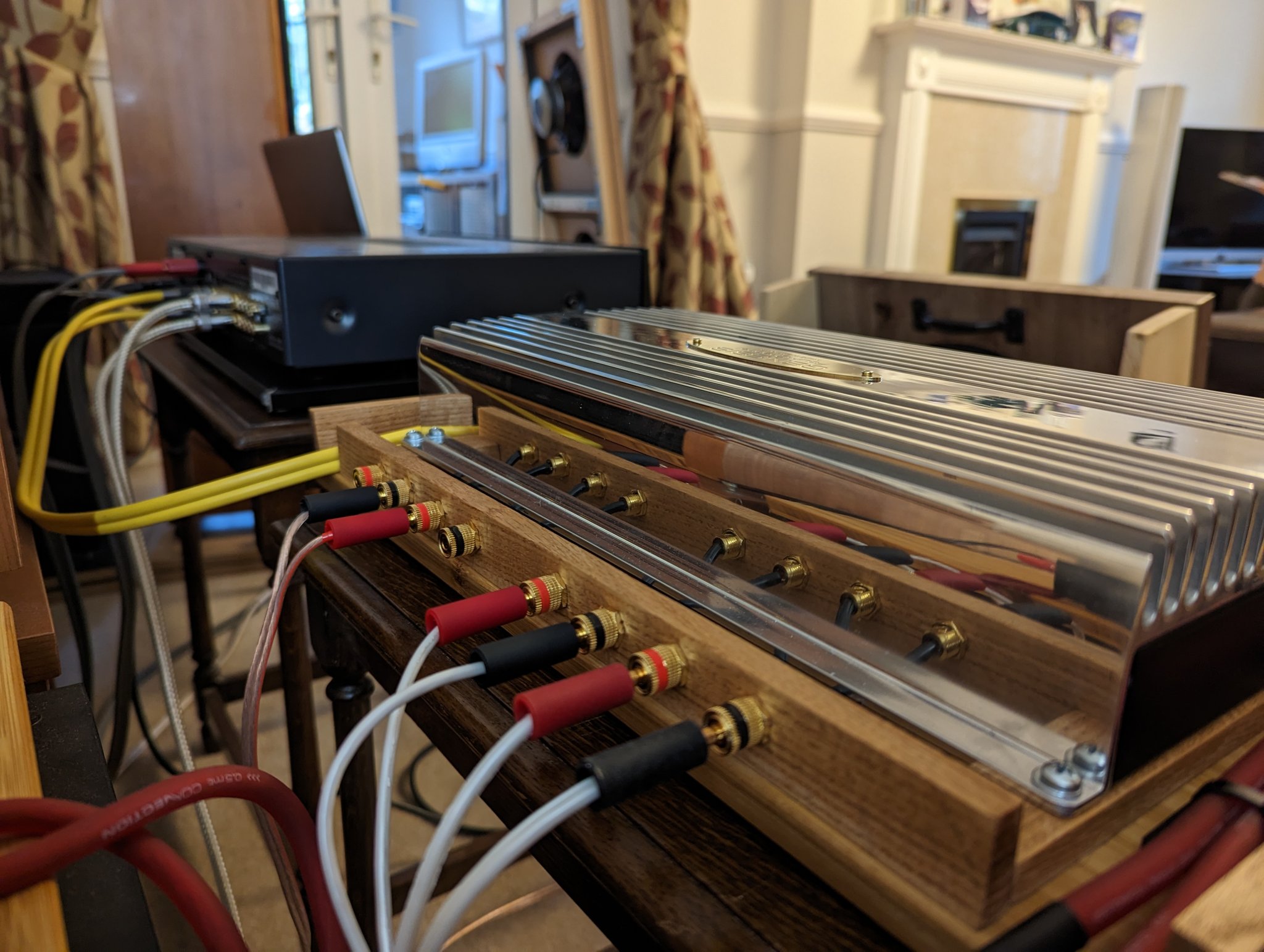

An update on this. I ordered a Sharman SM-30BB from Radioworld and I finally got around to making a suitable amp rack/stand for the Genesis incorporating speaker terminals. All is running spot on so far. The power supply seems more than up to the job and, IMO, when finally installed in the cabinet it is all going into, will look nice and tidy.
Connecting a short wire from the 12v input on the amp to the remote turn on terminal sorted switch on and it all powers on with the switch on the power supply.
The amp is a pretty comprehensive upgrade sonically over the Chinese subwoofer amplifiers I was using before.
