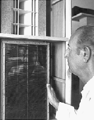

The original Beveridge stators were clamped together in this way with machine screws, lock-washers and flat washers every 1-1/2" or 2" all the way around. I guess this makes rebuilding them easier (in theory), if a bit tedious to build originally, as no nuts were used--threads were hand tapped into the cast epoxy stators.

It is very tedious to bolt and unbolt screws as I did.
A big panel would be a real PIA.
I dread it when I have to take my 9" X 22" panels apart as I have a mounting bolt every 2 to 4 (2.5" average) inches which may seem like an over kill but this makes sure that there is ample presure to keep the frames from moving.
Upon disasembly I have found that the mylar has shrunk as much as 1/8" to 1/4" and is difficult but not impossible to reassemble.
