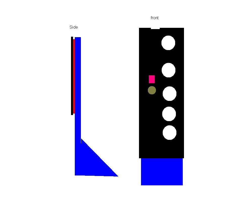

HI again. I just had another idea. Feel free to rip this apart. Keep in mind that i will have active EQ and 6 channels of amplification. Ok what i propose is and correct anything i say wrong i can go back and read all the data again till i understand it exquisitly. here is a cheesy picture to clarify my written description.
http://i4.photobucket.com/albums/y121/madmike2/Basic.jpg
i want to take Surgical packing foam, it comes in a grayish black colour and flat sheets of 5/8's thick and sandwich it. Front baffle will be 1/2 inch white pine and the rear support and baffle will be 1 inch mdf that i have. each panel will be 4 x 8 inch woofers wired series paralell to a single channel. In the middle of these sitting side by side will be a 4 inch mid and cd5 fountek ribbon tweeter either wired together to one channel with a simple 12 db crossover since there will be an active x-over removing 400 Hz and lower. Or i can run the tweet on a channel the mid on a channel and the 4 x 8 array on the 100 watt channel with the Dbx doing crossover duty. The front baffle will be in the range of 90 % decoupled from rear as i will use 2.5 inch black mushroom bolts and polyurethane donuts on the back side with wingnuts to cinch the speakers to the front baffle. Almost all the transmission of energy that does make it to the back will be through the poly as the medical foam is CDC certified for vibration absorbtion.

In that picture the red fill between the black and the blue is supposed to be the foam sandwich. 🙂
how about this arrangement /use any amount of woofers, i just did not wanted to redraw whole pic/
that should reduce the hight considerably

well in the above situation there will be some source shifting continually due to different horizontal positions,how bad,I duno.
Id go vertical if possible. Why 4 x 8"s?Wont 2 do?
Bear in mind that the 8"s if reproducing the same frequency range will comb filter when the wavelength approaches the driver to driver spacing[midrange]
What drivers?
Nothing wrong with the design. MJKs Focal TLs worked better with side-by-side driver mounting -- showing that conventional wisdom always has to be considered with a grain of salt.
The wider the baffle the lower the bass.... as drawn you will need lots of EQ to get any bass, and 4 8s probably will run out of excursion... making the baffle wider means you won't have to work them as hard.

I just sat down and did a rough recalculation of the lower frequency wave propogation off a resonant baffle arrangement from the 6.5 inch and i get nearly 35 inches wide for the 6.5 inch. Its probably not right but i am assuming a set frequency times the speed of sound times the drivers SD for a length. Then picturing a 'launch' off the baffle and working on TL theory except i am not aiming for 1/4 i am aiming for 1/16. My brain hurts. I need something to hit.
Anyway, the narrow baffle cant launch low frequency waves so they just wrap around the baffle and meet the back waves for NF cancelation. Is this correct? Is that why i need a wider baffle ?
