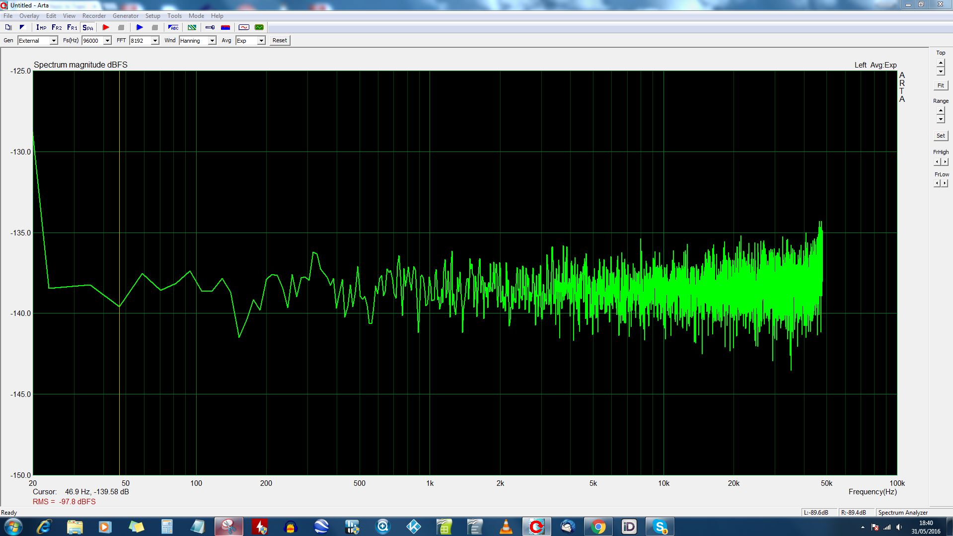

Hi !
i have a kind question about the noise measurement with the mode spectrum analyzer
I cannot get the part for Hz > 48kHz 😕
Is there any setting to select ?
Thanks a lot.
Kind regards, gino
At 96k sampling there is none. If that is confusing find a sampling theory basics tutorial on the web, there is lots of help available.
Hi ! thanks a lot for the very kind reply.
I guess that 48k is the upper limit with 96k sampling rate ?
So to get 96K i must increase to 192k sampling rate ?
Perfect. I have absolutely no need to go beyond 48k.
I am not much in high rez. My collection is almost exclusively of cds.
Thanks a lot again, gino

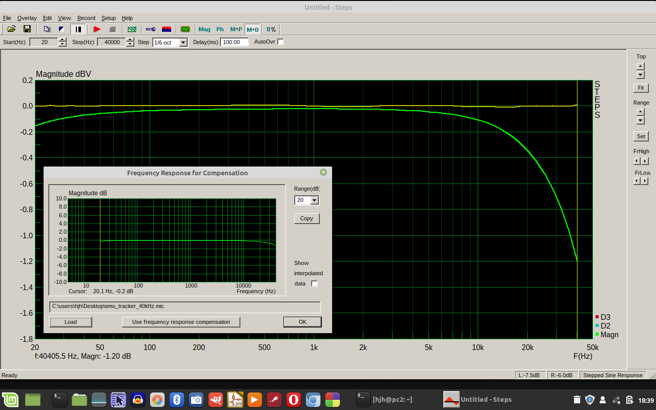

To get most of your soundcard while measuring frequency plots using STEPS you can add a frequency compensation table in a *.mic file. This way the imperfect frequency response of your soundcard can be compensated by software. And this works for amplifier frequency response measurements as well.
At first make an uncompensated loopback measurement, for instance 20Hz..40kHz @24bits, 96kHz samplerate and 6samples/oct.
After completion move the cursor with the tab key over the samples and note frequency (Hz) and level (dB)
Create a *.mic textfile containing a list of samples with one sample/line like
5500 3.3
stating 3.3dB @5500Hz
Load this file in the STEPS/Setup/FR Compensation dialogue
check "use frequency compensation" button
measure.

What are you trying to measure, which causes a problem if the soundcard response drops 1.2dB at 50KHz?
Most soundcard responses will drop this much. My Focusrite Scarlett 2i2 does too.
I find the compensation file (*.mic) useful for linearizing mic responses, which are often less linear than soundcards and bang in the middle of the audible range.
I agree that uncompensated fq response is not bad at all. My goal is measuring fq response of class-D amps up to output filter resonant frequency with different postfilter-feedback under different load conditions. The ultra-linear frequency response achieved by a simple correction table has been worth the effort imho.
