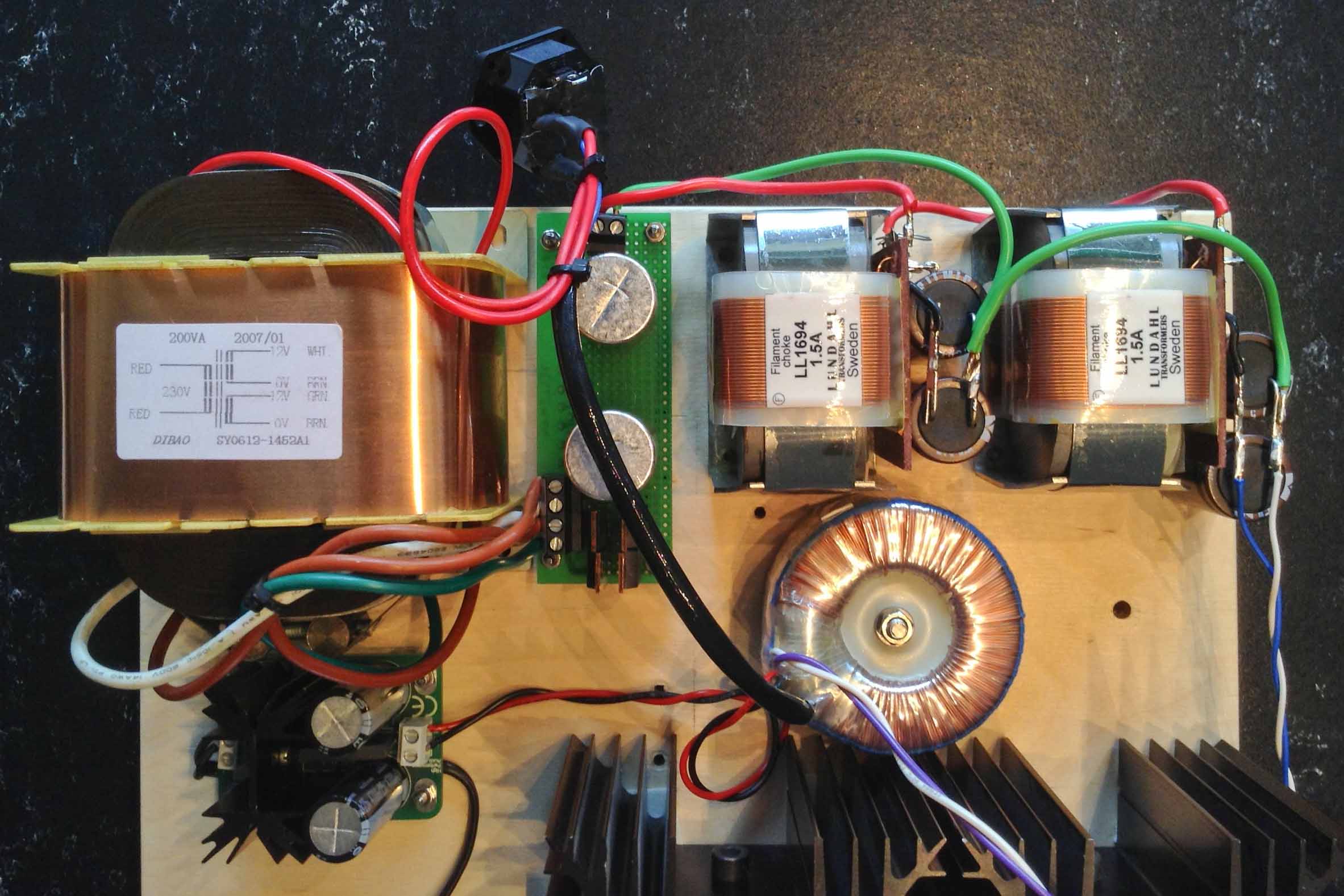

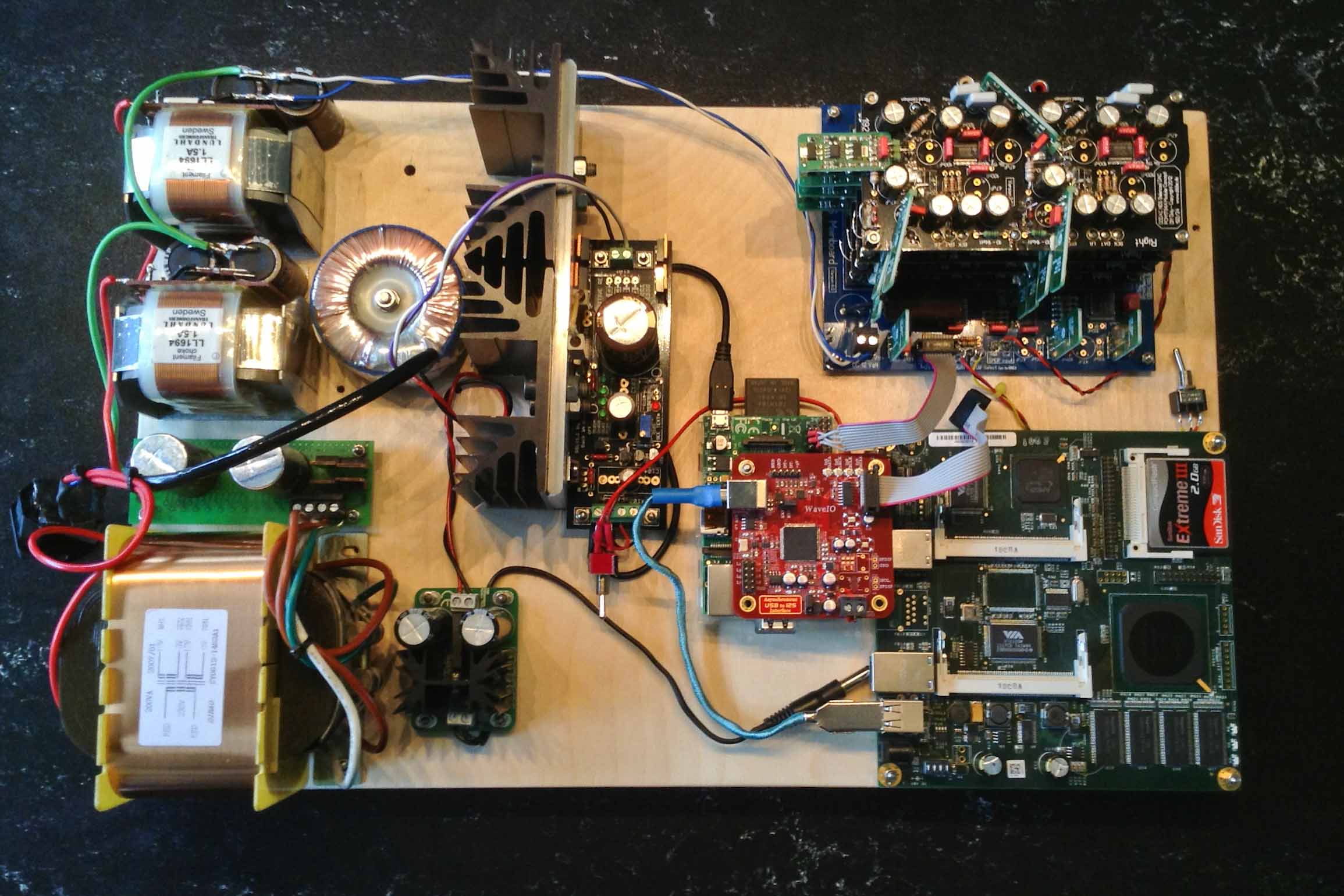

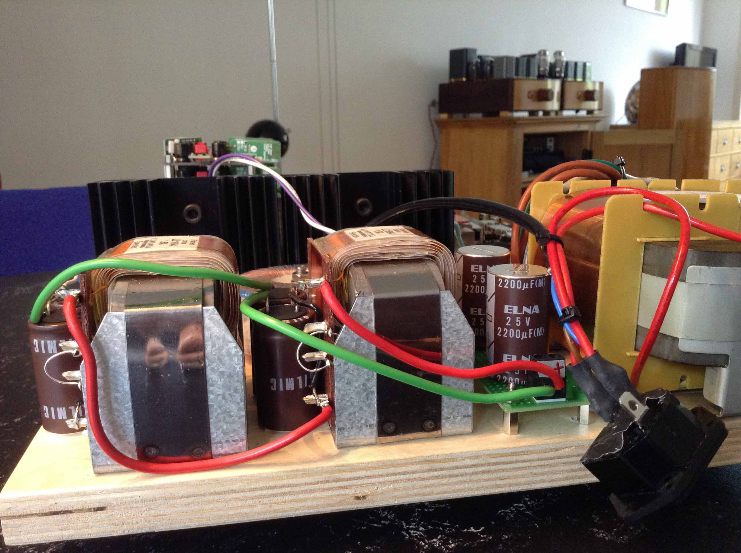

So here are the pictures of my new power supply. It's quite elaborate so I needed to rearrange the complete layout. I put the wave IO on top of the Pi, I still use two streamers, the Alix and the Pi; Alix through Wave IO and Pi I2S connected. I like the Pi more. Just waiting for Russ White to release the cape for the BBB.
On to the supply: on the left side there is a big 200VA transformer (sec. 2x12V), a friend of mine had ordered these specially manufactured to order for use with other Dacs and CD players. This is a really awesome transformer!
It is a simple CLCLC supply using two Silmic 2200uf caps parallel and Lundahl filament chokes.
This supply surpasses all supplies I have used up to date, including the one from Bernd during the visit at Klaus!
It's been a long time since I had so much goose bumps listening to music 😉
Advantages: dynamics, openness, forcefull, detailed, more space, did I mention dynamics?
This one will stay for sure!
The Salas supply is for the Pi and Wave IO.

It looks very good, and doesn't seem to be very difficult.
On green PCB, is it a diode bridge ?
So to sum up, you're just feeding MB and decks with this >12VDC current, and let the shunt regs do their jobs ?
It sounds easier than feeding 8V and 3.3V with separate external regs...
How much does the chokes cost ?

Yes, it's just a replacement for the standard power supply. The shunt does the regulating, the AC ripple is already very low with two chokes so there is really no reason to use extra regulation.
On the Green PCB there are some nice Schottky diodes from Vishay; VS-15TQ060PBF in TO-220 package, and two Silmics.
I did not build separate regs for 3.3v and 8v because I already have the shunts on the dac boards. Shunts are pretty expensive so if you are starting out with a new dac it will be cheaper to build two regulated power supplies. Cannot comment if this will be better than my current setup but it will defenitely be possible to beat the sound of the standard regulators on the boards.

I finished my new raw power supply today with a very nice 200va transformer and two lundahl chokes. The chokes have been running last week with another trannie and I soldered the big trannie in today.
The shunts on the dac boards do really not need any pre-regulation. It sounds quite a margin better with the new power supply!
I will post a picture soon.
