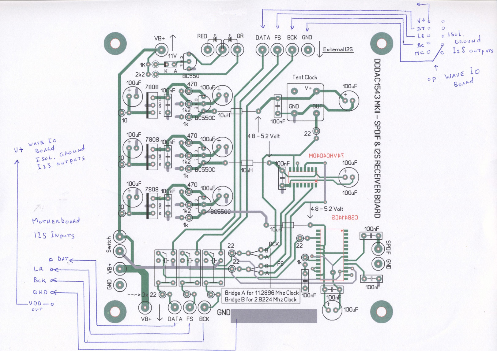

I have drawned the following general cabling diagram to explain my question:
The WaveIO card I2S output should be linked to the 1543 card (I2S input).
My question is HOW should I connect the "V+" pin at the output of the WaveIO card ? It has to receive +5V, but can connect it to the +5V of the main WaveIO card (as on the attached diagram), or should I get this +5V from somewhere else ? (maybe the 1543 VB+ output ?)
I am not sure at all of my cabling, so I prefer to ask prior doing anything wrong ...
Thanks !

Also Im pretty sure the sowters primaries go across the pos and neg output from the dac board not the pos and com
OK my mistake, I have changed the cabling diagram accordingly...
use the V out from the 10 pin header on the mainboard. straight to the USB board
By the inputs of the Mainboard there is a 3.3v output pin normally that is connected to the WAVE I/O through the standard ribbon cable Doede supplies with the kit.
OK: The "V+" of the WaveIO I2S connector is provided by the "VDDout" of the Motherboard 10 pins header.
This VDDout is supposed to deliver +5V, not 3.3V as the pin located near the I2S inputs, so this last one should be useless if I understand correctly.
Thanks friends, for all these details, my cabling diagram should now be OK :

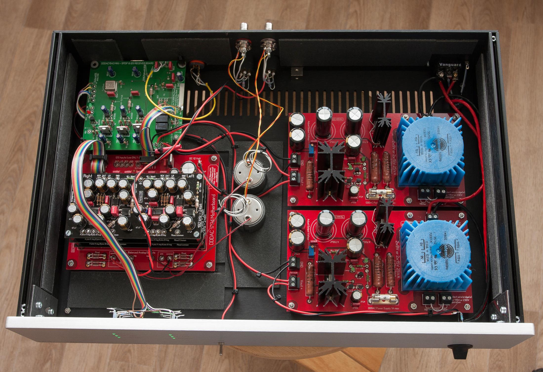

My DDDAC arrived yesterday, and Today I have it half essembled. Many thanks Doede!
Here to share my excitement with photos attached!
Sent from my iPad using Tapatalk

Hi rhlauranna,
Many thanks! Mine came with a pair of Sowters! I have also went on replaced the stock 4700uf caps for 12V to DAC to Mundorf M-Lytic caps as shown on the photo. 4700uf stock caps for USB remain unchanged.
Furthermore, I was thinking of replace a 1uf cap on mainboard near Tent clock (pls see photo) to a better grade cap like Jensen copper or Mundorf SGO. Also want to add bypass cap 2.2uf Mundorf Supreme to 470uf electrolytic and 0.22uf Audyn true copper to 47uf electrolytic on the mainboard. An email to Doede if these are ok so I can start my experiment further the boundary of SQ!
