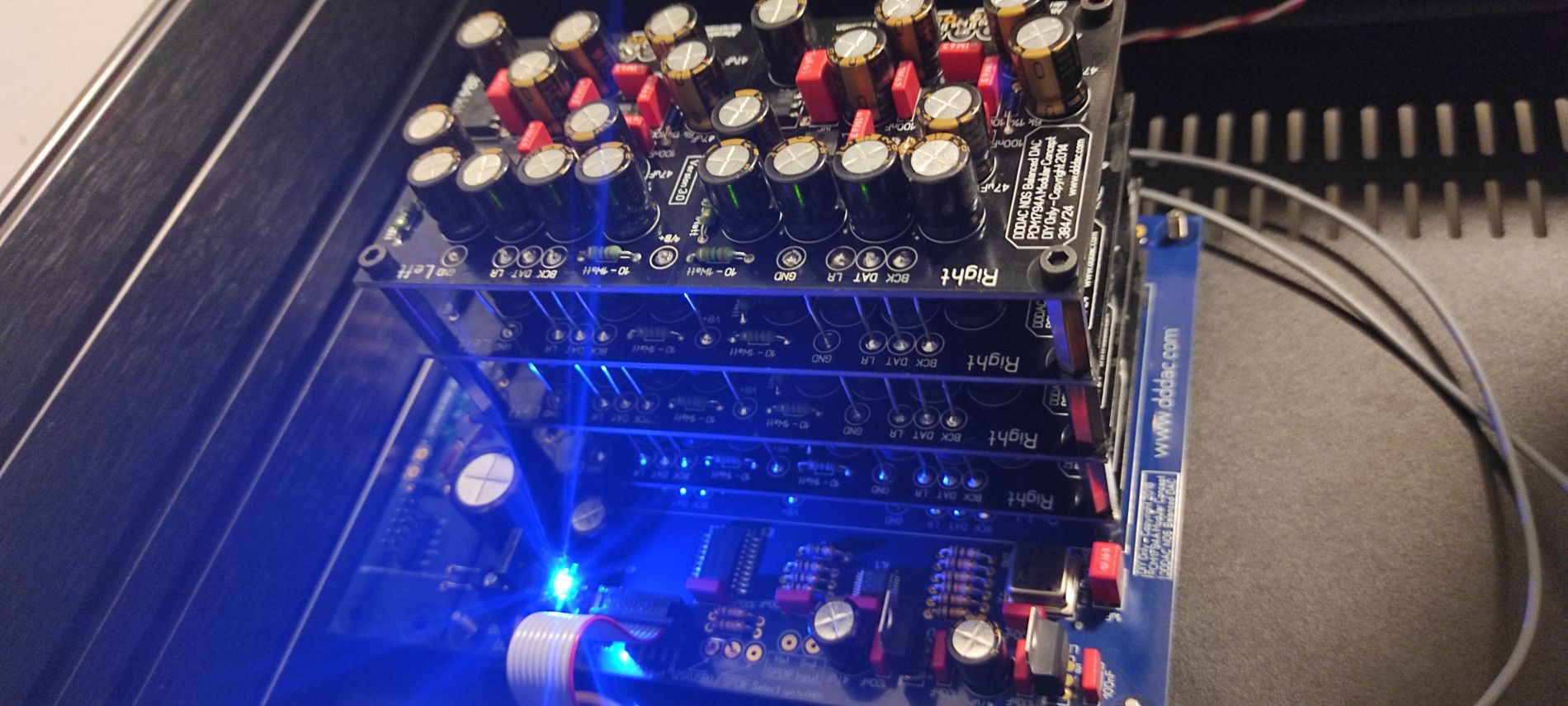

I have finished the build. Will post pictures when I finish wiring, but it sings and works.

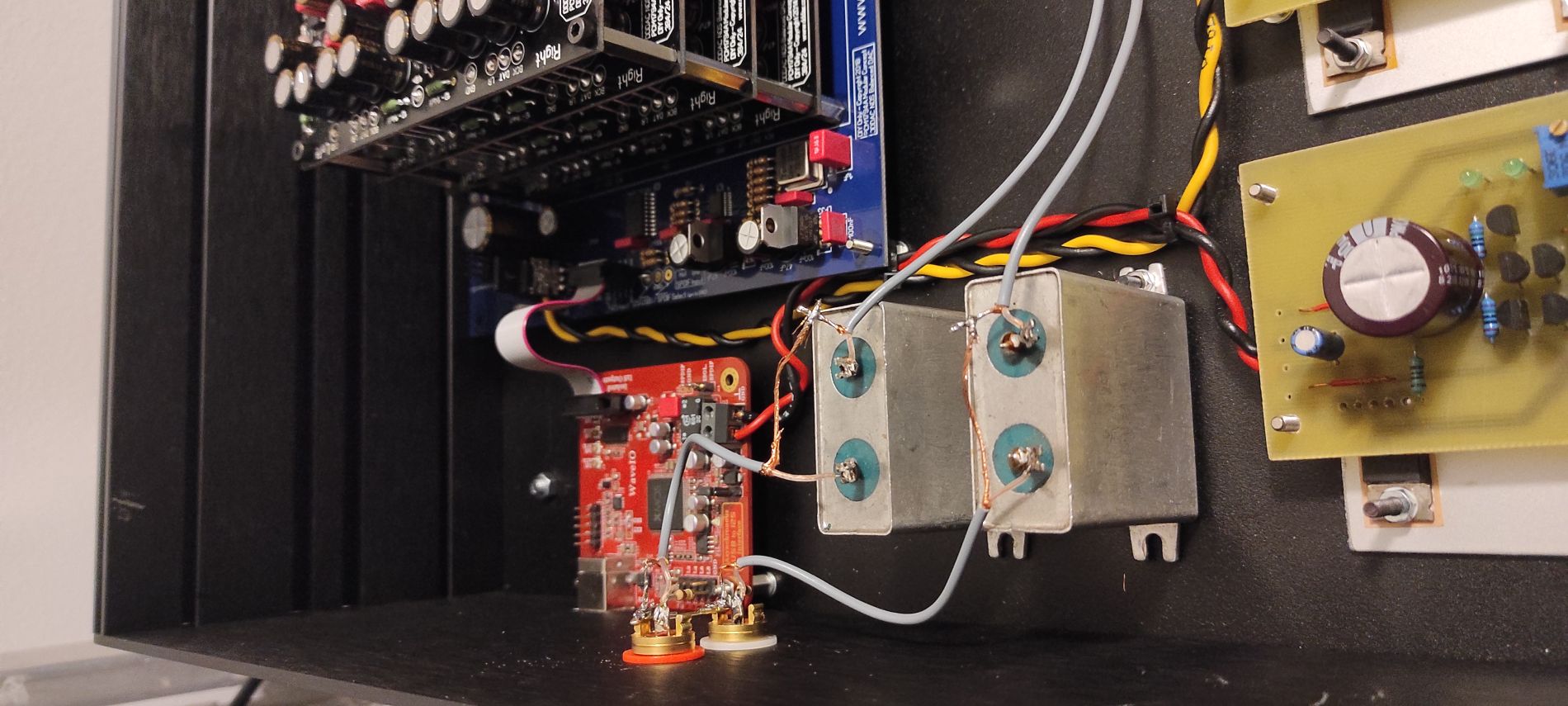

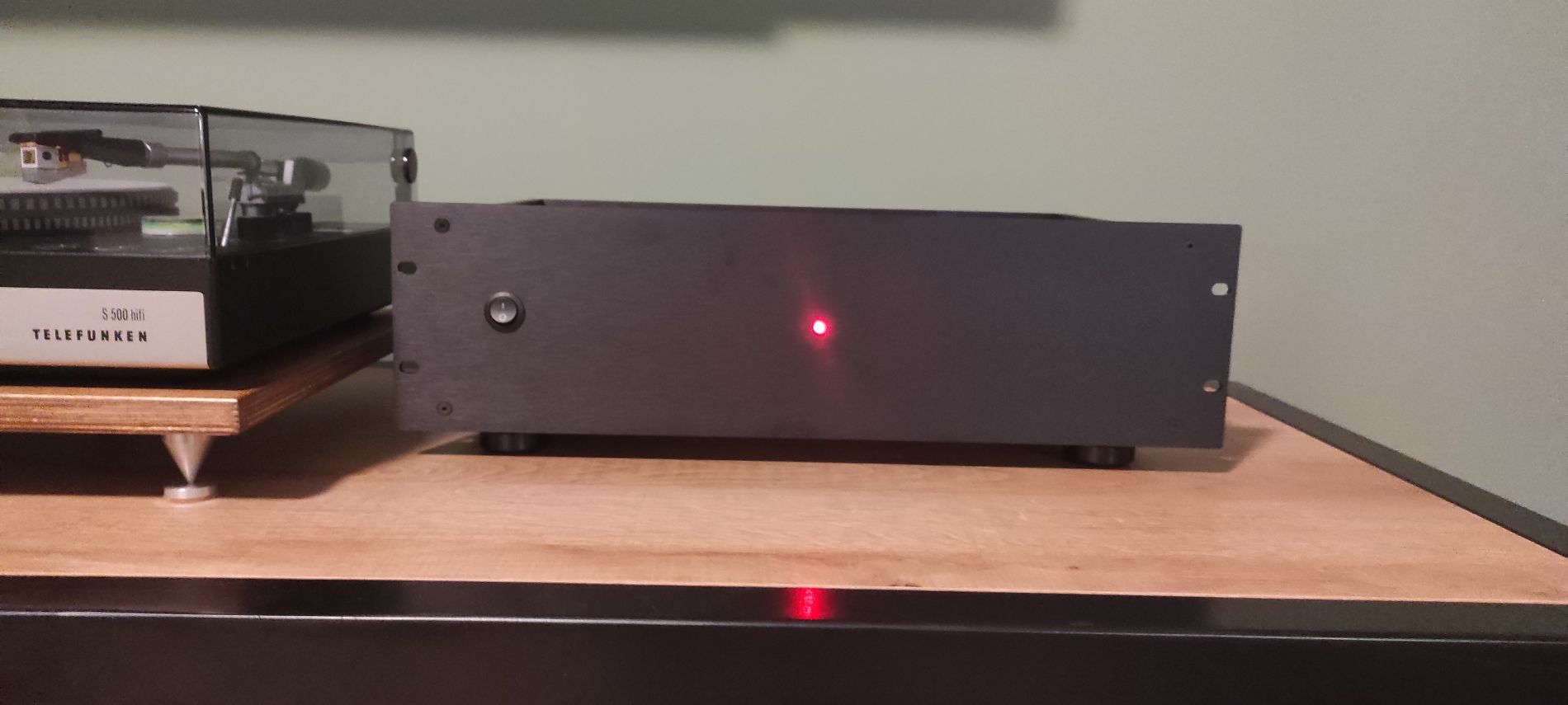

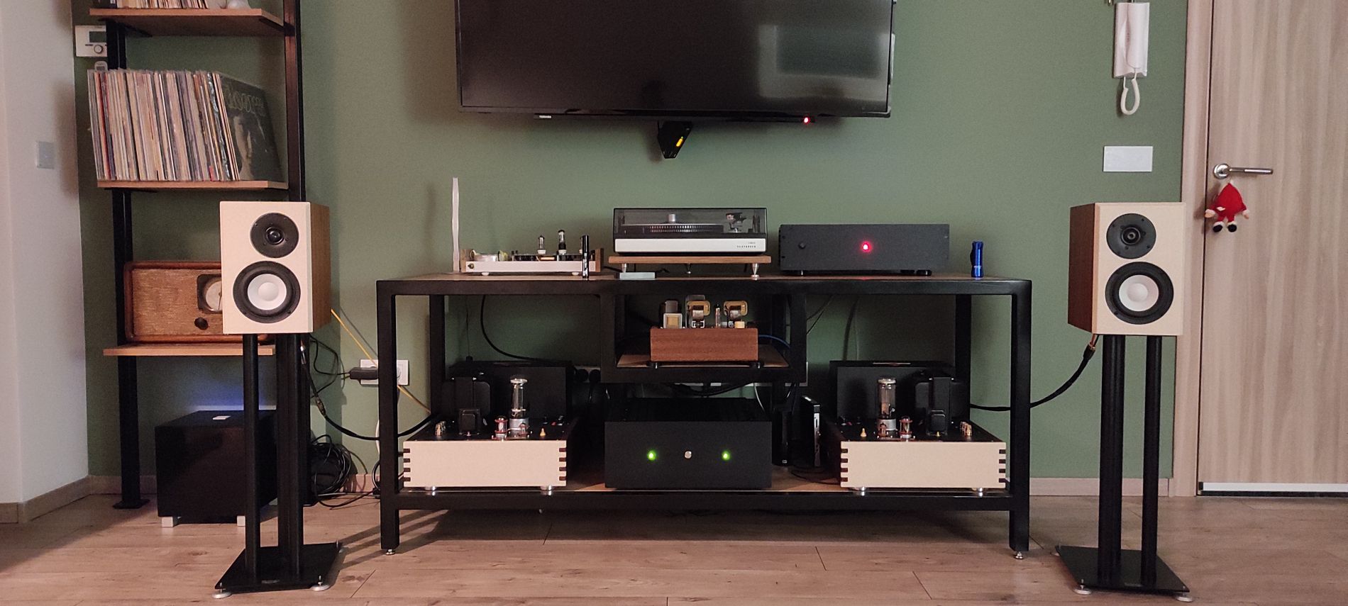

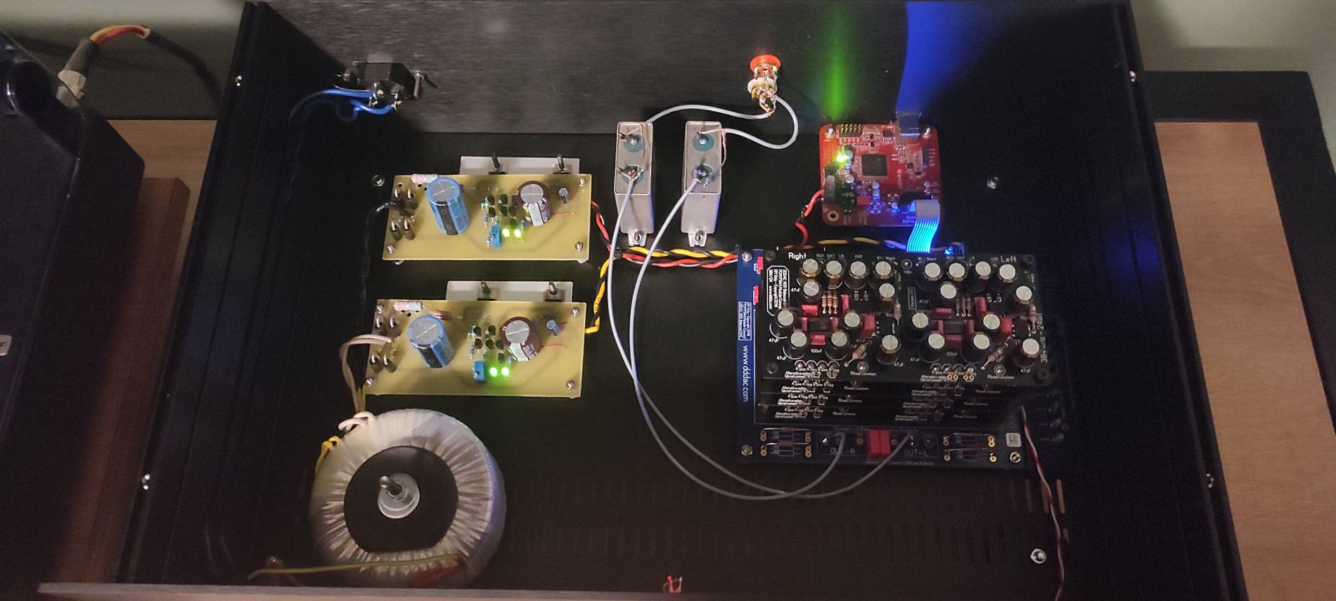

I have attached a few pictures. I am very happy with DDDAC sound. Boards are v3.0, mainboard is the latest version. For now I use WaveIO and I am very happy with it. In the future, I will look for Amanero with IAN Ultimate FIFO reclocker etc.
But, main goal are the output transformers. I am asking for a feedback about Audio Creative O.P.T. Silver & Gold for DDDAC and Sowter OPTs. Price is very different. I read somewhere that even Cinemag 15/15B are good, but 🙂
Thanks in advance

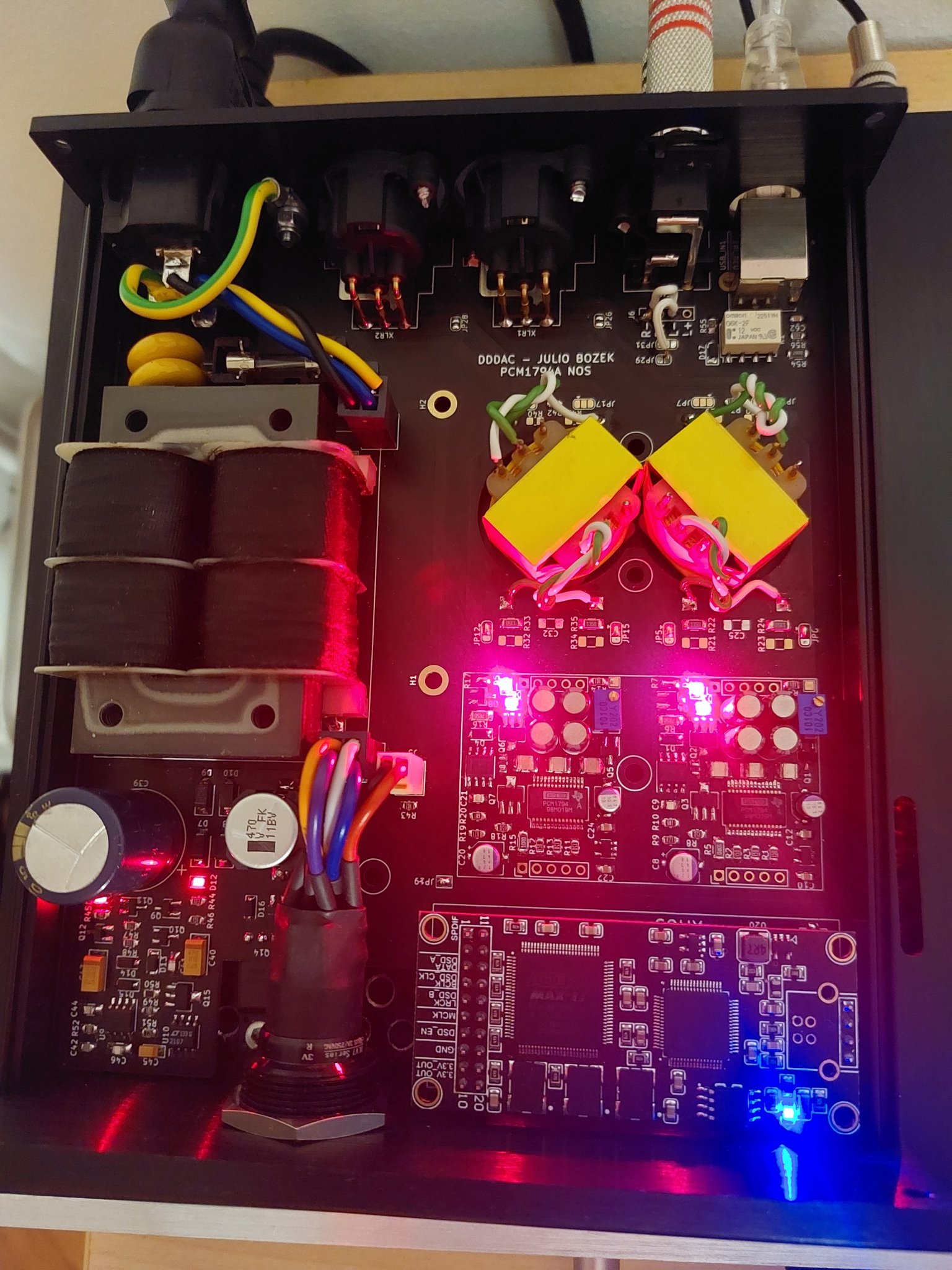

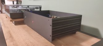

Hi. I have not tried any of transformers you mention. But i am using these ones for a week: https://it.aliexpress.com/item/32810421236.html
I bought them because they were used in STAR PURE DSD dac by Andrea Ciuffoli and Pavel Pogodin at www.audiodesignguide.com.
They said that those are better than many others costing much more. You can see transformer testing here: http://www.audiodesignguide.com/DSC2/OPT/index.html
Anyway, they are excellent, much better than capacitors. Sound stage is bigger and voices are so natural that i somethimes think i can feel a singer in front of me. Bass is more tighter and stronger. I always thought that transformers will kill some of bass, but not these ones. And that is with one deck!
These transformers are not an usual "aliexpress yellow transformer".
They cost 55eur (pair) and i highly recommend them to someone on budget or anyone else.
Also i would recommend to look at Ivan Bisesik transformers: https://www.diyaudio.com/community/threads/output-transformers-for-dacs.327794/
According to forum, they are better and bit cheaper than cinemags.
I hear a very quiet hum at full wolume (headphone destroying volume). I need to isolate them with copper foil and i need to put an L metal profile between power and signal transformers. With metal piece between them noise is non existant. It came out very well considering the size of dac.

Great,
but I have 4 boards. Don't know if those transformers can handle the current ...
Regards
There is no large DC current through the output transformers if the DC offset at the DDDAC output is small. So that transformer can be applied. I tried one similar, on 4 boards, on the same core, just wound as 600: 600 ohms. The sound is not something special, but again, maybe that 10k: 10k sounds better. I will rewind it bifilar, with thinner wire and more threads, it’s sure to sound better that way.
