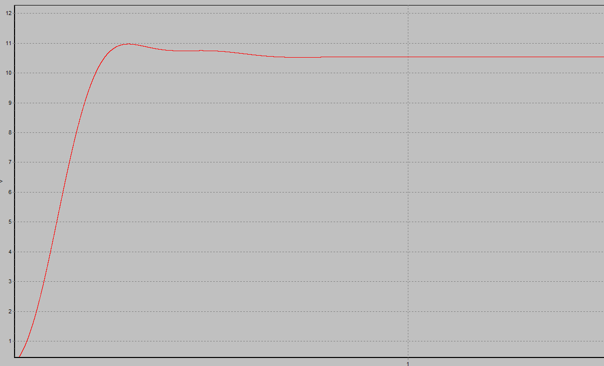

hi again, after some reading into choke power supplies (thanks eduard 😉 ) and looking for available parts, I simulated the attached circuit for a Kali-PSU (I'm aware that the bleeder resistor is still missing as it seems PSUD is not able to add one, and I have no clue of what rectifier diodes I want to use yet. Perhaps schottky?)
The plan was to add some kind of voltage regulator to secure stable 5V output and perhaps some kind of common noise filter (if necessary).
I would appreciate it, if someone with experience could tell me if I'm overlooking something.
Greetings hifoli

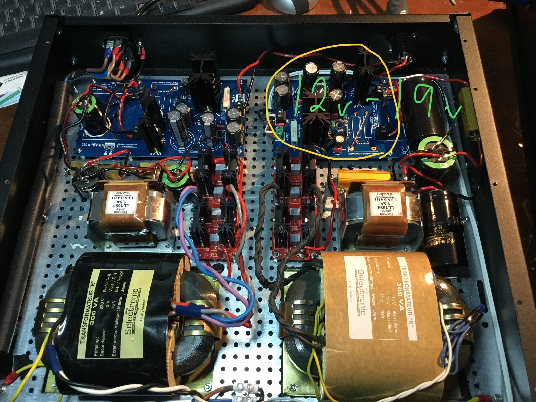

Here is mine external psu. R-core trafo’s, Sjøstrøm rectifier bridge, mundorf silver in oil caps, Lundal chokes and dddac stock psu.
After adding the Kali recklocker, my setup plays with punch, drive and a lot of details.

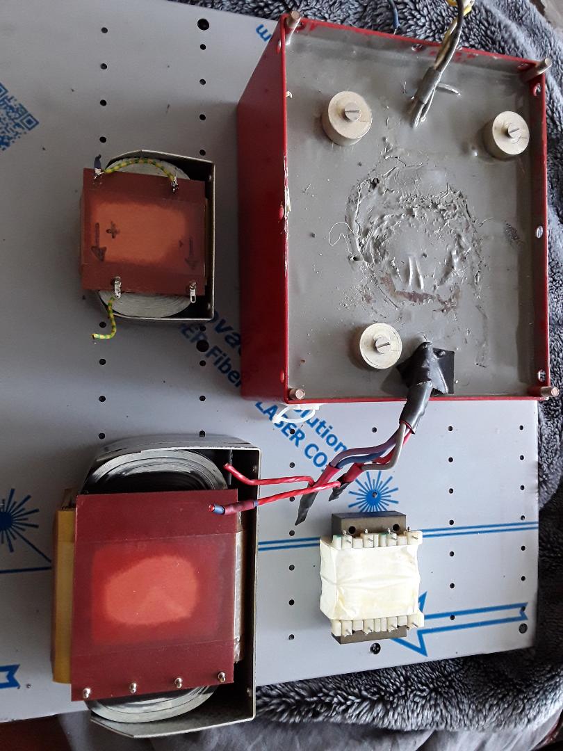

Hello,
Just to put things into perspective a photo with some of the old and the new LC supply parts. The big red one is the old transformer, the one next to it is the new one.
The small Lundahl is the old choke and the big one the new one.
Greetings, eduard
P.s not completely true!!. This is the transformer i would use now but when i bought the new transformer i wasnt exactly sure what voltage i would need need to i bought one with several low voltages on the sec. side so i could '' compose '' the right voltage. New transformer has a lower ( 160va) than the old R core which was 500VA
