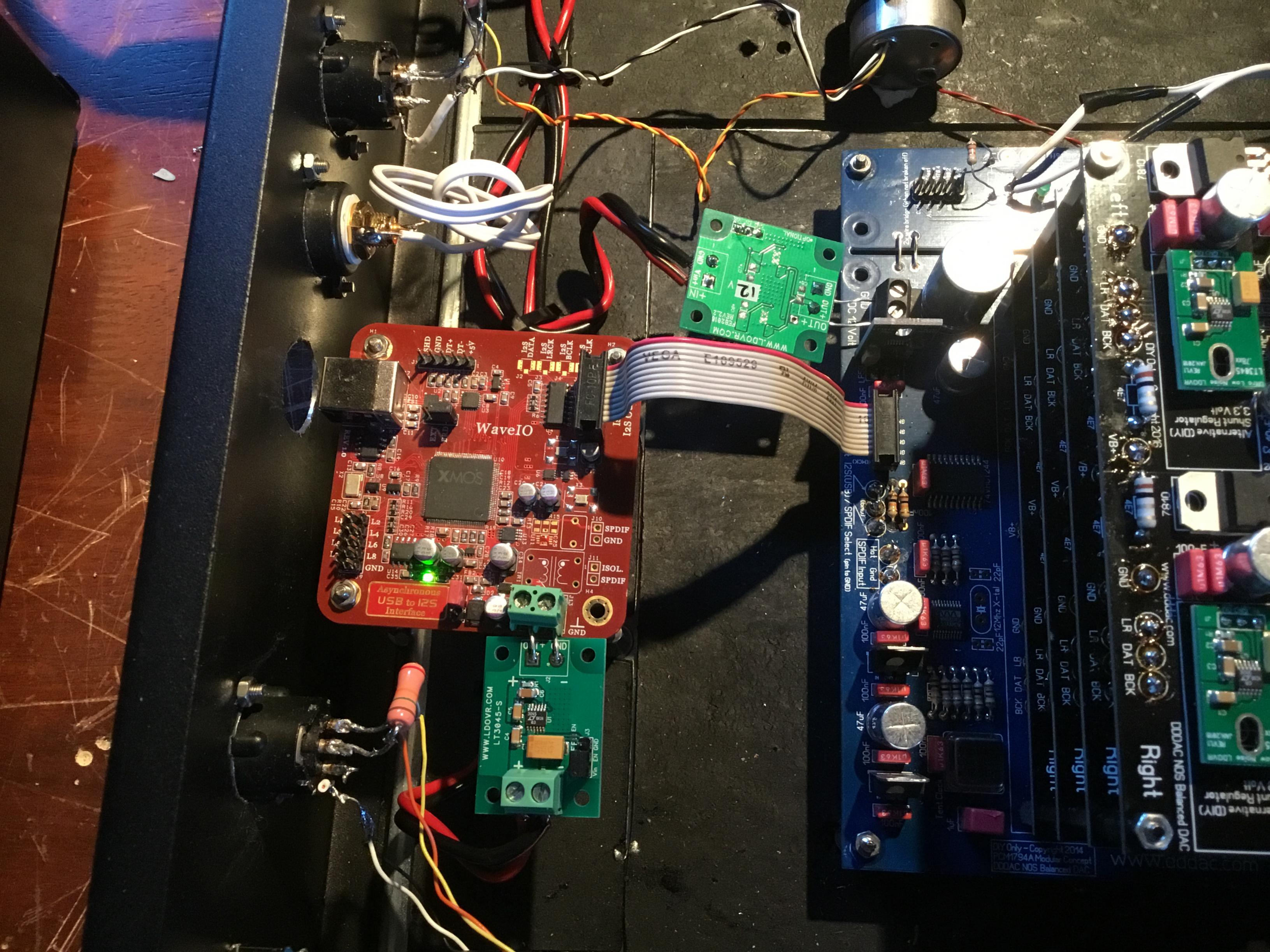

My LT-3045 adventure has come to an end. 5v on WaveIo’s input and 12v on input mainboard. Best sound so far. I think that the two 5v regs on WaveIo’s input and I2s isolated has most impact on the sound quality. The 3.3v regs on the dac boards digital side are very hard to tell if there is any improvement at all. I think doede is right here.
So my advice is to change the two 5v regs on WaveIo input and I2s isolated side.

Hey, thanks for the update. This is interesting. Would request a few clarifications:
1. Post #6758 stated that you recommended the LF50 reg on the main board to be swapped with LT-3045 (5V) for good results. What you mention in this current post of yours is recommending that in addition to this swap, more of these swaps are also required? Is my understanding correct?
2. In your Post #6821, which product code from the website do you recommend ordering:
LT3045-M (this option is out of stock)
or
LT3045-S (this option is in stock)
3. On the WaveIO USB board, you are recommending changing two 5V regs. Can you indicate where do these 2 regs go on the USB board. As per my understanding, I only see one LT3045 inserted in the picture you posted.
4. On the 12V supply area, you have inserted a 12V LT3045. This is connected where the 12V Power Supply wires and join in on the screw taps. Are we bringing this 12V regulator in, in place of any existing 12V regulator or is it brought in as an addition and was not existing earlier?
5. So net net basis your answers, there will be a requirement of ordering 1 or 2 5V LT3045-S regulators for the WaveIO board, 1 5V LT3045-78XX for the main board and 1 12V LT3045-S regulator to go on the main board where the 12V supply comes and connects?
Appreciate if you can answer here point wise for better clarity. Thanks in advance.
Here you see the two 5v regs. That’s all you have to change. Forget about the rest.
Okay so one of these 5V one is the one which is on the main board and that one you had changed in post #6758 (LT3045-78XX), correct?
And the next one is on the waveio board itself which you are suggesting LT3045-S of 5V.
Since you saying forget the rest, so I dont even go for the 12V one?

Correct ! In my opinion the two 5v regs have most influence on the sound.
If you want to add the 12v reg on mainboard input, just do it, but if it’s worth it is up to you to decide. I can’t hear it’s doing something wrong.

Be carefuel with the voltage on input on the regs. Adjust your psu up to 6v for the 5v reg, and 13v for the 12v reg. I tried with two volt, and the temp went up to 55˚ on the regulator. With one volt it’s down to 35˚. LT-3045 have no problem with only 1v on input to regulate properly.

Sure, thanks. Then I believe I should only order 1 5V regulator for the WaveIO and skip the 12V. I have previously ordered 1 5V for the mainboard and it has not yet been delivered to me. Had I known this earlier, would have ordered these together. Nevertheless, as long as the final outcome gets me better sound, I am ready to wait!!
Since the shipping times are quite high, please rethink and suggest if it is worth going for the 12V reg. I can order both in one go. However, my philosophy is that if it is not improving anything, why bother changing the existing configuration for the 12V part.
Thanks for the warning. I will keep a note of the same. In case required, will seek your guidance at the time of making the changes once the parts arrive.

For WaveIo I now use a mix of choke and stock doede psu. It’s a clcr +doede psu at the end before the LT-3045 5v reg close to WaveIo input. I adjust doede psu to 6v in on LT-3045. With only 1 volt diff there is no problem with heat at all.
I measure around 30˚ on the reg. With 2 volt diff, the heat rise up to 50˚.
