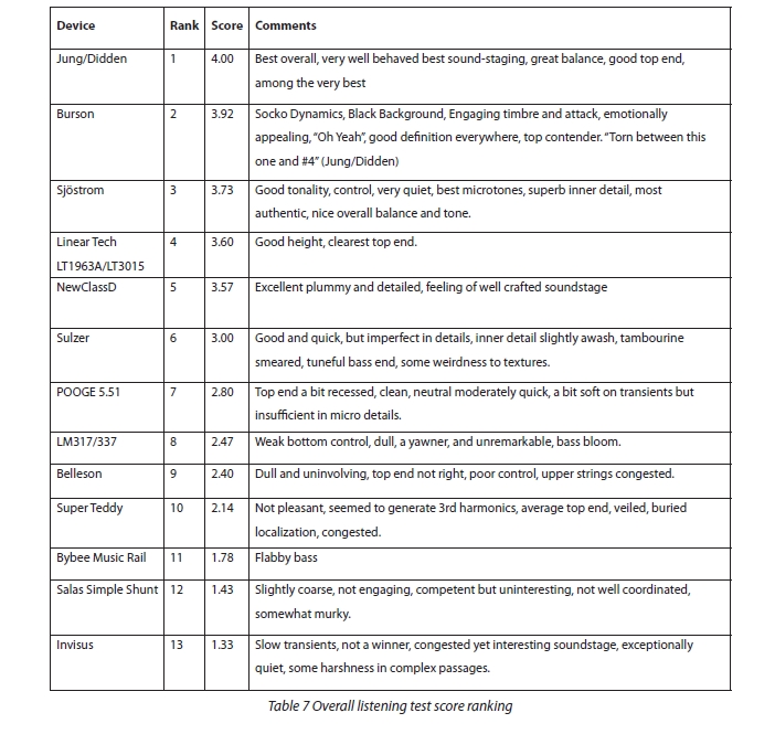

Color graphs for Jack Walton's regulator article in linear audio Vol 4
Linear Audio Volume 4 has a long-awaited article by Jack Walton, comparing a large number of low power supply regulators. Comparison includes measurements and controlled listening tests by the New Jersey Audio Club.
The article has a several rather busy graphs with curves in various shades of grey. The readability could be better, so I regenerated those graphs in color and posted them here on-line.

Hi Rudy,
Pretty interesting power supply test. A bit strange conclusion however, Salas regs are very good in line rejection and output noise. The overall conclusion however is worse than a simple LM317.
As I have used LM 317 a lot and noted they are really bad in audio, I have my doubts about the conclusions!
Have some AD797 lying around so I maybe will build the jung regulator to try, or I might not........... I am very happy with the Salas regs now 😉
LM317...... Yes, wouldn't touch it for audio. But a few pennies more.... LD1085... same circuit, night and day difference.
I compared Salas shunt to series reg in a post much earlier in this thread, (probably a year ago now), and stuck with the cheap, (relatively speaking), LT1764 reg boards I bought on eBay, which I'm still using. I meant to buy a pair of Doede's power supply kits when he made them available, but never got around to it, and now just think, if it ain't broke what am I trying to fix. 😉
A couple of months ago, I tried a Twisted Pear Placid HD shunt supply for the 12V rail powering the DDAC. The eBay LT1764 reg went back into the circuit. Can't justify the cost of the Placid for zero audible improvement. YMMV.
