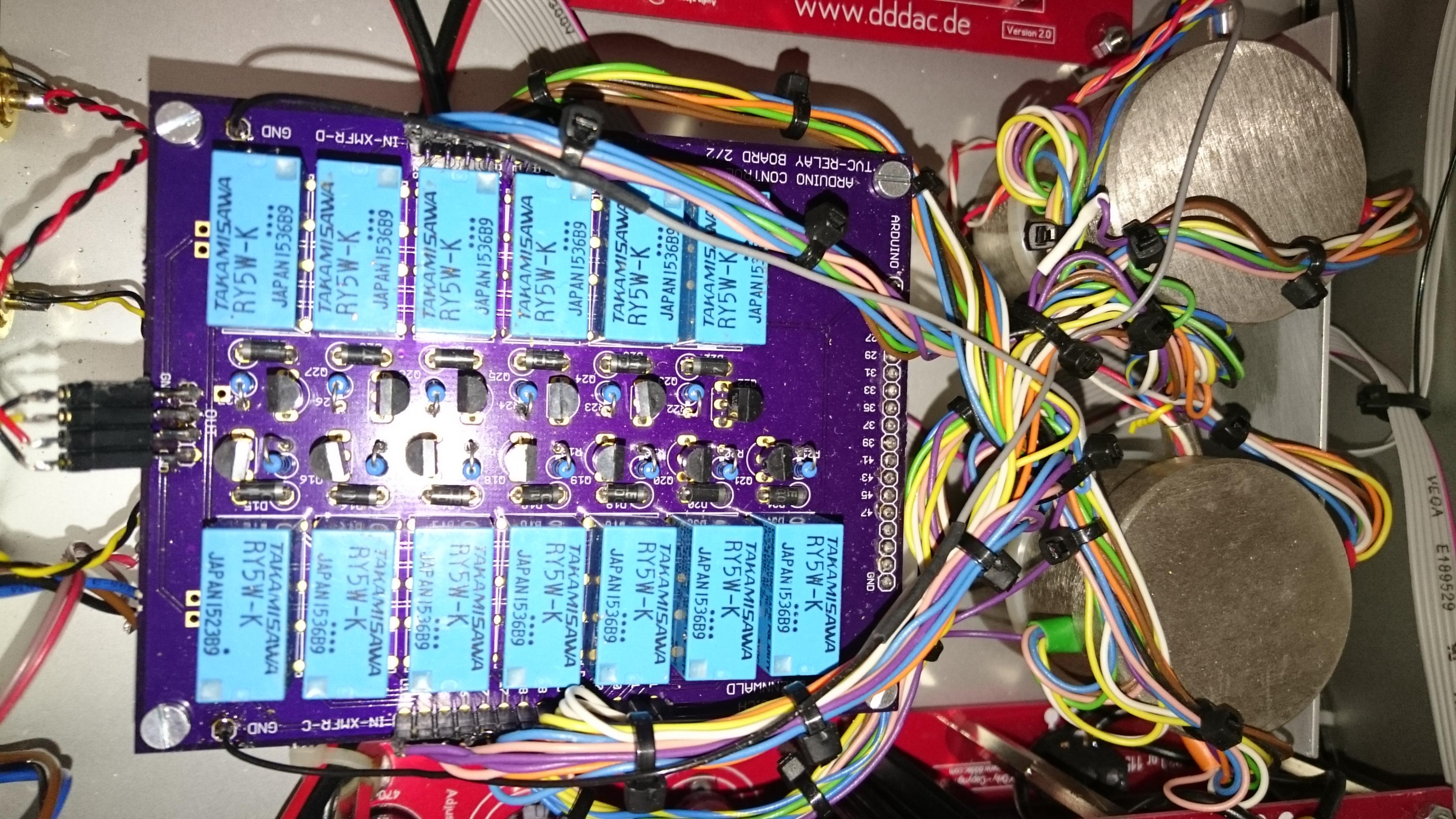

Is this with the autoformer? If so, let's hope it really was a problem with the cold solder joint. But there's still a possibility that the problem is related to the autoformer. Less DAC chips means lower total DC bias current, and therefore less saturation in the autoformer. Keeping fingers crossed!
FIY I attached a photo of my TVCs in the DDDAC (yes, the cables are a mess). The relays are used to select the different taps on the TVC secondaries. There is another relay board underneath the one on the photo, and the whole thing is controlled by an Arduino microcontroller. Works well so far...

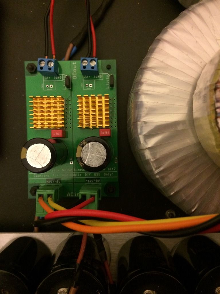

hi guys, after a bit of help if that is ok. I am wanting to power the digital side of the DAC, I believe I need about 6V, each side of this PSU puts out 3.3V. In my naivety I thought I could link the positive of both sides of the PSU together to give me 6.6V but that isn't the case it still puts out 3.3V with both sides combined. Where am I going wrong?
It seems that you plugged it in parallel, if you want to add the voltage, you must plug it in serial 😉
Brilliant, thanks for your help!
