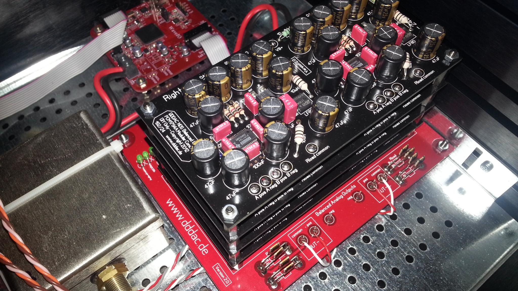

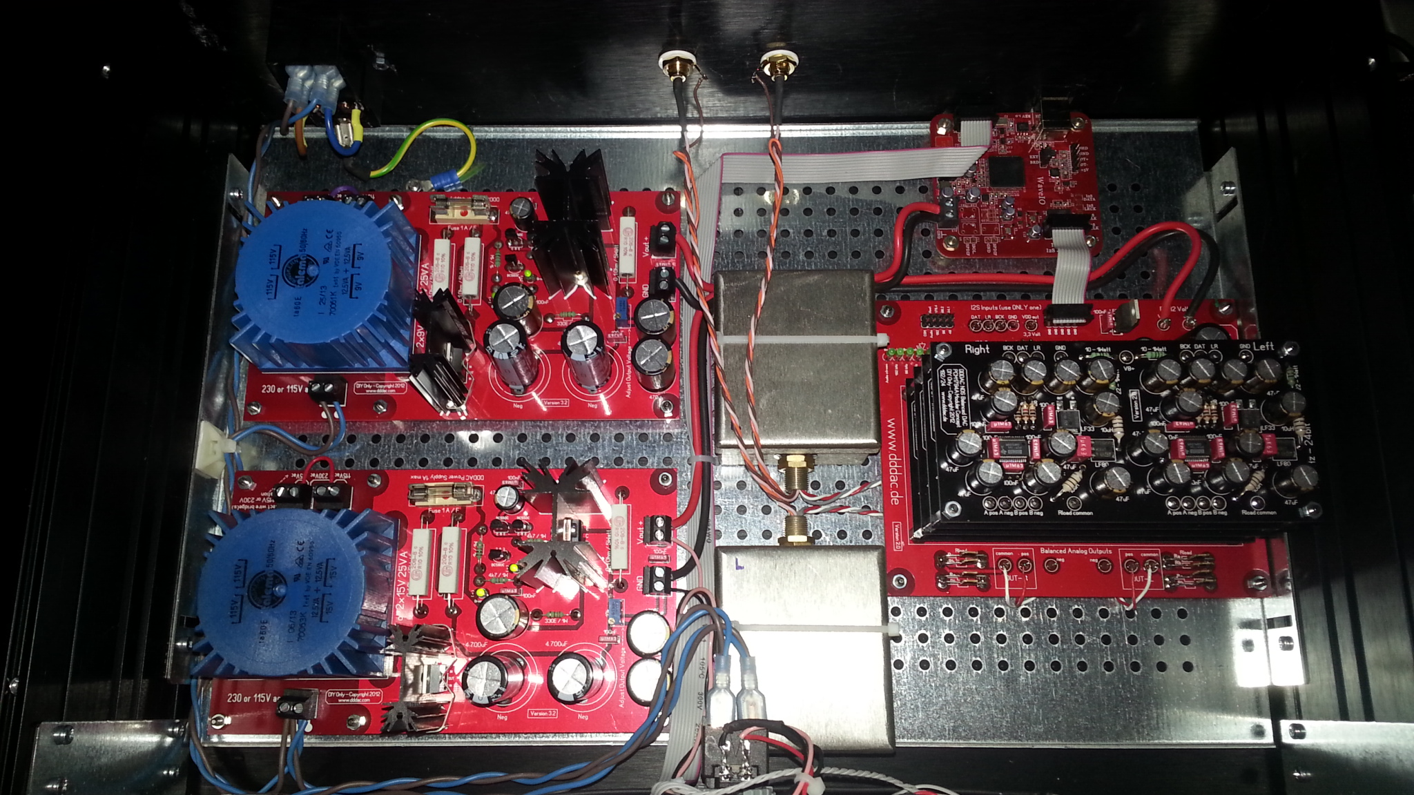

Hi all,
I don't remember how I found this thread some weeks ago but I can say that I am one of the lucky guys that meet Doede and his fantastic DDDAC. I was sheptic at the beginning because is my first approch to the object "DAC". I build my amplifier from F5Turbo project and the preamplifier DCB1 (is the one under the DDDAC on the picture).
Long story short, my DDDAC is playing music since 2 days and I never think to have this result... Is simply perfect!!!... the music flow out so suite and clean... I can't stop to play music... Doede was always available with his advice since the beginning and I can say that after soldering more or less 100 electrolitics I was quite sure that something get in wrong way... not at all!!! First power on and everything works perfectly.

thanks for positive post! good I see the picture.... the transformer should be connected between pos and neg terminal, this will improve SQ and avoid magnetizing the core

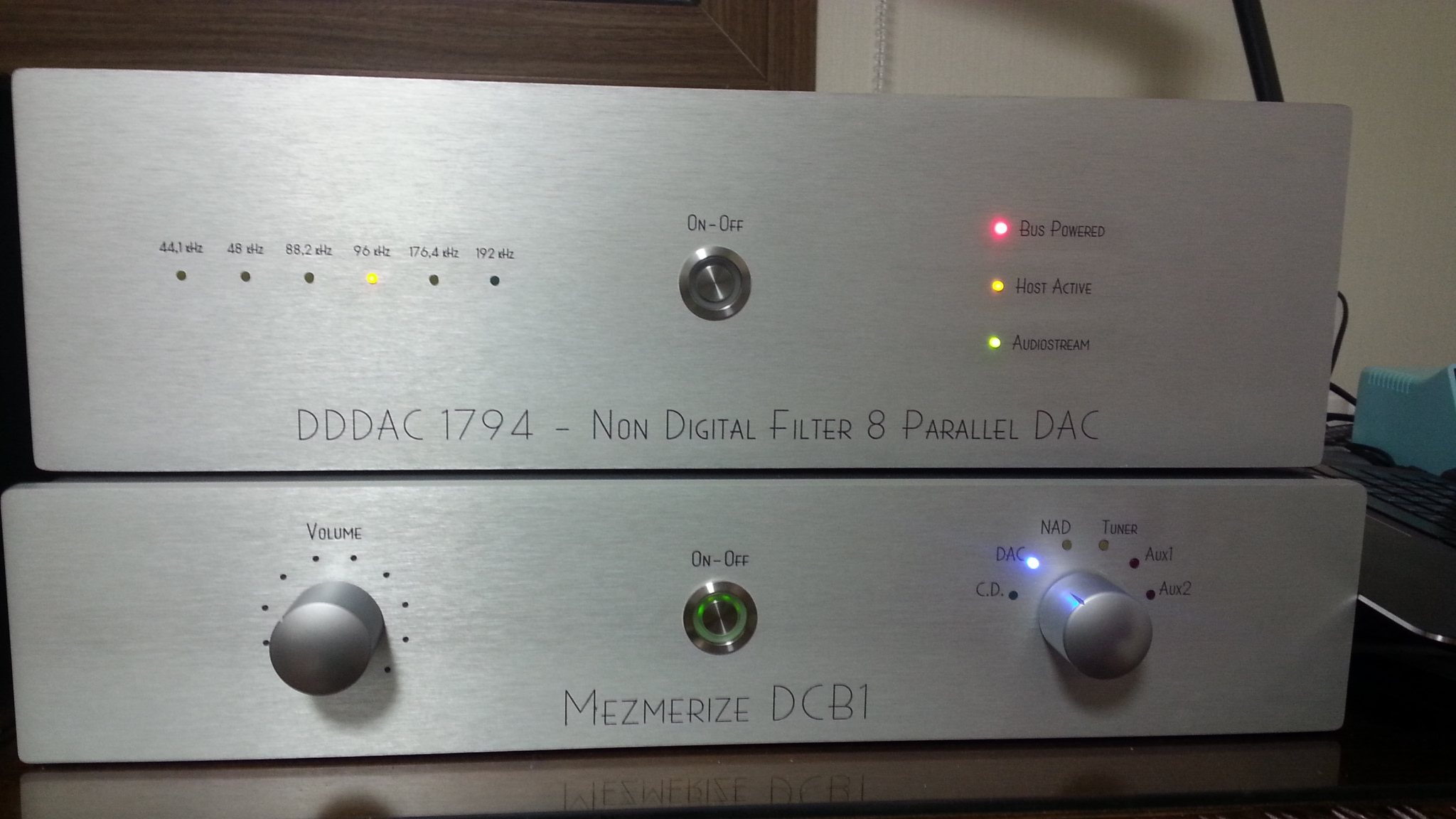

DDDac 1794 and default Apple Mac/iTunes beginners issue.
Why did I write this note:
This is my first DAC and therefor my first contact with setting up Audio output in various operating systems.
On his website, Doede has a good description on how to set up the foobar player for Microsoft Windows.
Nothing was written about default Apple OS X/iTunes setup, (only, that no drivers are required for the WaveIO board, it is supported out of the box), which is true.
My issue:
Connecting the DDDac 1794 system directly to my Symasym or F5 Pass clone amplifiers(without preamp), without playing music,
gave me a low volume high frequency hissing sound from the speaker tweeters (Both JBL E20 and KEF LS50).
I do call this the sound of a leaking bicycle tyre, meaning you must have your ears close to the speaker to hear the sound.
Also on playing music, in the silent parts of the songs, this hissing sound was audible, (again note this is about default Apple OSX/iTunes).
At first I suspected an issue with the WaveIO board so I did order a new one, the hissing was still present when the new WaveIO board arrived and was installed.
Then Doede published a fix for an issue with 8 dec setup and high frequency quantization noise:
http://www.diyaudio.com/forums/digi...-pcm1794-waveio-usb-input-55.html#post3625871
I did try this, but that did not resolve my issue.
When I did ask Doede, if he was familiar with this issue, he responded that he did not know of any one else having this issue,
but he also wrote, "with 192kHz music you should not hear this, the quantization noise then is -120dB in the high frequency".
This line made me rethink:
- First of all, when playing music with the default Apple OS X/iTunes setup, most of the times NO frequency LED was lid on the DDDac motherboard.
- When I unplugged the USB cable and reconnect the USB cable the 48 Khz LED was lid.
I did look in the iTunes setup, but could not find any way to modify the output frequency at all.
So I restarted testing with the Windows 7 and the foobar player,
on power up of the DAC on the Windows system, there was also the audible hiss, but on disconnecting/reconnecting the USB cable the hiss was reduced considerably.
Playing music with the foobar program (and the setup described on the DDDac 1794 website) no hissing noise was heard.
So now I knew, it is possible to play music on my system without the hissing noise,
(and that I should have done this test with the foobar player before ordering a new WaveIO board).
After some googling, I found some notes about an Apple OS X utility called "Audio Midi Setup".
After setting the output frequency to 192 KHz for the "Luckit USB 2.0 Audio Out" device in the "Audio Midi Setup" utility,
see the attached screenshot (the setup of my system is Dutch), the hissing disappeared.
Playing music with the default Apple iTunes is a real pleasure now.
