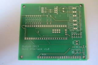

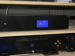

AudioH DDDAC MKII
MKII now finished with improved graphics display, so I can read it from a distance.
I designed a dedicated board for the graphics LCD to take the Teensy+ processor and associated parts. This was my first pcb so really pleased how it turned out.

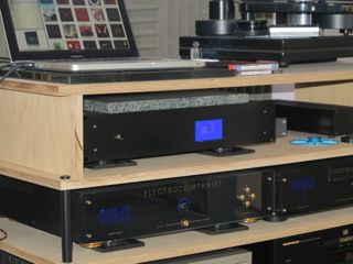

DDDAC parts mounted on an acrylic base isolated from the main case by sorbothane isolators for vibration reduction.

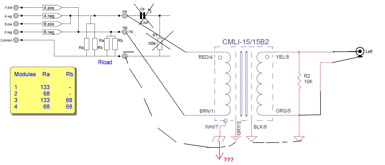

I have two transformers CMLI-15/15B2 (double shielded). I want them to join the DDDAC1794. I enclose a drawing chart. Is that okay? I do not need any capacitor at the output?
as far as I am concerned, there is no real need to connect the White and Black shielding. As I do not know the transformer, I cannot tell if the low frequency cut off will be sufficient, nor if it can handle the voltage Just try it out 🙂 nothing can go wrong and you can compare with the Capacitor Output. Better to disconnect the capacitor or use a selector switch...
Hi jeremysk. That looks good. I am not sure how to connect the white and black wire either. But it will work as you have drawn it. I also have the Cinemags....and will connect them some time this week and will let you know what I did.
As Doede has said: "there is no real need to connect the White and Black shielding". So try connecting all of the ground wires to common.White, Grey and Black.
