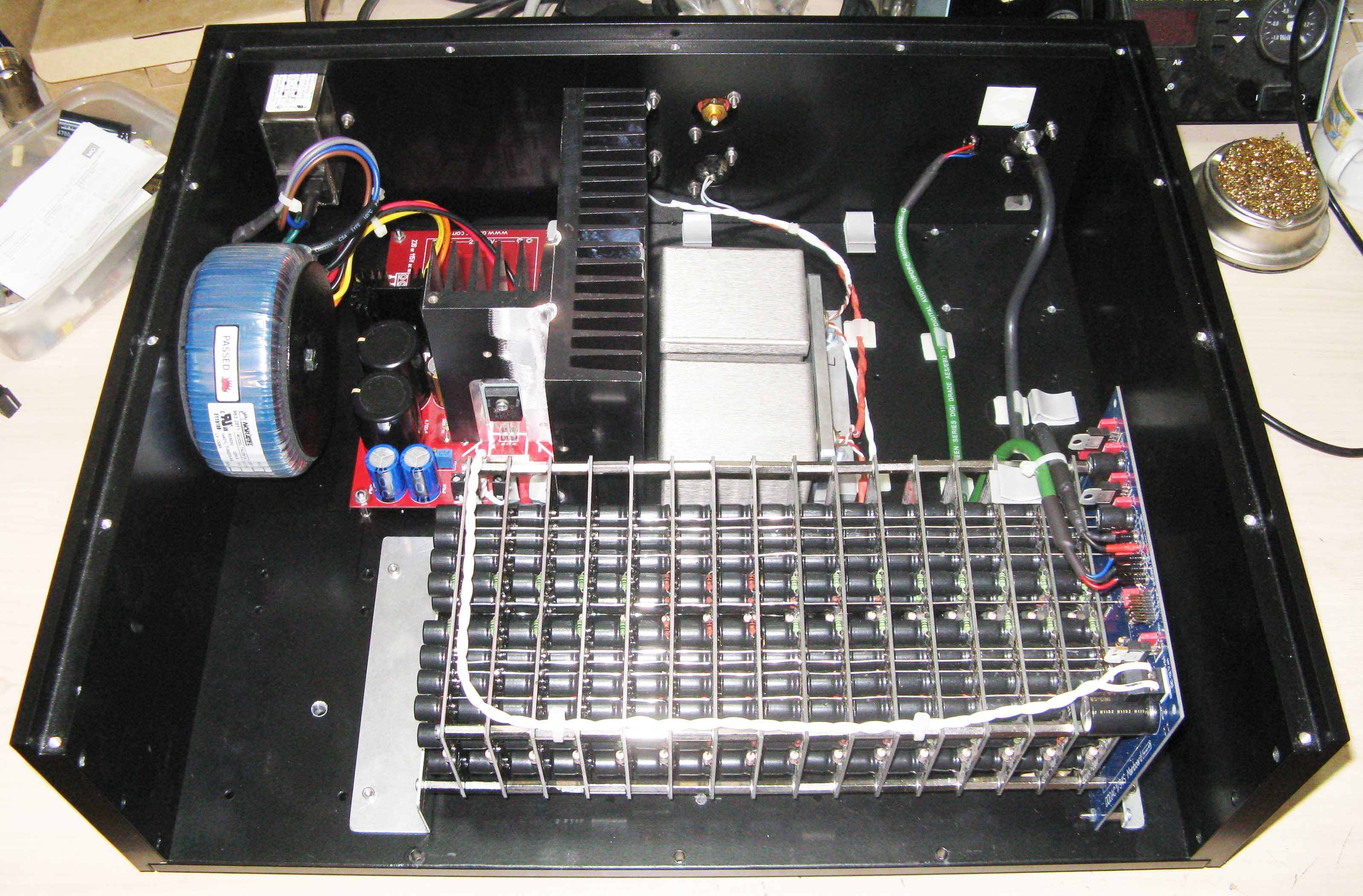

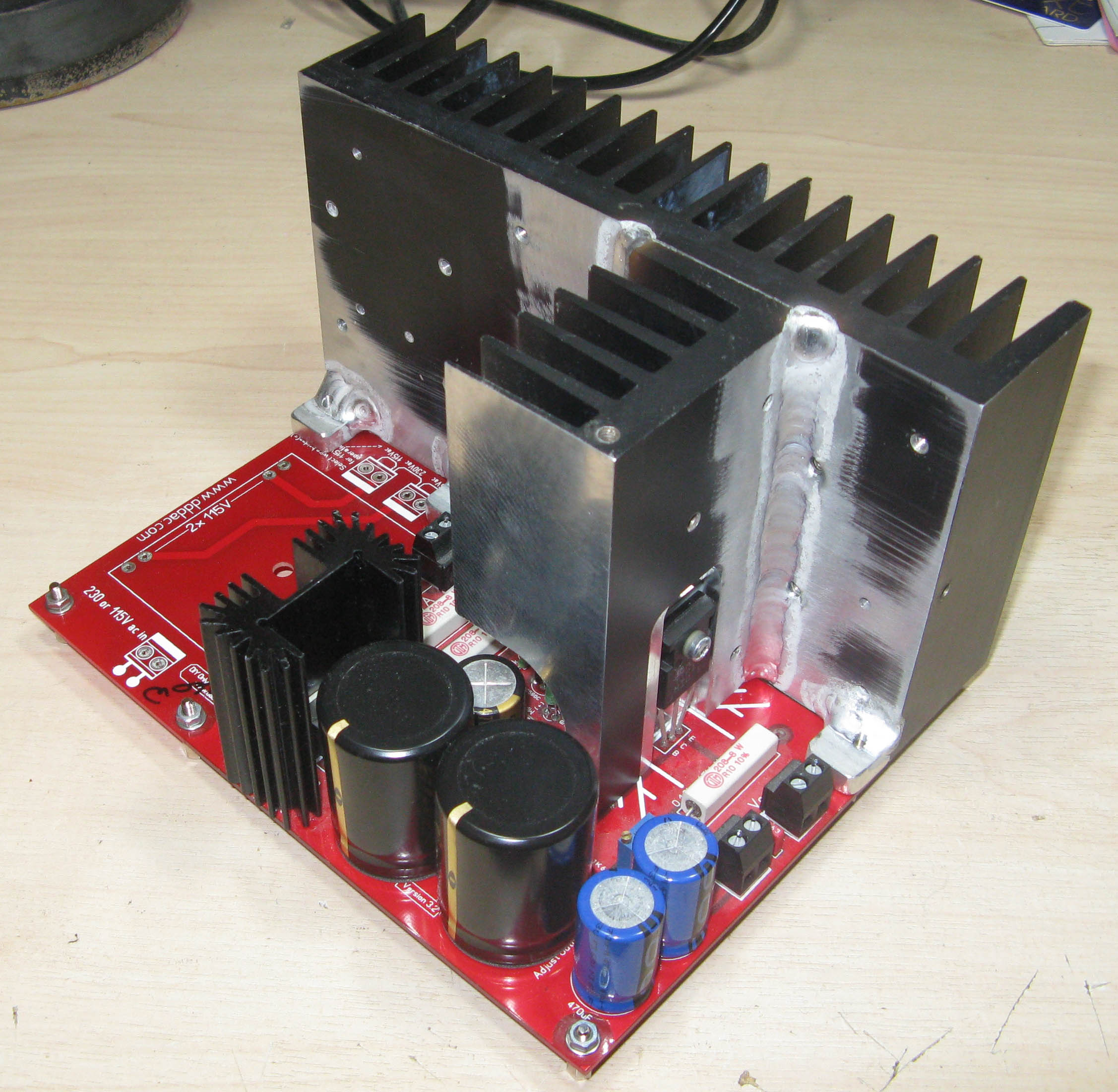

Last night I swapped the TIP122 for the TIP142. It will fit if you squeeze the leads with a pair of pliers to make them square.
Also fitted were 2 off Mundorf 10000uf 40v AG`s instead of the 4700uf and 2 off Vishay 470uf 40v to replace the Nichicon`s.
2A ceramic fuse now used instead of 1a.
I done a quick no load test and all is OK so far.
I will work on the heatsink later, it is BIG ...

All working OK so far .... Now for the bedding in time 1 - 2 months.
The power supply heatsink runs at 35ºC which is fine by me as I leave the Dac on permanently.
Now I know 16 decks work OK, I want to make a double 16 stack one for left, one for right with dual power supplies using Lundhal chokes ... I like to think big 🙂
