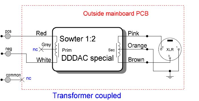

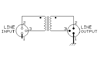

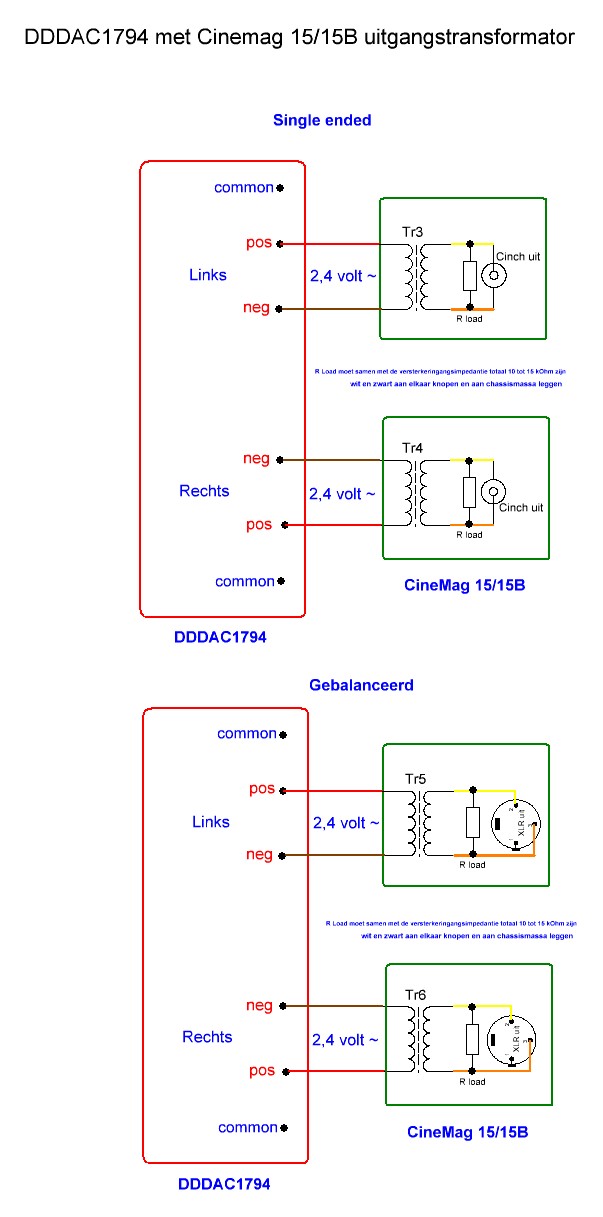

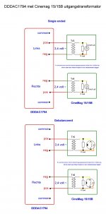

Anyone know if the Cinemags can be connected to give balanced output?
i am not sure if i understand you correctly but using an output transformer you can always have a balanced configuration as shown in the attachment.
Doede @
When not using transformers on output and using balanced xlr, is common still not in use ?
Only connect pin 2+3 and not pin 1 ( ground) ?
Thx
Thx
Correct, you can leave this completely out. On the other hand... If you do it is still ok, but you will bring the 2,7V DC to the next stage
