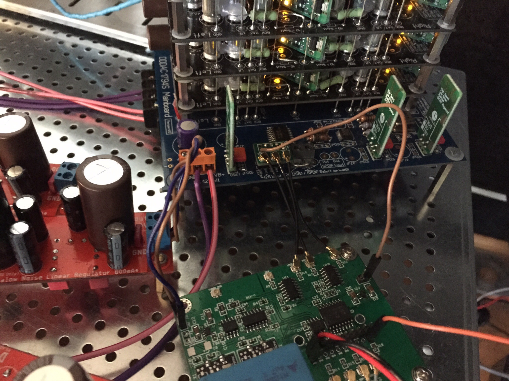

Chan, one word of warning. It looks like you are making the same mistake I did. If you connect the isolated side of the S03 via Uf.l's to the DDDAC and use a seperate regulated 5Vdc supply for it, you will connect the ground of that supply (regulated) to that of the rest of the DDDAC, with the parasitic problems that might cause (sounded worse in my case). I'd recommend you use the 5V pin on the DDDAC I2S header to power the isolated part of the S03. See what you make of it.
Hi Stijn,
Thanks for picking it up. Always great to have second set of eyes!
Note - I have previously used the TentShunt 5Vdc from DDDAC's supplying the clock area on S03. I think Stefan has pick up the high impedance from the long leads. I haven't try using onboard i2s Tent-shunt to supply section of S03 uFL. Will do it today.
It is probably worth mentioning that when I use 3 separate ps to supply S03, i.e i2s TentShunt is no longer part of S03 supply input, sound has open up with more airs/dynamic!

The shields of the Uf.L leads connect the ground plains between devices it makes sense to use the same psu at those respective sides of the isolators, in other words to let the RPI/BBB power the input side of the S03 and to let the DDDAC provide the power for the output side of the S03.
In my case when using the DIYinHK 5V PSU, on the DDDAC facing side of the S03 (using the Uf.L leads), soundstage was noticably less wide with less centre imaging and sound was thinner. To my taste this was detrimental.

Hi, the only thing I can think of is that your 5V shunt on the mainboard is set to provide insufficient current to add the additional load of the output isolator side. Mine was set to supply 80mA.

@Stijn - I think my 5V Shunt is only 60mA and the current demands from S03 at uF.L is 60mA minimal. This could be the possible reason we didn't find ourselves concurred?

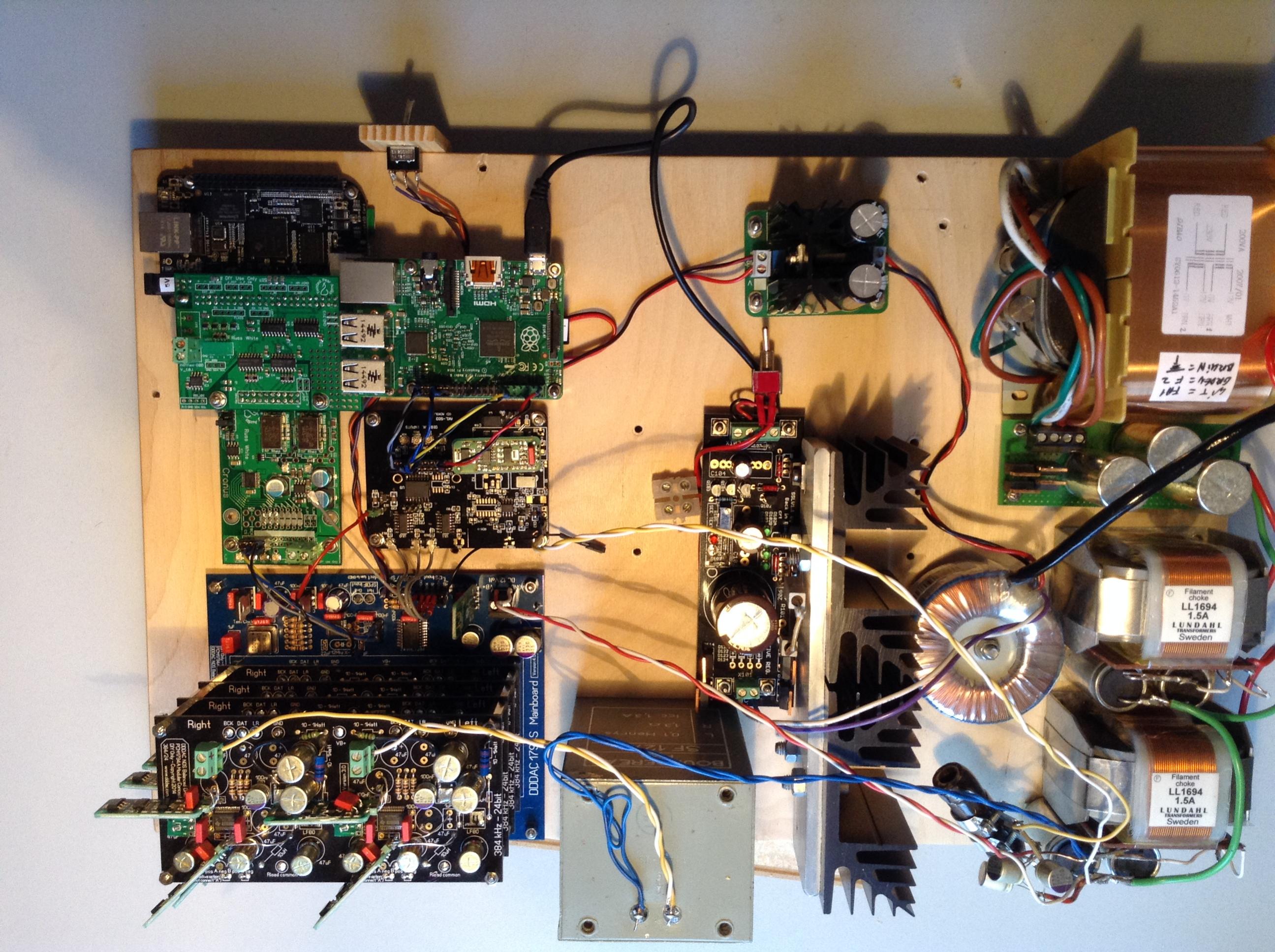

A new source for my favorite DAC
My Dac has two nice sources now:
-RPI2 (running Runeaudio, MPD put in isolated core), Acko S03, asynchronous with 100mhz crystec clock
-BBB (running Botic), Twisted Pear Hermes/Cronus, completely synchronous with 45 and 49mhz crystec clocks
I took out the spdif input (wolfson sounds bad so no real loss 😀) to create a second I2S input. Now with a simple flick of the switch I can compare both streamers.

OK, so here it is:
No need for extended comparisons; BBB-Cronus wins hands down!
Listening to some vocal music (Ben Harper, Ed Sheeran 44,1KHz/16Bit) portrays the differences quite obvious: the BBB is more open, has more resolution, more layers, there is a grey layer taken off the voice.

This makes you think what a waste of time it is to try to get good sound from a PC running DSD files over USB. Without the synchronous clock system of the Cronus there are some bottle necks that compromise the DSD signal significantly.
