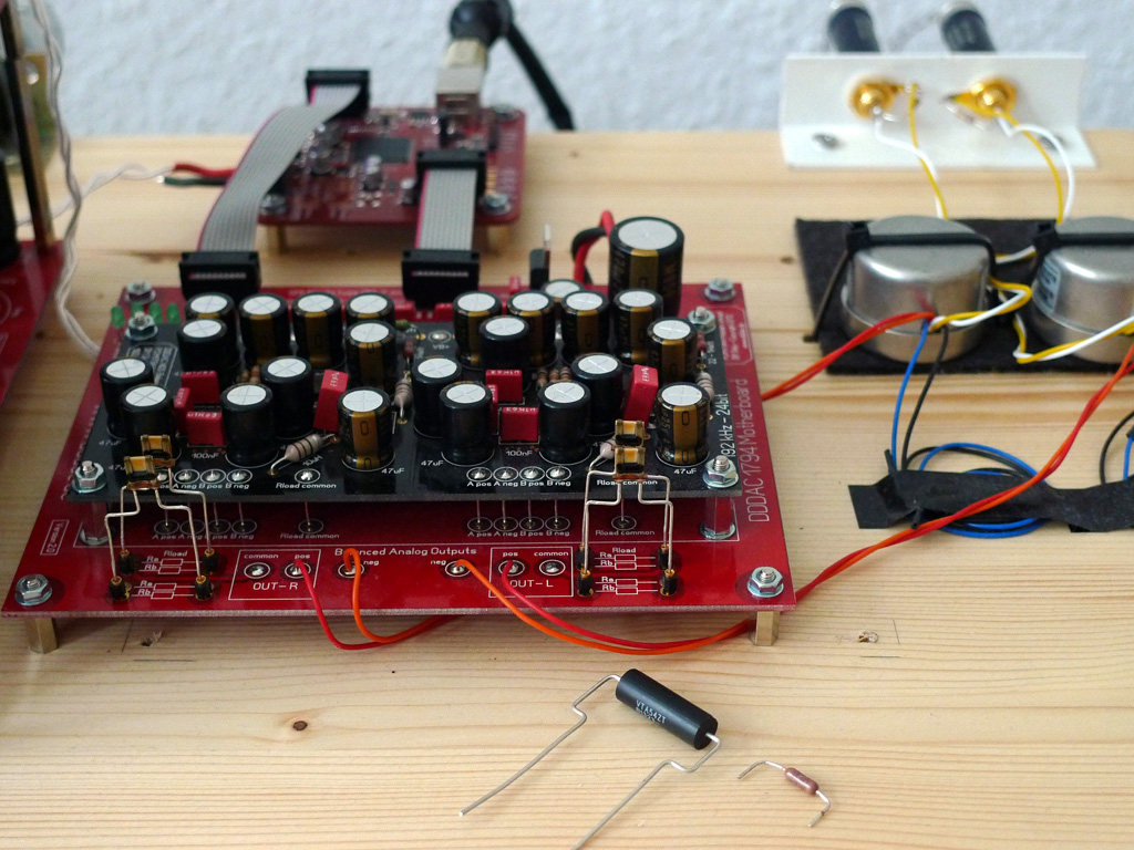

traditionally i am a big friend of the rhopoint wire-wound resistors but the vishay-dale cmf series that comes with the dddac kit is actually a very good resistor for audio application and i am very happy with them in my dac. however, last week i had the chance to test the vishay z foil / bulk metal resistors (vta-54zt and var-t series) and i have to say that they do an excellent job in this application, especially, the "var" type.
the var type is more expensive than the rhopoint but it is definitely worth a try; very detailed and very natural !
anyone else who tried them?
