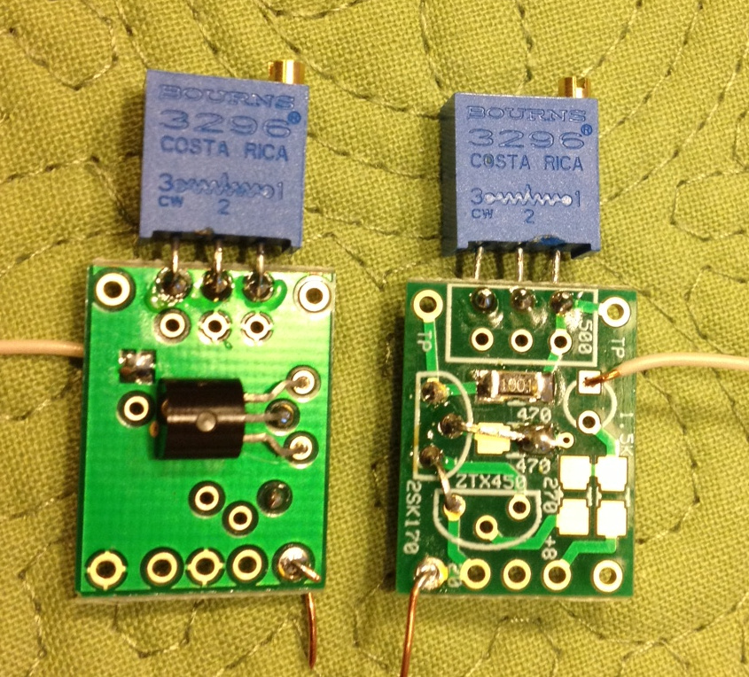

Below is a pic of my 2SK246 CCS boards before I installed them. The white wires go to ground. These boards can accommodate a wide variety of component orientations and board positions depending on the installation. It can also hold components for cascoding, but this seems less necessary now. The picture shows 1k SMD resistors and 2K pots which are the parts I had lying around. I will order 1.5K SMD resistors and 1K pots for my next set of CCS.
