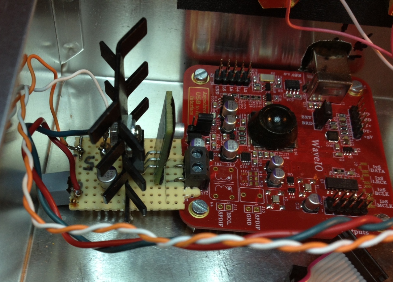

Waveio 5V PS
Chanh - The Salas should be a great choice. I use Salas Shunts on all by analog circuits. When I was in college all I could afford was an all-in-one turntable amp setup that cost about as much as 2 Tent Shunts.

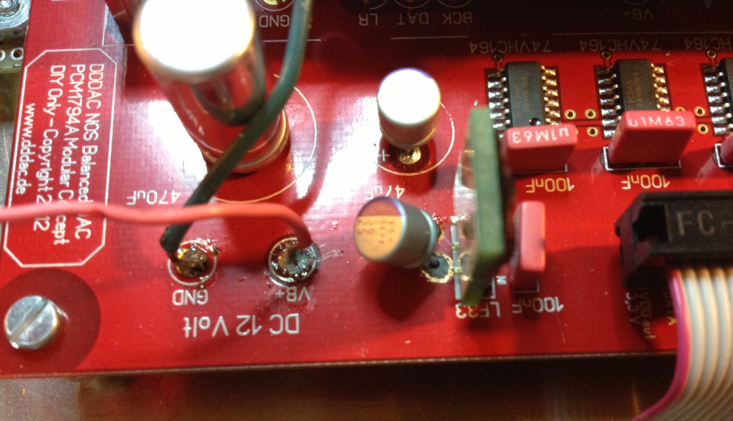

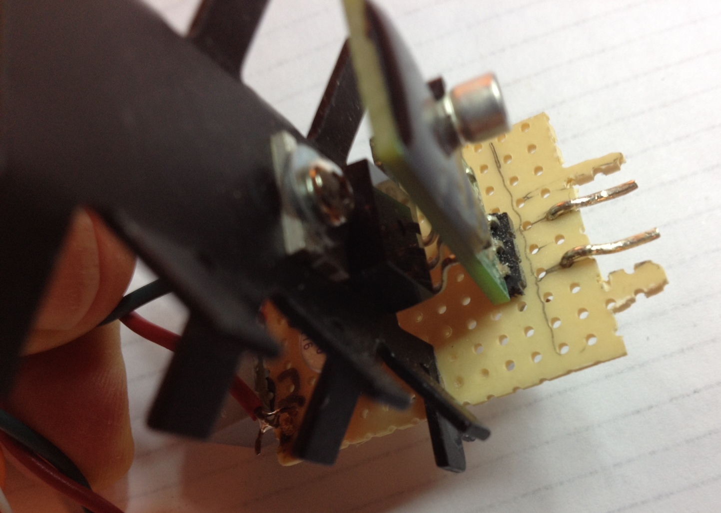

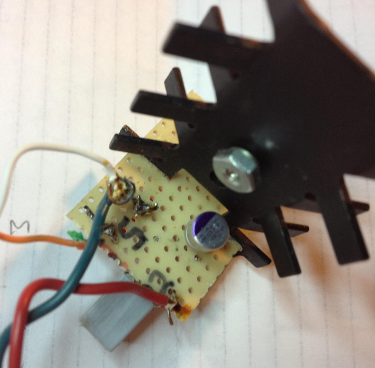

Another option for others to consider is a Belleson 5V SPJ78 right at the external terminals. See pictures. I made a small perf board with a 100uf OSCON and .1uf Vishay 1837 film bypass close to the input pin of the Belleson. It is powered by a 7.5-8.0 V filtered, but not regulated, PS powered by a 6.3V 2amp filament transformer. There was a definite upgrade in sq compared to an external regulated linear PS. I use this same unregulated power supply on my 3.3V Bellesons on the digital side of the PCM1794 circuit.
The disc on the XMOS chip is a Black Discus from Mad Scientist Audio in NZ. To me it makes the music sound a bit cleaner. The difference is small, but I don't want to leave it off. Ok, let's hear all the snake oil comments.
Doede, Please consider making a provision for installing an OSCON and film cap next to the input pin of the 3.3V regulator on the Main Board. I've modified both of my Main Boards this way (see pic, film cap under board) and it allows for the Belleson to operate as suggested on their web site. This might be the difference for a premium Vreg on the Main Board making an improvement in sq.

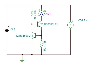

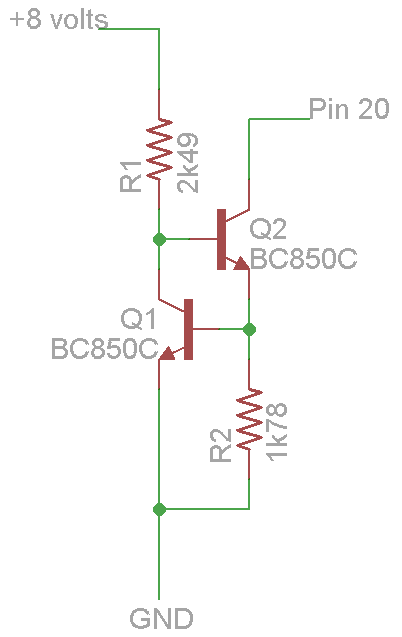

CCS Pin 20
dwjames, Your positive initial results with the LM334 made me order parts to test it along with my two JFET circuits.
I've been using the 2 transistor CCS circuit for a few days now. The musical detail is incredible and the bass is tighter. The overall sound flavor is very neutral with a relaxed musical flow. Very easy to live with.
I'm cooking more FETs on my breadboard to try the single FET CCS circuit again. My first test of this resulted in high musical energy and excitement. The soundstage was holographic. The detail and ambience was magical. It may be altering the music in a way the some may like or not.
Evidently the pin 20 CCS goes to the heart of the analog conversion and every different device used will have a different impact on the sound. I wish someone could contact the designer of the PCM1794 to find out what he had in mind. He chose to go external with the CCS for very good reasons. Someone wrote that the chip designer doesn't work for Burr-Brown or TI anymore.

Carlsor, from your pictures, are you using the four WaveIO mouting holes ? Remember one is grouded...

So for each current source (you need 2 per deck) you will need
1 x LM334M/NOBP (there is an 'SM' version too, but this just has alternative pinouts from the chip and seems to be much more expensive, so we don't want that)
1 x 165R resistor - 1% or better
then to add the extra to remove the current variation for changes in temperature, you should also get
1 x 1N457 diode
1 x 1K65 resistor - 1% or better
You also want to get some SOIC adapter boards. They're only tiny and cheap and readily available on ebay. That just means you have something to mount it all onto.
Let me know if that doesn't make sense.
James
