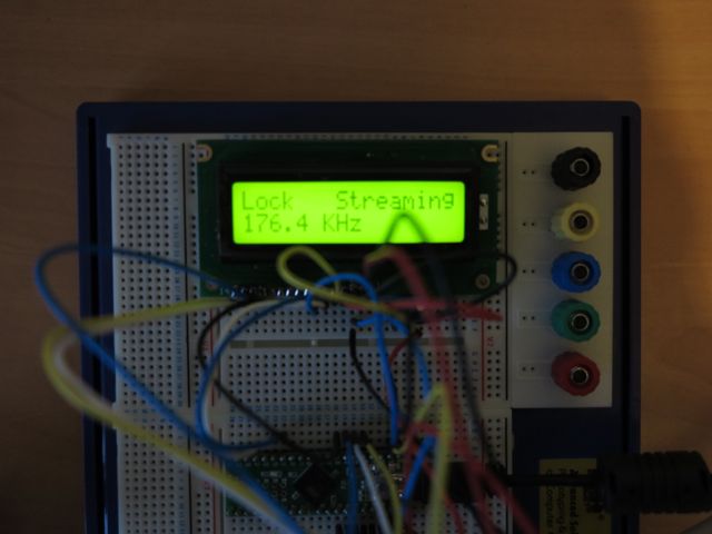

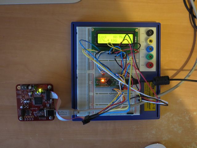

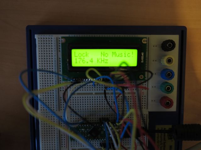

LCD Status Panel
Hi All,
I've mocked up an Arduino equivalent, Tennsy 1++, to the WaveIO to show the current status of Host, Streaming and sample rate rather than LEDS.
Here's a few pics.
Regards
