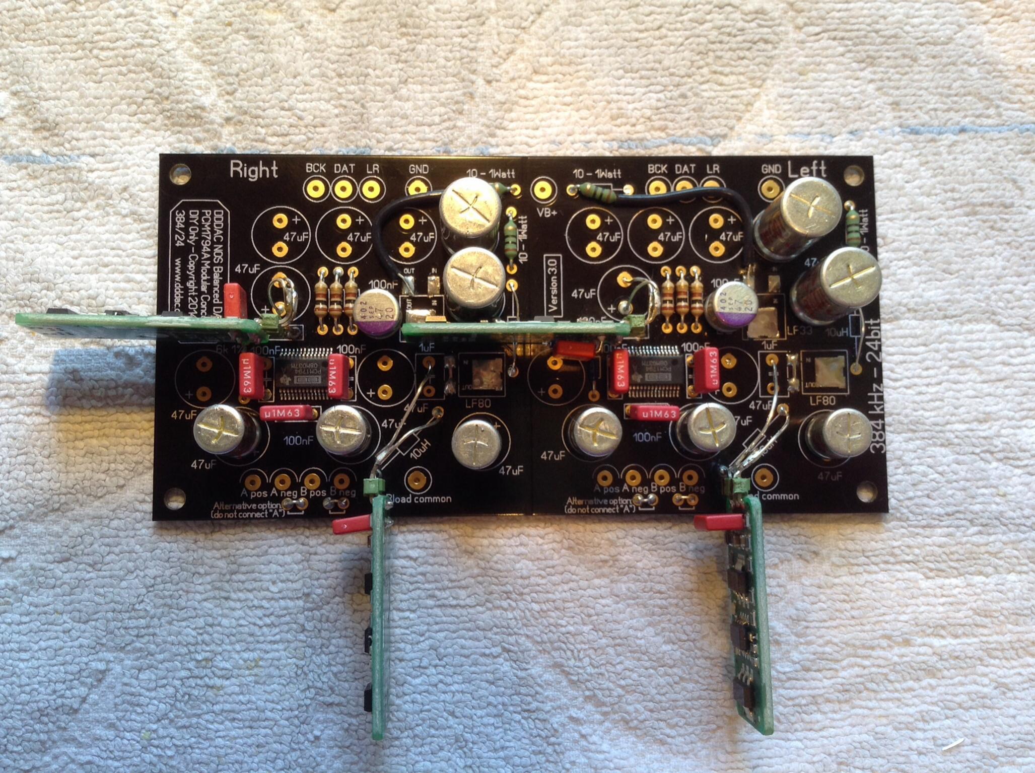

This mod will bring the raw digital supply from the B+ rail to the output pad of the 3.3v regulator.
The large wire is not important; there is extra buffering with oscons behind the wire, so the shunt will effectively see the low impedance of the oscons.
Attached is the layout I will build, shunts not mounted because they are still running in my other dac.
The two holes of R1 and R3 are a good spot to connect the B+ through to the other boards.
You need to cut the traces going to the pin of c28/30 and mount the output of the shunt on this spot. In this way you can solder in some local oscon upstream of the digital shunts.
The green connecters are for putting in analog power, no need to connect ground if you have the grounds from digital and analog connected in the raw power supply.
I will use three silmics of 100uf and after the 10r resistor 47uf; these different values will make a nicer sound balance.
The three wimas on the analog dac pins are needed but I want to experiment with different types because they have a clearly audible effect and need to be tuned for best sound balance.
I am now still waiting for the last parts to arrive (and will be at Pinkpop this weekend) so no soldering this weekend 🙁
Thanks for the picture. Very clever to cut the trace downstream from C28/C30 and to connect ground of the 3V Shunt at the powersupply. That should prevent the risk of groundloops significantly.
Would there be a benefit in using position C2/C7 instead of C4/C10 to keep grounds completely seperated between the 3V and 8V feeds?

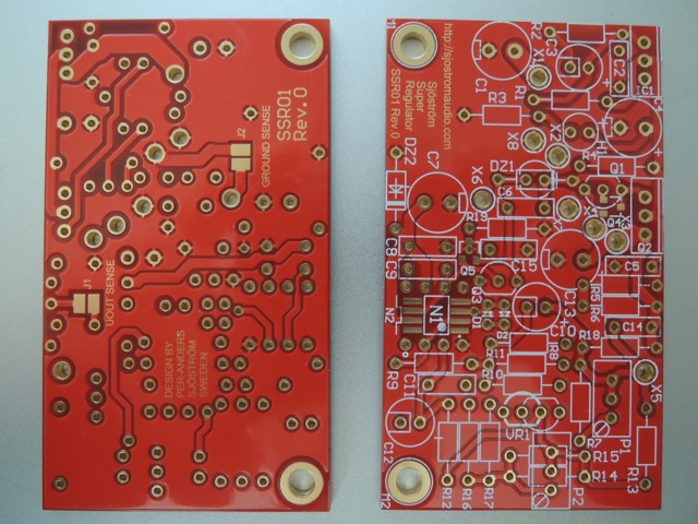

Are these shunt or series regulators?
Neither, they are super regulators as in the work of Walt Jung. LM317 based.

Guess what the mail man brought yesterday?
The new dac boards are playing!
Here is a picture of the way the dac board is build up.
Will post more next week, need to go to my listening chair now.................

That all makes good sense when I see it like that.
Looks like a good plan, certainly nobody's going to get the Digital regulator closer to the DAC chip than that! 🙂
Does the trace to C28/C30 which needs cutting run on the underside of the board?
Is there a reason you didn't use the Rload common to ground the analog regulator? Is it just because it would make the construction of a multi-deck version more difficult?

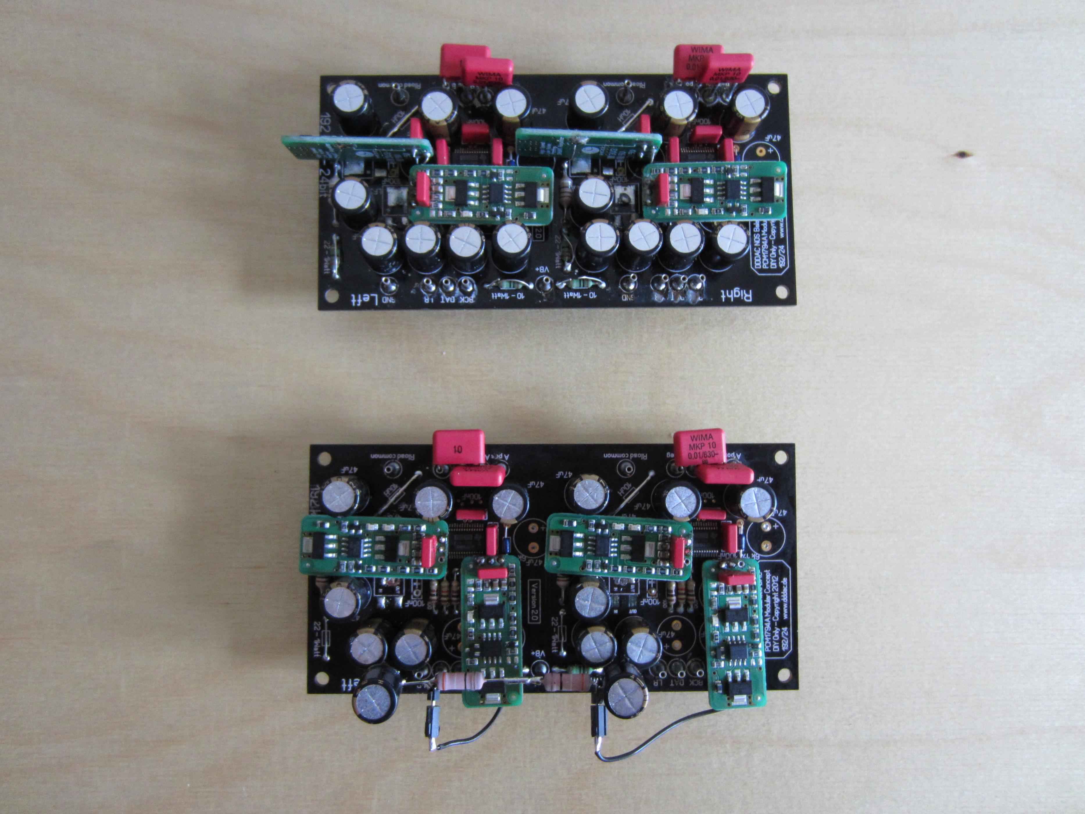

Because this is the first time I am using shunt regs for a DAC and I wasn't sure how important the placement of the shunts really is I did a test now.
I have 4 DAC boards and because I use pcb connectors between the boards it's easy for me to switch between different modifications.
On the first board the output of the 8V shunt reg is soldered to the pads of C18/C20 and the 3.3V shunt to C14/C16. On the second board 8V to C17/C19 and 3.3V to C28/C30. So on the second board the 3.3V shunt reg is 1.5 cm closer to the DAC.
The difference is clearly audible and bigger than I expected. The second board sounds more "direct" and "airy". The separations of instruments is better. Both boards sound good, but if I switch from the first board to the second board everything seems to be more in place and listening more relaxed.
So placing the regs directly at the DAC with no caps seems to be a better solution than the regs at bigger distance and a cap close at the DAC.
In another test I compared a board with Silmic caps to a board with the original Muse caps. I expected the Silmic to be better, but in summary I like the Muses better. The Silmic have better mids, so voices sound nicer and more pronounced. But to me they also sound a bit to soft. The Muse caps give a more kicking bass and more details. Maybe just a matter of taste. Think next I will also test some Panasonic FC and maybe a mix of different caps on one board.

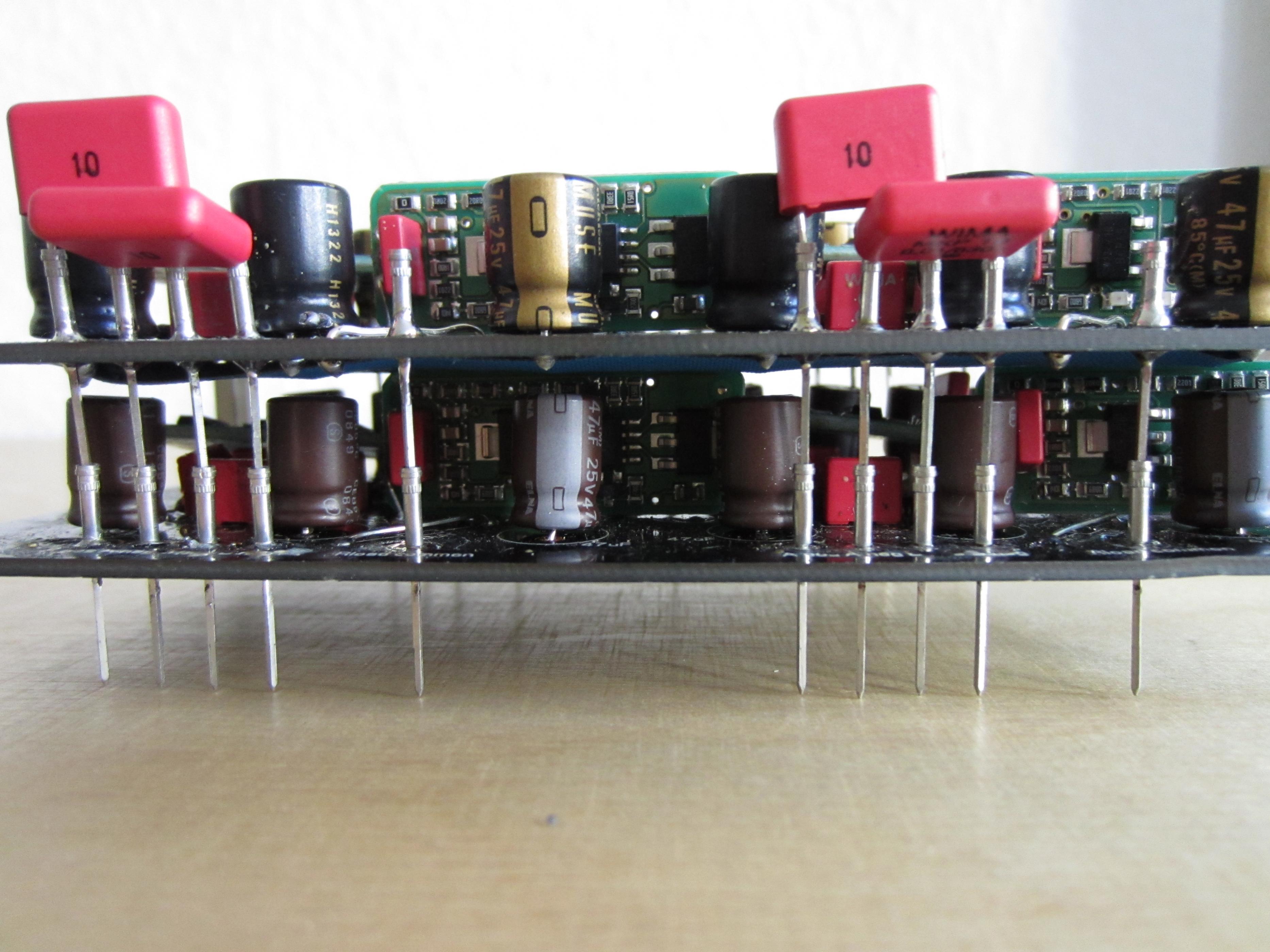

Hi james,
I got them from a local store here in Berlin: SEGOR-electronics GmbH, Berlin
They are normal pinheaders only a bit longer, so that I still can stack the boards above each other.
The pins are still a bit short. OK for testing but probably not for longtime usage. On the picture they don't look straight, but thats a fault of the camera.
Yes I know that, think also Rick McInnis suggested that. It's also on my list for testing. But because of the caps it's not easy to place the shunts there.It seems to me if you wanted to have the 8v Analog regulator as close as physically possible to all 3 VCC DAC pins, the best way would be to run them in the C23/C26 position and maybe run short wires underneath the board to C17/C19 and C31/C33. I can't see another way to have a shorter path.
Sorry, I have no board with the 8V shunts soldered to the pads of the LF80. They have been from the beginning with the output at the pads of C18/C20.BTW, is it easy for you to test how much difference it makes just moving the Digital 3.3v regulator?
