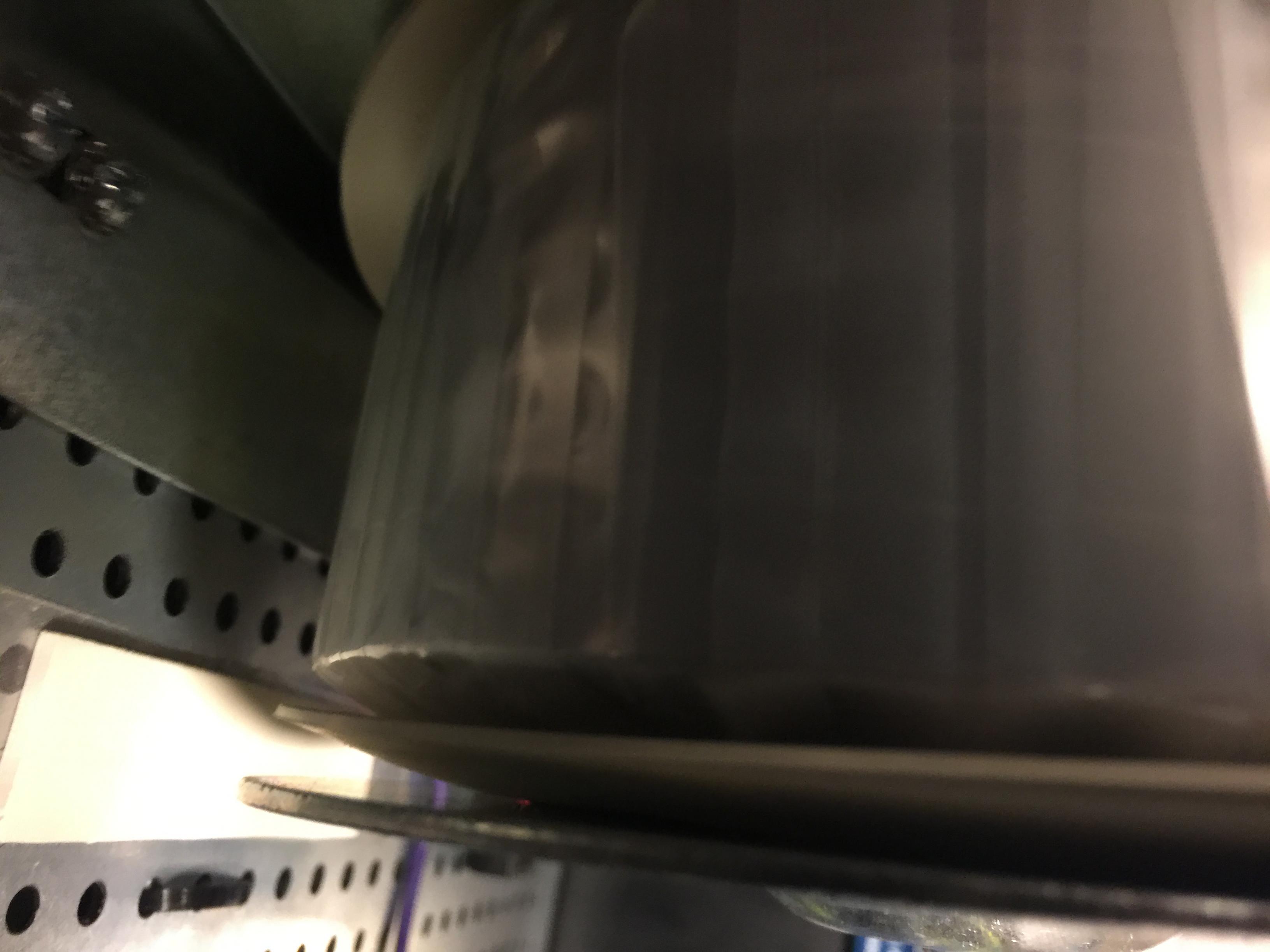

I think I just figured it out. It's not ideal, and I'd like to permanently "prevent" this type of thing, but you nailed it.
It was coming from my bench-top fluorescent work lamp on the same circuit. No lamp - no problem. I turned it on to look inside a bit with the top off - hummmmmmmm.
I have a completely separate circuit for my gear with a big-ol isolation transformer / power conditioner, so I will leave it alone for now. I am now confident that it won't present any issues when I move it to the main rig.
Thank you again for all the support! You've been incredible. I hope to hear more about how your custom IPSs are coming along.
Hip Hip Hooray! You did it!
But 65 degrees C seems way too hot! Perhaps a shorted turn with the toroid mount? Check it for safety!

@poseidonsvoice, @chede / Claas, and @Ozark HiFi Doctor - Thank you!
@poseidonsvoice -
you and @6L6 nailed the issue. I had never heard of this (Clearly I've never mounted a transformer before). I hope this saves some other person from having the same issue. I suppose I can feel a bit good about taking a final look around the inside and checking temperatures before sealing it up... Who am I kidding? I just wanted to play with my new IR temp gun... 😀
Pic of the resulting fix. I lifted the transformer up in the mount, secured it much more tightly with a lock washer and juuuuuust for extra measure cut a piece of rubber to place under the metal top plate.
@poseidonsvoice -

• NOTE – Ensure metal toroid mounts don’t touch base plate. See – “short turn”

Toroid Placement and ensure secondaries are as far away from Edcors as possible.
- Official M2 schematic
- Interesting question about running power supply orientation for symmetrical wiring in 5U. Official M2 schematic
- From the man himself - “Something I have always done on FW amps is to rotate the toroid +/-60 deg in operation, as one position will give minimum noise. Usually there is a lobe of radiation, and pointing it at (or away) from the right spot is a big help.
- Saga of potentially a less than ideal toroid (not the placement) in original M2 thread.
- Transformer orientation if mounted vertically on the front. I was talking to somebody about that quite recently and yes, it does make a difference, and yes, having the wires face front (away from circuitry) seems to be the best orientation. See pictures and posts around #1182
- Transformer mounting bracket. “Bracket is an L-300 from Toroid Corporation. The L-300 is a good fit for the AnTek AS-3218. I have also used the L-625 L-bracket which is a good fit for the Antek AS-4218”
