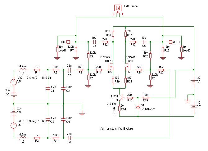

Trying to improve an SACD 1000
I am looking at the D1 design and it looks to be a perfect design to replace the HDAM based analog stuff in that player. What would i need to do to make the design work off of +-12V supplies?

Re: Trying to improve an SACD 1000
The D1 output stage wouldn't run from 12V supplies and cannot easily be changed to work from rails that low. The changes necessary would include changes in topology and/or swapping the FETs with BJTs.

Hi AMT,
I need to see if there is enough room in the SACD 1000 to do this. The player has CS 4397 DACS which put out balanced audio. Would the design tolarete the 2.26V DC offset coming out of the DAC or do i need to decouple with a CAP. Also can one increase the input impedance to say 470K to reduce the size of the cap needed?

Re: Thanks
As far as I know, the CS4397 is a voltage output DAC, whereas the Pass D1 circuit basically is a cascode stage with current input... The good news is you can forget about the supply voltage problem 😉
Penguin said:The player has CS 4397 DACS which put out balanced audio. Would the design tolarete the 2.26V DC offset coming out of the DAC or do i need to decouple with a CAP.

Penguin
At the moment I am building an X-based analog outputstage as attaced for my Onkyo DX706 with SM5861 chip which has a voltage output with a DC offset at 2.4V, almost like yours. I don´t know if I can use the filtered balanced output at C7 and C9 to feed both the + and - inputs at the diff. pair or I have to ground R22 and disconnetct C7. Time will tell.
