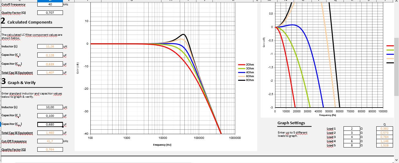

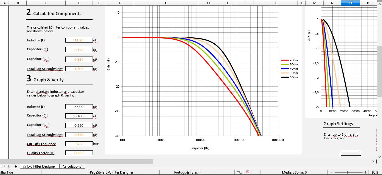

Texas Instrument has given us an excel sheet that do all the heavy calculation, just look at you board and insert the values here, then see what happens, and play with them a bit.
Here's mine stock components calculations:
Interesting to note: Even if these boards should perform poorly with treble at lower impedances, the effects of X7R caps give it a nasty harsh sound.
After some tweaking for my 4ohm speaker:
