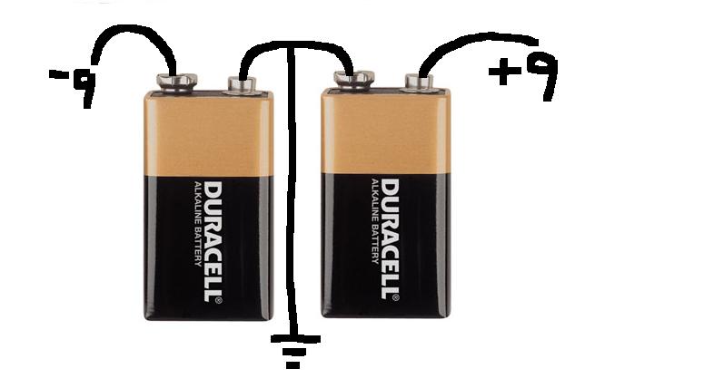

To stay away from the AC mains, may I suggest building this project around a pair of 9V batteries, yielding 9VDC rails? That will eliminate the need for the transformer and diodes. You will need to re-calculate the values for R3 and R4 -- see "table 1" for details.
