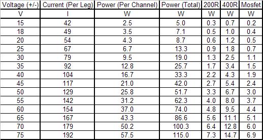

Looking at your graphs, it seems to me that the 35V rails is a good compromise between performance and power consumption. Also because power consumption seems to rise pretty fast with higher rails. I did some quick calculations with the power consumption for four halves - are these correct?
Code:
V (V)	P (W)		I (mA)
18	11.29		66
25	17.71		80
30	23.17		90
35	29.34		100
40	36.23		110
45	43.85		120
50	52.18		130
75	104.65		180
Are you planning to develop the circuit further on 130mA? I'm a bit reluctant to let my DAC dissipate 50W while my power amp idles at 30W...

Hi Lauret,
I've attached a more detailed voltage/current/power chart which you can reference for any info you might need.
I'm going to proceed with both a 50V and a 25V version, but I'll make sure nobody gets left in the dark. The boards I'm doing will end up being overkill for the lower voltages, but that's not the end of the world. You can always buy the shorter version of the board mount heatsinks and save yourself a few dollars. Worst case, your parts will run cooler.
I'm going to make the board capable of going up to 50V rails, and if you buy the tallest heatsinks, you could probably get up to 70V rails as long as your chassis has good ventilation. Either way though, 100W is probably too much to reasonably expect someone to run their DAC at. I'll provide the flexibility, and let the end user decide.
I'll be using these heatsinks:
Digi-Key - HS374-ND (Manufacturer - 529902B02500G)
They come in 1", 1.5", 2" and 2.5" heights, so people can chose which they want based on how high the rails are going to be. The footprint and board stay the same.

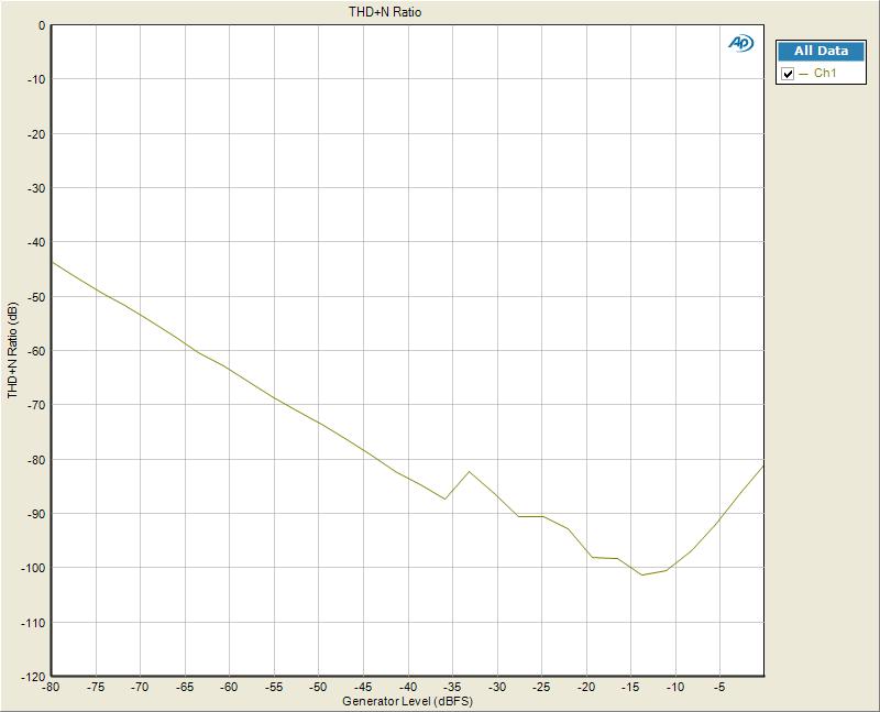

opc
Joined 2004
Hi Spartacus,
Well, I think this should be a lesson in trusting datasheets, especially those with unqualified distortion numbers.
The ESS datasheet does indeed specify -108dB THD+N in voltage mode, but there's not much more data there. I'd ask the following:
- At what output voltage?
- At what frequency?
- With what HF and LF noise filters?
- With what value of resistor?
- With what circuit following the output?

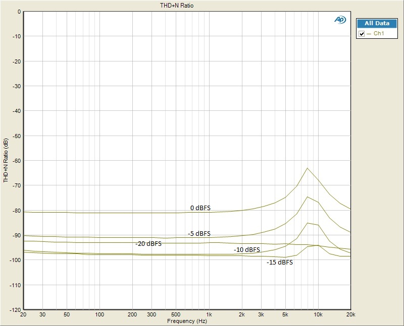

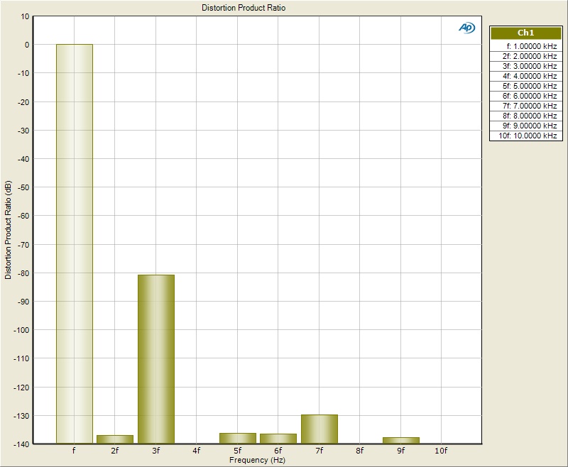

I started with a pair of 200 ohm resistors, but that only gave me 1VRMS output. I ended up with 750 ohm resistors which was giving me 1.75VRMS output. Still not high enough to be a fair comparison to the circuit I'm using.
The following THD+N graphs were measured the exact same way as I've been measuring the circuit I've been working on. Same Buffalo 32 DAC, same channel, 192kHz, 24 bit.
The best I could get was -102dB THD+N but that was only at 1kHz and only at -13 dBFS. At 0 dBFS you're looking at closer to -80dB THD+N best case.
I'm not sure how they got the numbers they did... maybe you need an op-amp buffer, maybe they have an actual circuit that counts as "Voltage Mode" but you're not going to get that kind of performance with just resistors. Worse yet, almost all the distortion is 3rd order, which means there's probably large amounts or second order if you don't run balanced outputs. If anyone out there is using this single-ended with a resistor in voltage mode, then you're probably getting terrible results. This is part of the reason you should never design solely "by ear".
To answer your initial question, the IV stage buys us 30dB better distortion and lower output impedance. That's the point in using it.
Always be wary of THD+N measurements when there's no circuit, no graph, and no other measurement data than a single number.
Owen
