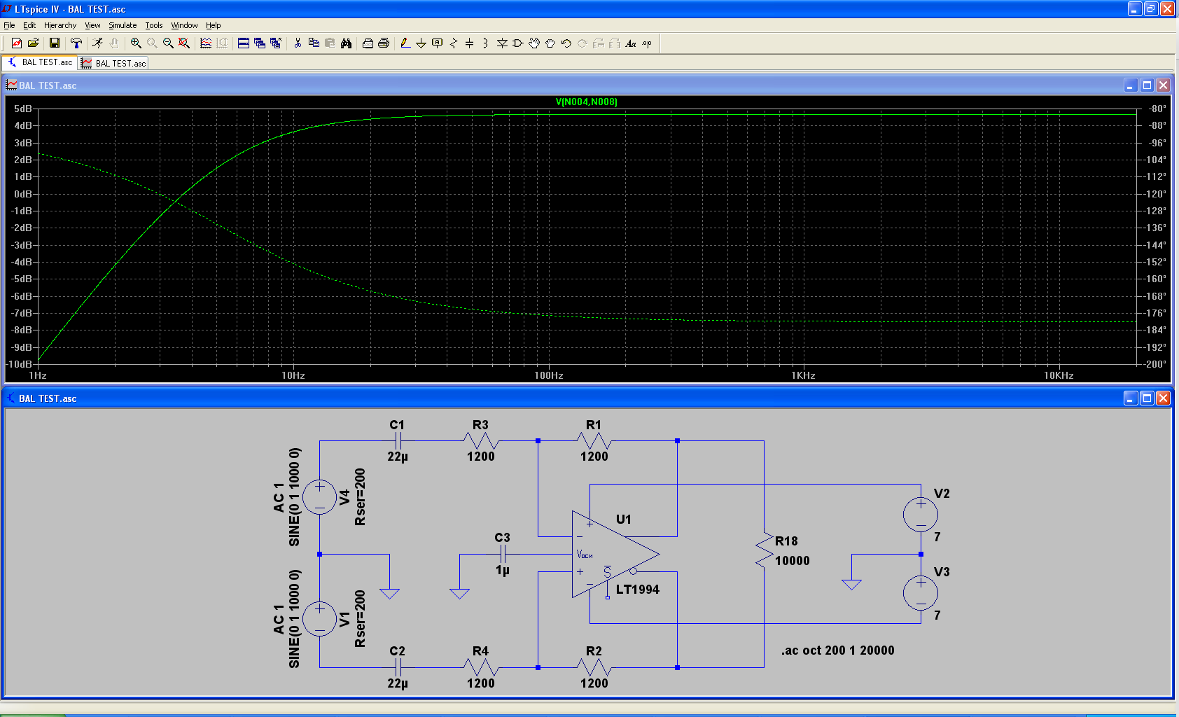

Be very careful with that! The SE-SE and BAL-SE versions come standard with 10k input impedance, but you can push that up as high as you like. The BAL-BAL has a much lower 1k input impedance, and 4.7uF would not be sufficient for that.
The Wire amp also has a rather low 1.2k input impedance if you configure it for balanced mode operation, which I'm assuming you would given it's being used with the NTD1.
If you did use the NTD1 with a 3.3uF cap and ran it directly to the BAL-BAL headphone amp, you'd get a -3dB point of 48Hz which I would consider unacceptable. You can either use a larger cap (closer to 22uF would give you an Fc of 7.5Hz) or you can replace the 4 1k resistors on the BAL-BAL with 10k resistors to get the input impedance up. The penalty for doing that will be slightly higher noise.
Owen
Thanks guys. I do feel bad that I haven't had the time to stay on top of all my projects lately 😱
Anyway, I probably should have stated that the HP amp is the BAL-SE version. Even so, after crunching some numbers (how lazy of me to not do it before) I realize I probably need at least a 6.8uF cap for an Fc of 19.5 Hz. Unless I increase the input resistors in the power amp. So perhaps 10uF isn't such a bad idea if others are ok with that value.
Again, I'm sorry for not doing some (very simple, I might add) calculations before opening my mouth.

I'm certainly not against the use of fancy parts, and as you said, the price really isn't that bad all considered. Even the caps in the BOM are not exactly cheap. What I am against though is people making poor design decisions without really thinking anything through, and potentially spending more for a worse result. It's part of the reason I always caution people when they deviate from the BOM in any way... unless you know what you're doing, and pay close attention to all the details, then there's a good chance things can get worse.
As for the power amp, it's not quite as bad as you're thinking in terms of input impedance. The 600 ohms stated in the amp literature is a "differential" input impedance. It's the impedance across the + and - terminals of the amp. Another way to look at it would be the impedance from each input to GND which is 1.2k.
If you want to stick to the 600 ohm differential impedance, then you'd have to consider the two output caps in parallel and the output impedance of each leg of the NTD1 in parallel. In my mind it's easier to consider each leg of the differential pair separately and use the value as they are.
I have attached a simulation to show what I mean.
As you can see, with a 22uF cap on the output, you're down about 0.28dB at 20Hz and the -3dB point is roughly 7Hz. I consider this more than acceptable for use with loudspeakers (which suffer massive phase and rolloff issues at these frequencies) but I would probably hesitate to recommend that high of an Fc with headphones.
If you're a real stickler for perfectly flat LF response, then a 47uF output cap would be the better choice as it results in an Fc of closer to 2.5Hz and only 0.06dB roll-off at 20Hz.
I personally have been using The Wire power amp in balanced mode with the stock 22uF film caps, and I'm very happy with the result. I might consider a nicer pair of 47uF caps when I finally get around to putting it all in a proper case 🙂
Owen
