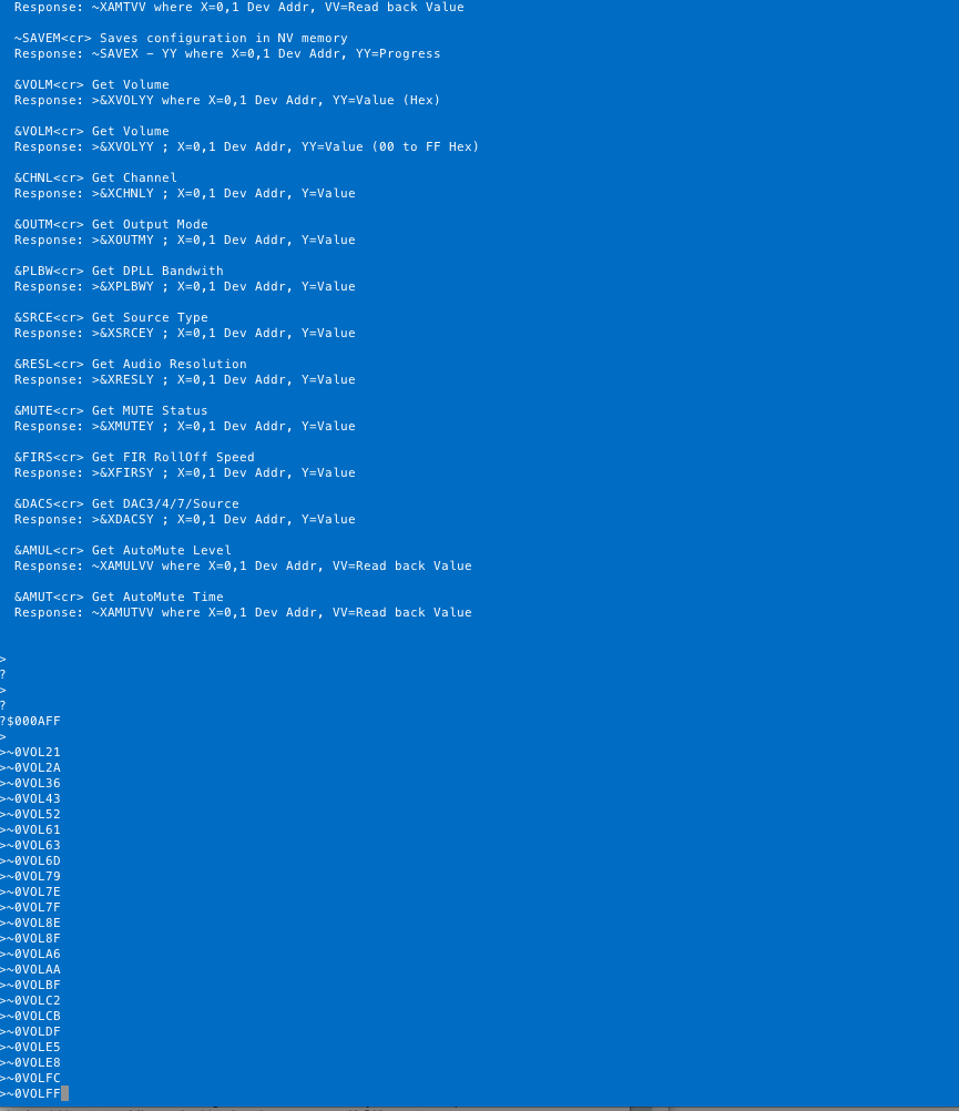

I will use the AKM MCU unit for register setting and volume/input control of the dac (seen on the bottom left of the above pic, with the volume knob on it, its connected to my mac via an RS232->USB adapter and controlled using terminal (snapshot below)), but the display and monitor/control will be based on a network of 1mW xBee wifi modules and a beaglebone.
the ackodac MCU already has RS232 and non volatile memory for saving functions, plus dip switches and rotary controls; which means all functions can be controlled with both tactile controls, or over USB/wifi/ipad but the beaglebone will allow it to be somewhat antonymous without needing to be connected to my Mac the whole time. i'm treating the whole system of dacs and multiple amplifiers as one system under the control of the beaglebone, so that sequenced start up/shutdown, various voltages and temperatures can be monitored and influenced.
