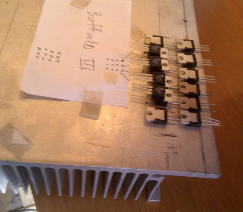

Owen,
Thanks for the spice files and hints.
Yes, I do plan 8 channels off each Buffalo III.
The Buffalo has 4 outputs on each side - so a quick mock-up shows that the longest path from dac to furthest mosfet leg could be as little as 1.5".
I could mount pairs of fets using both sides of the heastsink. And have pairs of t220 resistors right next to its mosfet. The trimpots are probably best mounted on headers. The regs would be on a stripboard nearby - or if I can find a cheap pcb for these that would save some time.
As for the complexity? well one channel at once. and just carry on I suppose...

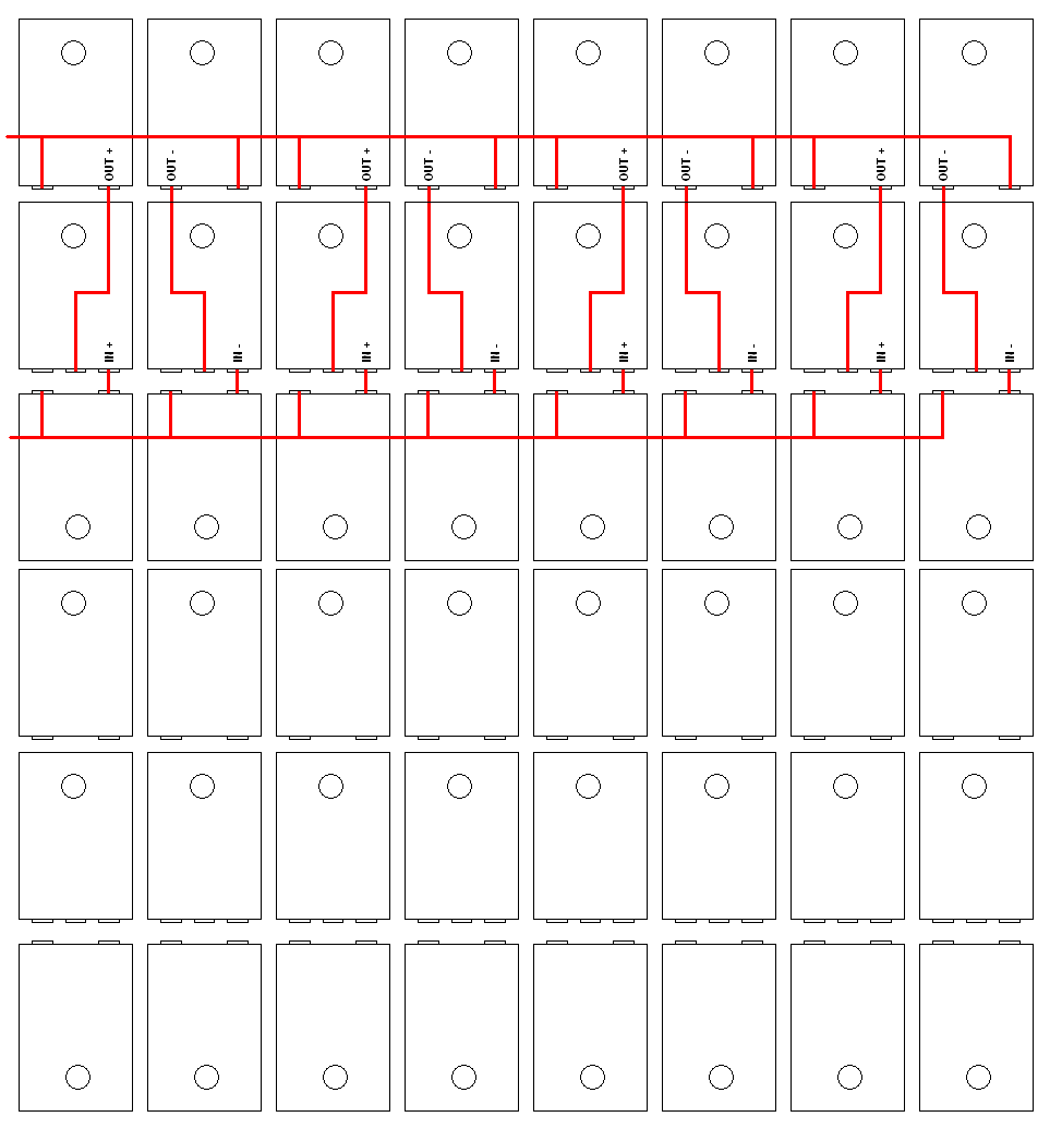

I did a rough layout just for kicks, and it's actually a lot more feasible than I was originally thinking in my head. I've attached an image of what I think the ideal layout would be for 8 channels. You'll have to find a suitable TO-220 mosfet, as well as suitable TO-220 resistors to make it work. the rest is pretty self explanatory, and the BIII would mount just above in the centre, and connect to each channel's input via short wires.
The gate circuitry, along with the output transformers would have to be mounted on a strip of perfboard that connects to each gate (pin bent upwards) and that would be mechanically supported off the heatsink. The voltage busses are easily connected in this arrangement, and the outputs are facing the outside edge for easy access.

Beautiful. And that's just using one side of the heatsink. I'd have to tap the holes to fix the devices - but that could be neat too. I didn't realise that the FQA32N20C wasn't a T220 case. I guess the TO3pn case is unnecessarily big for this version... What FET do you have in mind?
And I'm starting to think about FET matching.. How many would I need to buy to get 16 pairs? Not done this before...
As for heat - maybe I should make the PSU have 2 different voltage settings. +-24 (or less) something for standby/uncritical listening and -+40 (or more) for 'winter heating' mode and the best sound.

wont having all of the fets and resistors placed so very close to each other on the sink totally ruin its dissipation specs?
nah look go at it, i just dont see performance with an untested fet, already higher thd in 8 channel mode and p2p winding up with such great performance. will probably still sound great though
about 50-60 minimum. i did 170 and ended up with about 70 that werent really useable, expect to get lower yield with a smaller number. gm matching is not trivial either. do you have several dmms (only one of which needs to be quite decent) and a signal generator? you also need to take into account die (and thus heatsink and ambient) temperature, as this directly and quite profoundly affects gm

ahh i see, you were talking about your fets on a heatsink as 'above' (which also only seems to illustrate one side of the dac with devices plus other side on paper). i was talking about what was actually directly above my post ie opc's layout, which is for 4 channels, 2 devices per balanced channel remember and the resistors are on there too.
for 16 channels you of course need 32 fets, 64 power resistors, 32 large value film caps
Qusp - I really am referring to Opc's layout too. It IS for 8 channels. Unless I really have gone totally bonkers. Each fet has 2 power resistors. There are 16 fets on his diagram and 32 resistors = 8 channels. I counted.

sorry youre right, i was only talking about the circuit, which is only drawn out for one side, the devices are there, but i was only referring to the actual circuit. sorry for the confusion. for some reason i was just thinking the extras were a step and repeat revainder probably. i wasnt thinking of the others there because if i were you i wouldnt pack both sides all in right next to each other when its not necessary (being on either side of the dac), as that will vastly decrease the efficiency of the heatsink.
