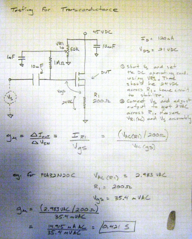

Hi Guys,
I decided to post the transconductance measurement method on here so everyone could use it if need be.
I've attached a drawing that shows the circuit used, and the calculation.
It's not exactly quick, but a good power supply (one that doesn't fluctuate),a good signal generator and three DMM's will make things much easier.
You'll need the following to do this correctly:
1 Lab PSU set to 45VDC
1 Breadboard
1 DMM (two is better, three would be best)
1 Signal Generator set to 1kHz
Hook up the circuit as shown, and hook one DMM across the 200R, one across gate to source, and one from the wiper on the pot to ground. If you only have one DMM, you'll have to keep moving it around.
Set the DC operating point for the fet by disconnecting the signal generator and adjusting VR1 to get 24VDC across R1. At this point, you'll have 120mA Id and 21VDS which is very close to what the fet will see in the actual circuit.
Let it stabilize and adjust as needed to get as close as possible to 21VDC across R1. Measure the voltage at the wiper of the pot, and write it down. This will be your measurement for VDS matching. If you adjust each fet to the same 21VDC across R1, then you know that VDS will be the same, and the DC voltage on the gate (measured from the wiper on the pot and NOT the actual gate) will be the voltage value that gives you the set VDS for that fet. If two fets have the same voltage on the gate to get same VDS, then they are matched.
Once you have the VDS matching done, connect the signal generator through an AC coupling cap and adjust the output to get 3VRMS across R1. Once you have 3VRMS, measure the AC voltage from gate to source (VGS) and write it down.
If you're doing a lot of fets, you'll want a way to number each fet , and then make an Excel spreadsheet that will calculate Gm from the numbers you measure, namely VGS and VR1. You'll also want a quick way to mount each fet to a heatsink. I used a screw and a spring clip with a hunk of aluminum. The 200R resistor will also need a heatsink, and you'll probably want to mount everything on a breadboard to make it easy to swap fets in and out.
With a large enough number of fets, it will be easy to find pairs that have very close VDS values as well as Gm. It took me 2 hours to measure 14 devices and I found four that were very closely matched. I was using 3 Fluke DMM's and all the right lab equipment, which really helped to speed up the process.
As you can see, this whole process is VERY time consuming, and a serious PITA. All these values a temperature dependent, so each fet needs time to reach equilibrium. Please reward qusp accordingly for the time he puts into this. If I were doing it, I'd be charging a pretty penny for each matched pair.
Let me know if there are any questions or issues.
Owen

hmm I dont have an actual tone generator, but I have lots of pro audio software and a RME pro audio card capable of 32/192khz balanced output. shouldnt be hard to produce a 1khz square wave (assuming it should be square) then can use a simple opamp circuit to allow amplification to give 3vac. sound like a plan OPC? or should I search for a used old tone generator?
