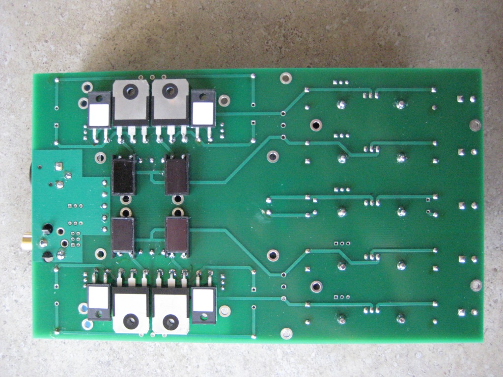

Hi Guys!
Where to start... it has been a very hectic week. My board is finally finished, and I fired it up for the first time this afternoon. It took WAY longer than I was hoping, but it was definitely worth it! I've been at work longer than usual, so I only had a few hours a night to actually work on it. I'm now enjoying a nice glass of Lagavulin 16yr and listening to some great music!
The good news first:
The entire PCB is perfect, and the whole thing sounds absolutely incredible. It's dead quiet, the bottom end is stunning, and it's noticeably better than the very good Analog Devices reference DAC I have as a backup. I really like it, and I'm sure everyone here will too!
The bad news:
I ordered one wrong capacitor (wrong package size, I ordered a 1210 when I needed a 1206) so I'll need to place one more DK order before I ship out boards and kits. Now that everything is up and running, I'll start shipping on Tuesday when the new caps get here. I also completely messed up the zener diodes on the input node of the circuit. I have no idea what I was thinking, but I put them in parallel instead of in series. I guess that's what happens when you add stuff at the last minute without checking it. Right now I'm running without any, but I'll be making a little tee-pee with two series diodes on one of the pads. Anyone wishing to use the protection zeners will have to do the same.
I'll do my best to go back and answer any questions, so here we go:

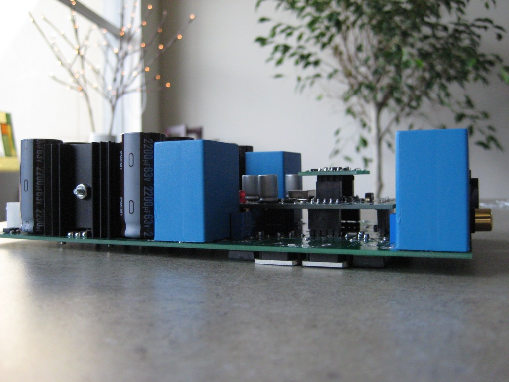

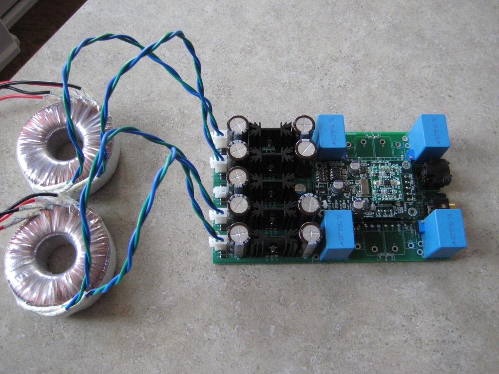

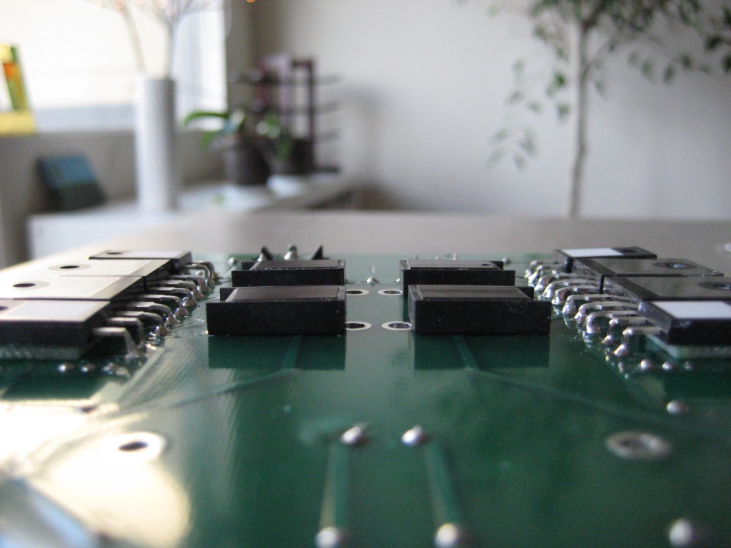

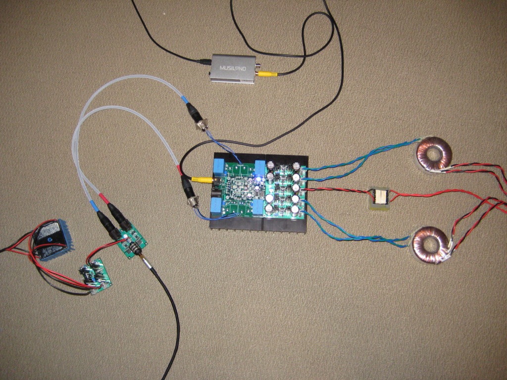

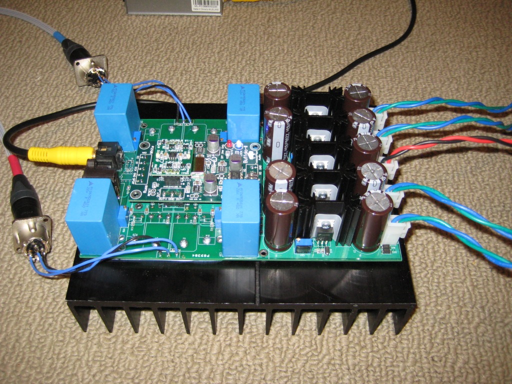

Hi Guys,
I've attached a few pictures from the build...
I'll start a new thread with build tips, and I'll probably re-post these pictures there for reference.
There are a few tips that I picked up along the way, but I'll save those for later.
Enjoy!
Owen

great pics mate, looking good. and good timing, just popped in to mention that those using Zfoils have to keep dissipation in mind as they are not rated as high as the caddocks, but still within range for the 6w position at 10w (the 400R sinks 6W with 50v rails; datasheet says 8W, but my contact assures me 10W), but for this 10w they need good heatsinking like above, either with a separate flat sink, or the bottom of a suitable case.I am making an order with conrad heatsinks, so maybe I can help out here as well. the small board mounted heatsinks probably will not cut it, but as you can see the above setup takes up less room anyway
