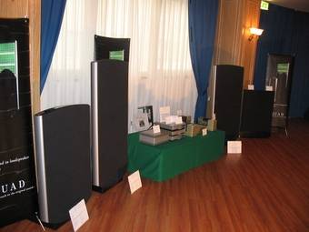

A new Quad ESL??

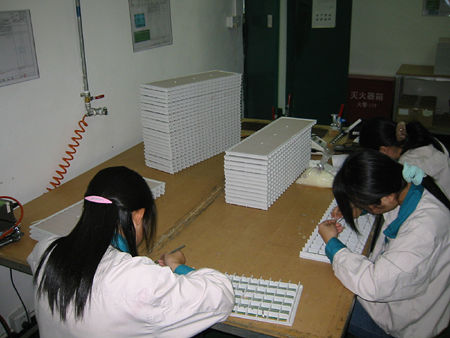

and another one...
The stretching jig that came all the way from Huntingdon to Shenzhen.
If the pictures are up to date, it seems that the "new"
Quad is the same 988/989 under new clothes. (Which itself was esl63 face lifted...)
It is a pitty that after the late Peter Walker passed away, no one can really further develop his masterpieces.
